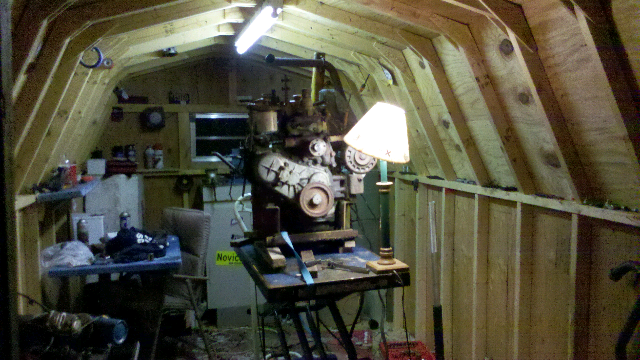

So i pulled the motor and brought it inside to pull it apart

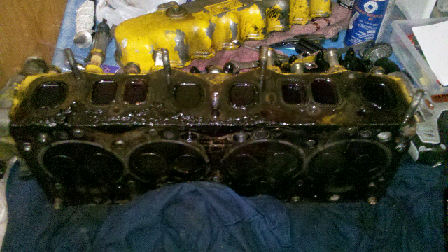

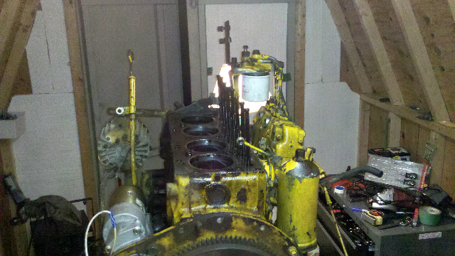

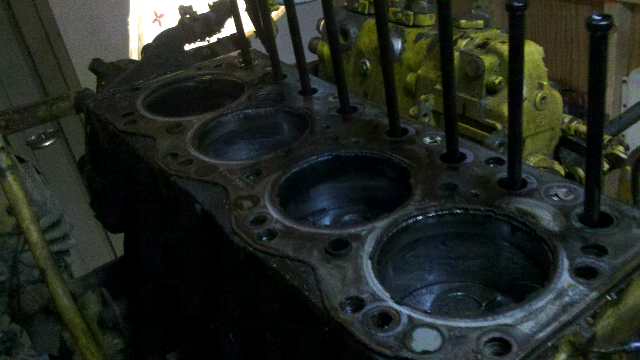

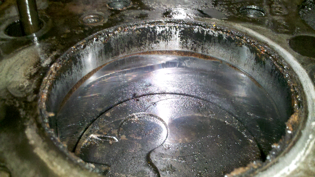

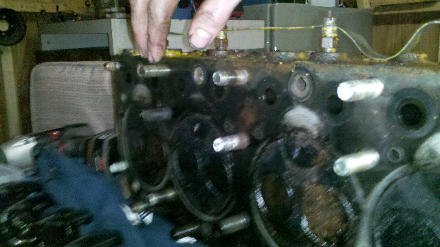

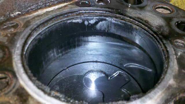

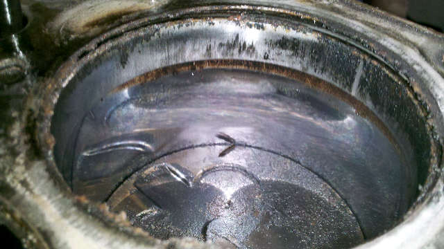

ForumRunner_20120128_000535.png Well i laid in bed tonight and couldnt sleep so i went out and tore down.

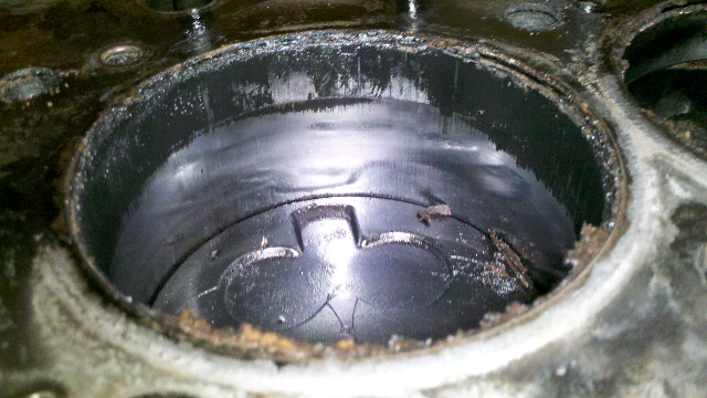

The cylinders have some build up on the walls.
Alot of junk fell on top of the pistons when i pulled the gasket off
The intake and exhaust valves are a definitely a big problem with the starting. #1 the ports are all junked up. i honestly think i pulled out a mouse carcass out of one of the intake ports. turned it on its side and filled the ports with marvel mystery oil to loosen up more of the junk on the port walls. #2 the oil started coming through the valves as if they are not seating right. Not all of them i think 3.

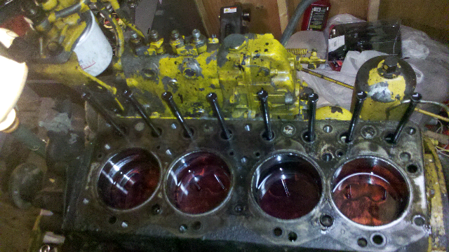

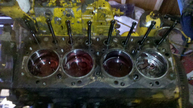

#39
I put about a 1/4 inch of the mystery oil in each cylinder to see if the oil is gone by the morning on any of them. I donk know iff it should be or not? But I'm sure it will be.
The valves may explain the no start but i was still getting smoke from the crank case. Ive been told if i can get it to fire and build heat the rings should unstuck and be fine.
I want to avoid pulling the pistons unless im sure i have to. Even if i had a compression tester it would have read low compression with the valves not seating. i guess i can take care of the valves and get your guys input on where to go from there.
i checked the glow plugs again and all 4 work i must have not had a good connection when i tested them before
Another question what can i use to scrub the cylinder walls?

Went out this morning and this is what I found.
They all seemed to be at the same level with oil except for cylinder 4. It was empty..
The oil in the intake and exhaust ports on the head never dropped. I'm going to get a valve spring tool hopefully Monday and take the valves out and clean the head up.
