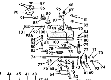

I replaced the o-rings on the throttle shaft and fuel stop shaft because of a leak I put cover back on I bleed the bleeder hole I get a good stream no air, tighten nut.no fuel is coming out of the 3 lines am I not bleeding it properly? I'm sure I got the fuel stop pin in the hooked bar when I put the top back on I loosened the lines but no fuel. It worked before I removed the top.I have the two filter setup,a friend told me to fill up the filters with diesel fuel because I changed them, that mite help are there any bleeders on the top housing
G'day I would recheck that you have got the stop linkage under the cover correct, if it was working ok before then there is no reason for it not to be working now unless you have not got something right. They can be difficult to get them back in the right spot some times.

Thanks, From looking at the pic would I be correct in thinking that with part 1A not tight part 8 did not work?
   / injection pump questions #14
Y
Tx Jim,
Yes you are correct.

Hi Dave I changed my fuel filters and replaced the o-rings in the fuel injector cap on the throttle shaft and fuel shut off shaft I replaced cover making sure I lined up the hooked arm with the pin on the shut off.I bleed the filters at both lines,outer line goes to the rear of the pump I guess that is the feed ,the inner line goes to the side of the pump,I believe this is a return line that gets re filtered ,then I bleed the side of the pump that little bleeder I know the pump is full because if I loosen the little acorn nuts on the cap it will leak fuel so it is filled up to the top of the cap I get nothing coming out of the 3 lines no matter how long I turn engine over, every thing worked great before I fixed the shaft leak what am I doing wrong? also on the low pressure return line one side goes up to the fuel tank via some kind of small canister that also has a line from the exhaust manifold then vents into the top of fuel tank the other end goes back to the fuel injector. does the fuel from the return line some how make it back to the line on the front that returns to the filters without contact with the fresh fuel?
   / injection pump questions #17
I'm not Dave but I'll bet you didn't get linkage under IP cover attached back the way it was originally therefore fuel isn't getting turned on inside IP.
   / injection pump questions #18
Eagle
I sure seems like the fuel shut off is still in the off position and as Jim says you have not put something back in the correct position.

Does your injection pump look in any way like the one below?
If it does then the first step in the bleeding is to slightly open the bolt identified with the yellow arrow and if you have a mechanical lift pump that has a lever on it, work the lever to deliver fuel to the injection pump until it is coming out the loosened bolt.

I read one post on another forum where the cause of the problem was in the cable pulling the fuel shut off not returning the pump to the run position.
Dave M7040
   / injection pump questions #20
According to parts catalog Ford 4500 has a rotary CAV IP. I'll bet something under cover on these linkages is attached incorrectly. Is kill cable linkage in correct position?
