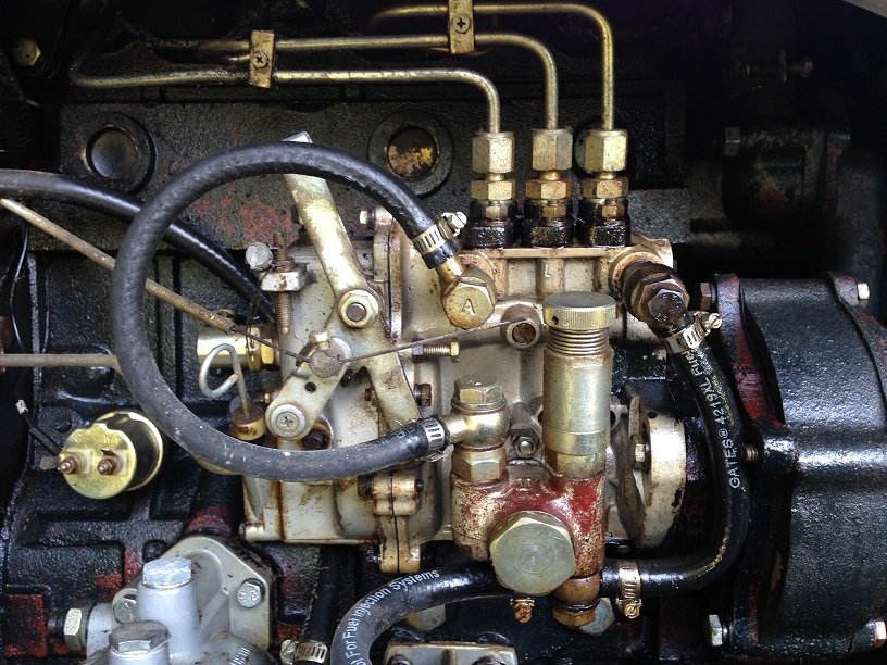

Hello all,
I have been getting my KAMA 454 ready for winter. I changed the gear oil in the axels and tranny, Changed the engine oil. Filled the fuel tank. Then the bad news came when I pulled the dip stick for the injector pump! Diesel shot out of the dipstick hole. I mean it just flows out like a fountain 1 inch high. It stops when I put the dipstick back in.
The fuel tank is fuller than I normally keep it, so fuel lever is a lot higher than the injector pump.
I checked the engine oil and it's right at the full line, so does not look like its going there. Or much yet.
Left side is the oil side.
Questions;
Can diesel be dumped in to the engine oil?
Is there a seal that separates the injector oil tank from the fuel that can be replaced??
Anyone do a seal repair?
   / Injector pump leaking diesel into the pumps oil tank #2
That's a pretty weird setup you have there. The fuel return is going back into the lift pump instead of the top of the fuel tank - who did that? But to answer your question, there are no seals between the barrel and plunger assemblies and the oil sump. The sealing is done by lap-fitted barrel and plungers. Having a small amount of fuel in the oil sump is normal, that's why it's changed frequently. But to have that much fuel indicates you have badly worn assemblies, or you aren't checking it frequently enough (should be a daily thing, just like engine oil).
If you drain the sump does fuel continue to flow out? Also, I don't see a secondary fuel filter anywhere, got one?

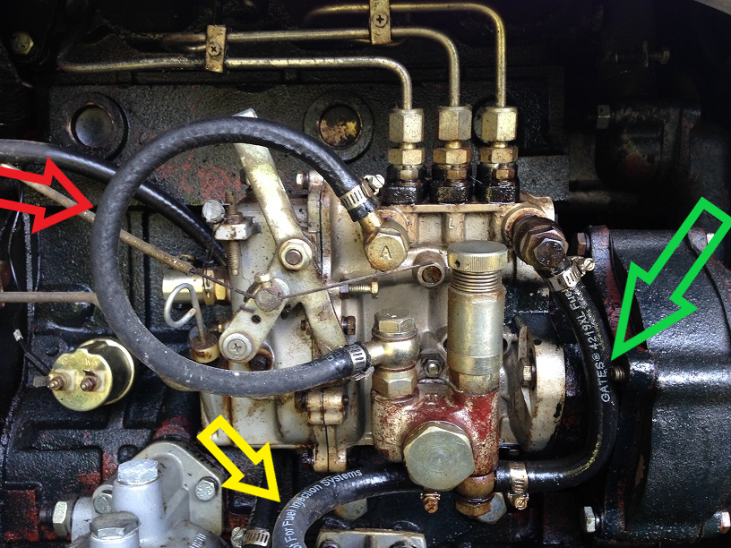

good suggestions. Is the return line shown by the Red arrow? Is the lift pump where the primer pump is? Or on the left side?
what line would the electric pump be added?
Regards to bleeding, there is a hex nut on top that works fine with the hand primer.

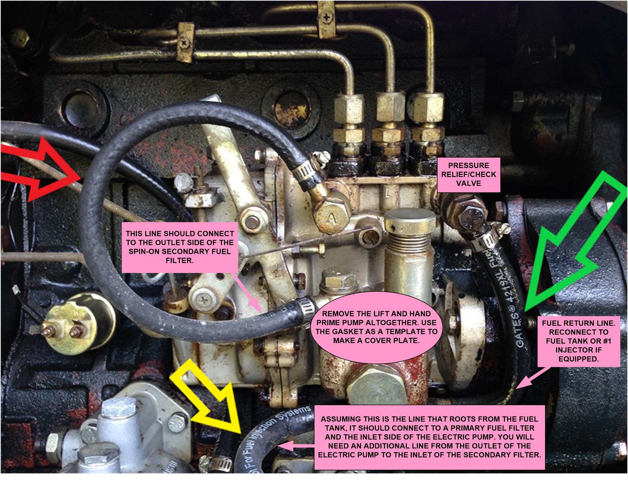

You can connect the electric pump to the key switch.
Note: These are not unit injectors, so there isn't circulating fuel. The fuel returned from the injectors could be measured in droplets. And with the electric pump pressure set at around 5-7 psi it will be more than adequate to keep the fuel cavity full without opening the pressure relief valve. You'll be good to go.

Your bottom most note; that line comes from my spin on fuel filter. So it looks like I connect the yellow hose to the intake of the electric pump then goes to secondary filter. Then connect the outlet of the 2nd filter to red line. Green line gets moved to discharge back to tank, (all injectors are "daisy chained back to tank so just "tee" on)
Remove hand primer completely. What will the new plate retain, oil or fuel?
The electric pump will provide prime pressure when bleeding.
Oil tank on injection pump to get engine oil. Will the oil still get diluted by diesel? Or the fix above stop this?
   / Injector pump leaking diesel into the pumps oil tank #9
Bob,
Thanks again for all your help.
Your bottom most note; that line comes from my spin on fuel filter. So it looks like I connect the yellow hose to the intake of the electric pump then goes to secondary filter. Yes, if you want to add another spin-on filter for the secondary filter. This point gets the finest particles. Your fuel can never be too clean or dry (moisture free).
Then connect the outlet of the 2nd filter to red line. Correct. Green line gets moved to discharge back to tank, (all injectors are "daisy chained back to tank so just "tee" on) Correct.
Remove hand primer completely. Yes. Will the new plate retain, oil or fuel? Just the oil. The fuel cavity is up where the barrel and plunger assemblies are.
The electric pump will provide prime pressure when bleeding? Yes. More than adequate. Oil tank on injection pump to get engine oil. Will the oil still get diluted by diesel? No. This removes the source of fuel dilution. Or the fix above stop this? Yep.
