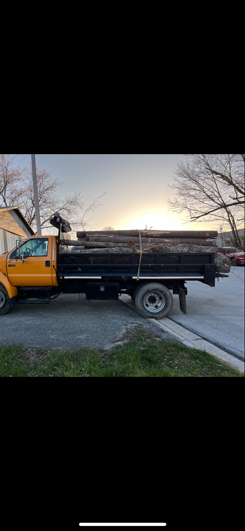

My L3800 can load my 750 with short sides. A 5500 truck with 19.5 tires will be quite a bit shorter.
Found the quote button… that was my thought but I suppose a tape measure would settle that.
