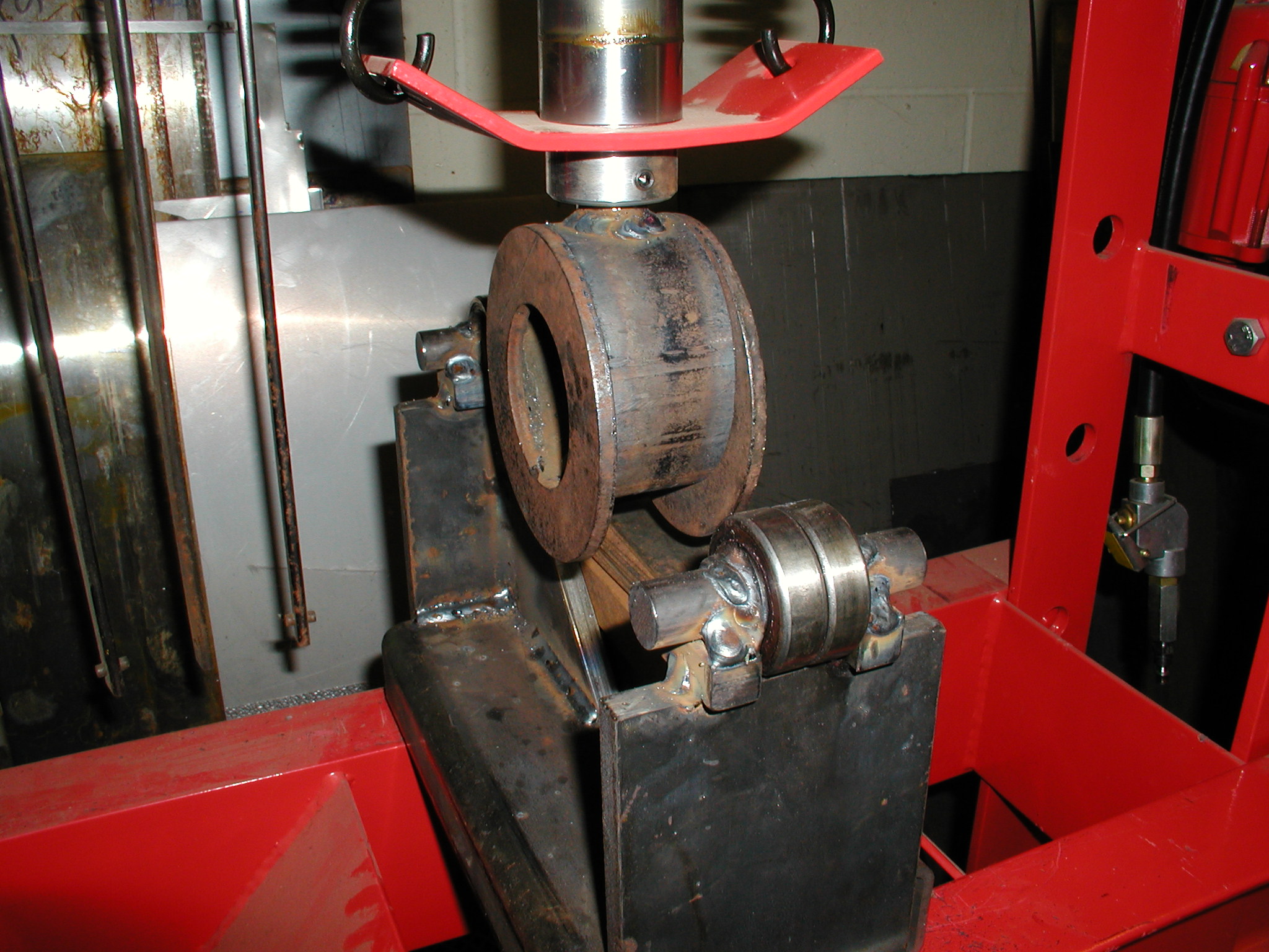

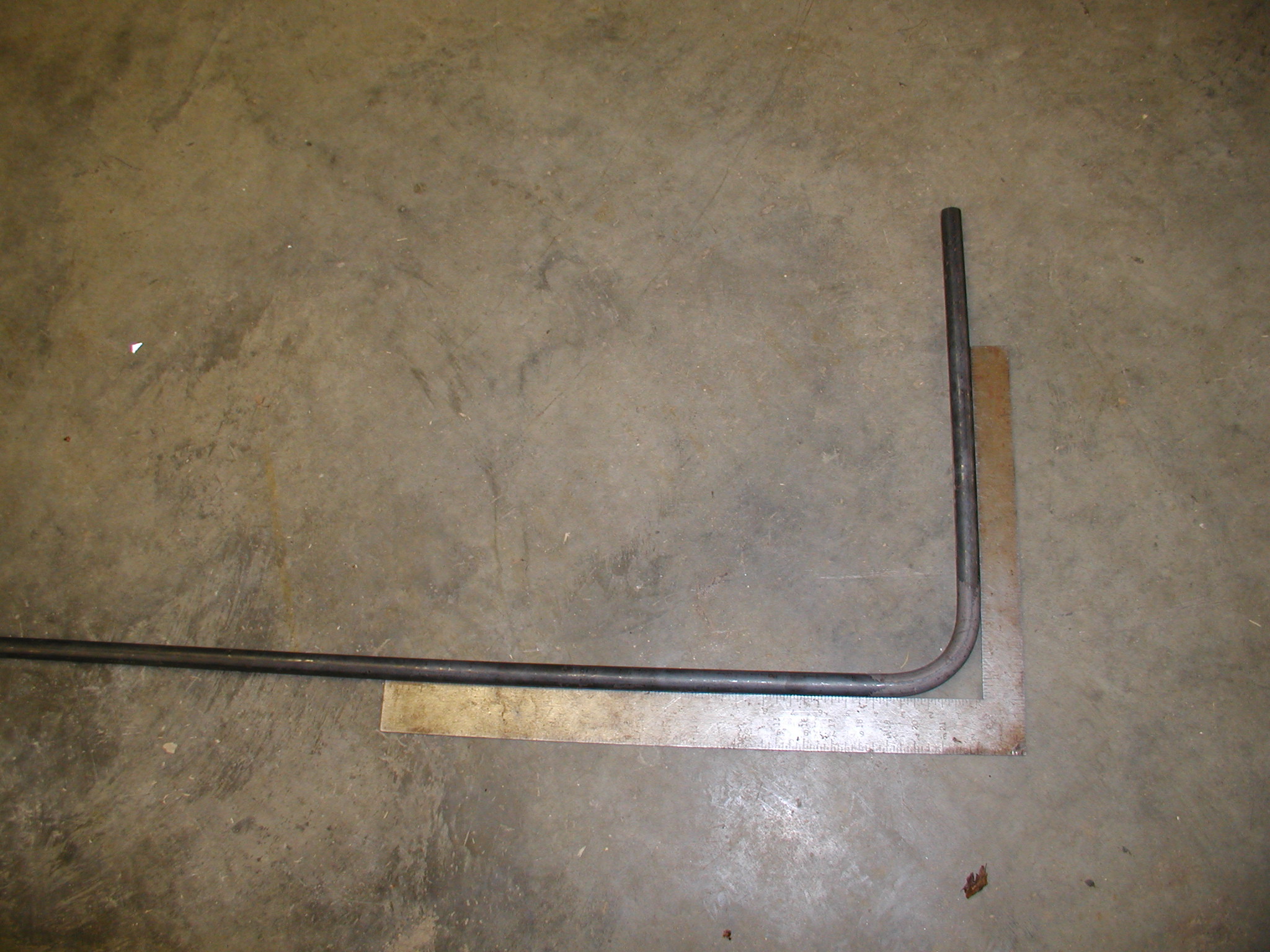

I whipped out this bender attachment for the hyd shop press. It aint pretty, but it makes a nice long-radius bend in 1 inch round stock. The bend radius is 2 inches.

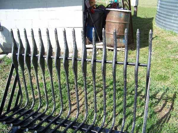

I found with the bradco rock bucket that if there is a lot of stubble, pine needles, roots mixed-in with loose soil the "fingers" tend to plug up the bucket along the front cross-support of the fingers creating a dam, making the thing push like a dozer and not sepparate. Back-raking technique helps with the bucket but I wonder if a smaller diameter "cross" rod would help curtail that. It is the same diameter as the main fingers. Mine is 66 in. wide with 3 in spacing. The thing is a little heavy 550 lbs. I thought about narrowing it up to loose weight. The 790 still handles it O.K. but less bucket weight= more material weight. hope some of this helps...:D

Spruce Deere: Yes, that helps. I am changing the angles of my parts to maybe help with what you said about buildup and bulldozing. If my figures are correct, mine will weigh about 350, and be 50 inches wide. The Bradco has been a large influence on my design. Last night I made a steel run and bought everything I'd need. Got home, ate supper, ran to shop and by nine oclock I had made the base frame, the quick tach pins, and bored the thru holes in the base frame for the pins. Tonight should allow me to finish the base frame and have it attached to the 2520 / 200CX loader. Have to draw a new part, based on a good suggestion from a friend. I will try to get some pictures tonight.
   / Input for my homemade rock bucket design? #10
Glad to be of some help jimgerken!!!:cool: Lookn at the "finger" in the pic, your design looks to be of a shorter finger, That will help with the weight. Cant remember the persons name, but they built a bucket simular to yours. They left there fingers short and strait and claimed exellent performance. That is a little of a bother also I have ran into when loading rocks and other items with 790/ 300 FEL and the rock bucket on a truck or flatbed that sits a little higher. The long fingers of the bradco will not let it dump or curl all the way before hitting the bed. Minor detail, can be worked around, but shorter fingers would help in such situations. Cant wait for more pics!!
