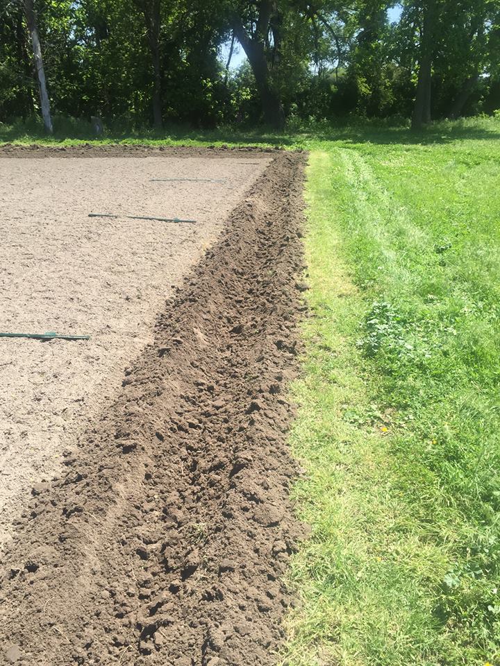

On a side note, we have found that a middlebuster purchased at TSC is a handy gardening tool. I use it to dig a trench around the garden to place our temporary fence in, to keep the critters out, and from digging underneath it (see photos). It also makes a nice "rut" to plant the started plants (tomatoes, etc) in without having to dig a hole for every one. But you could, I suppose, use the plow for that purpose just as easily. Just my thoughts.
