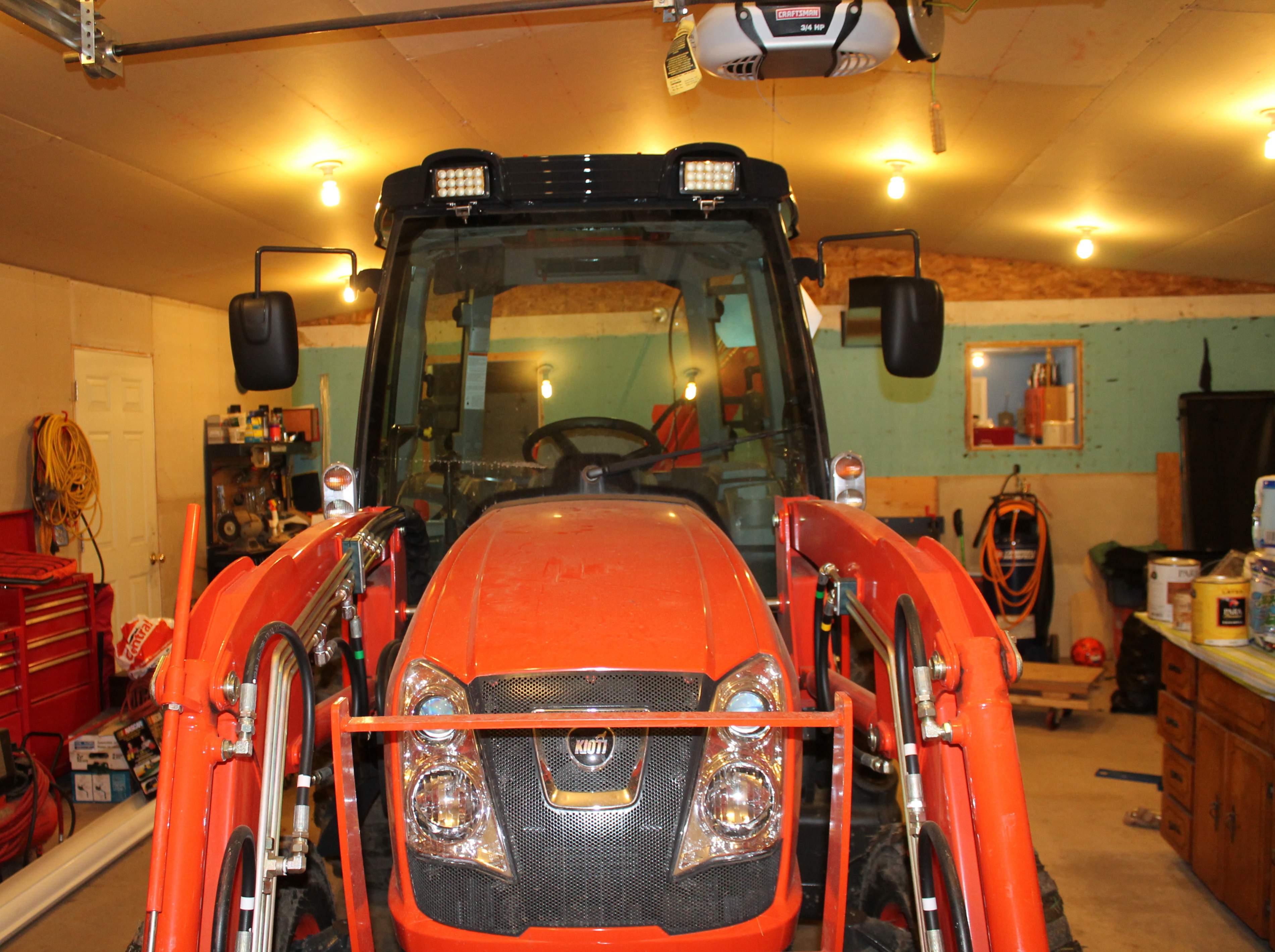

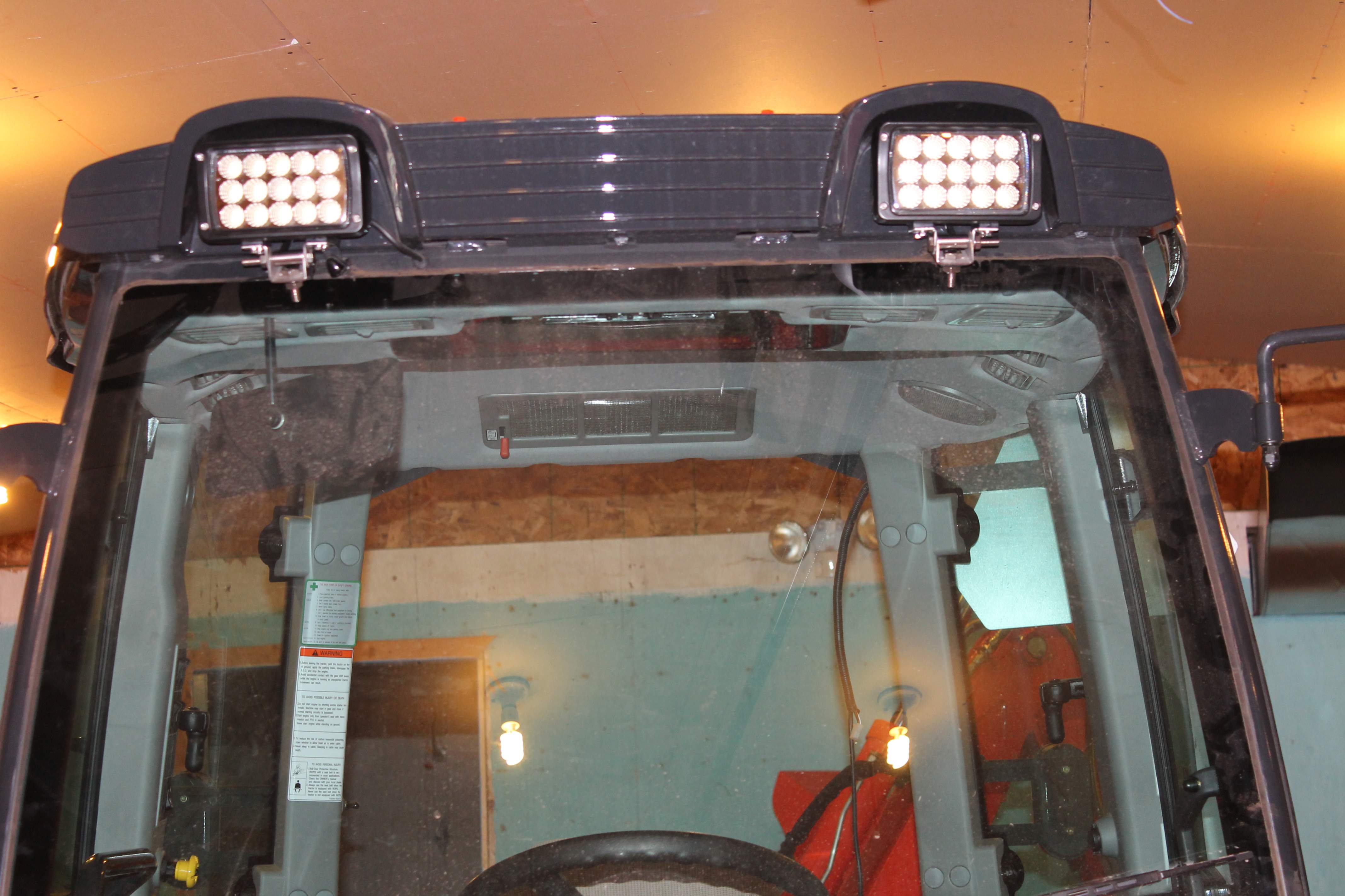

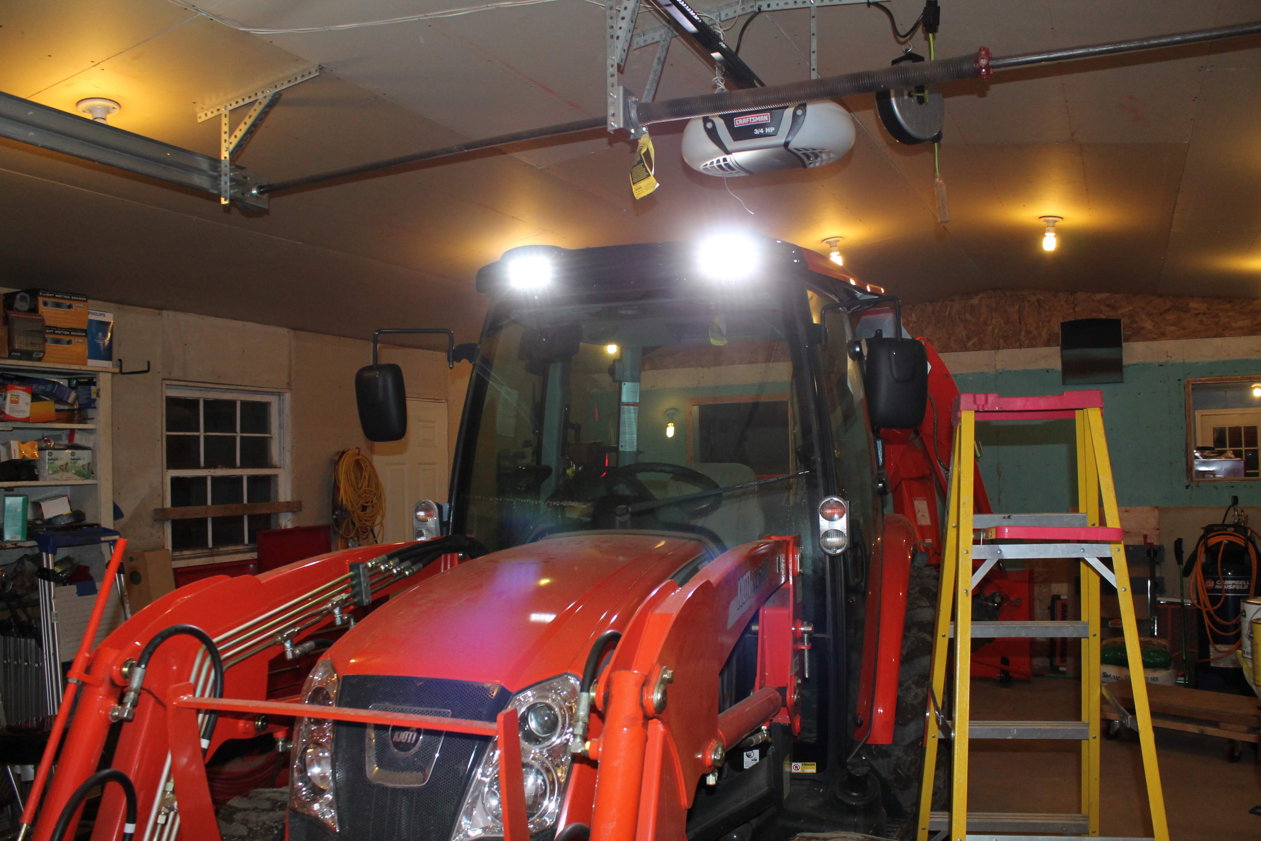

I'm impressed :) and got 2 more going on the back. Eric you're an inspiration to upgrading.
Oh and just as a foot note to the tool's opinion :this tractor may be a tool to people for work and I respect that but don't tell me that my tractor can't be a toy for work and play. Big boys like big toys - just saying!
View attachment 395105View attachment 395106View attachment 395107
KiotiKeven,
You may have already checked this out, but since I see how you're mounting the front lights by bending the tab down, be aware that for whatever reason there is a little less up and down clearance in the rear, and to mount the same style lights in back may require bending the mounting tab down as you did in the front, but also shimming the mount under the tab with washers as I did.

KiotiKeven,
Thanks Eric but I was lucky enough not to have to shim. I will start a new thread on my installation of the rear lights just finished this evening.
