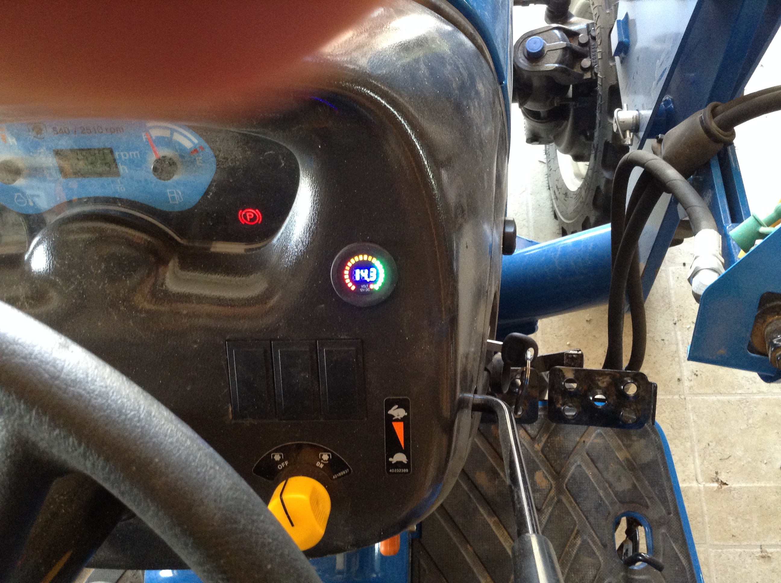

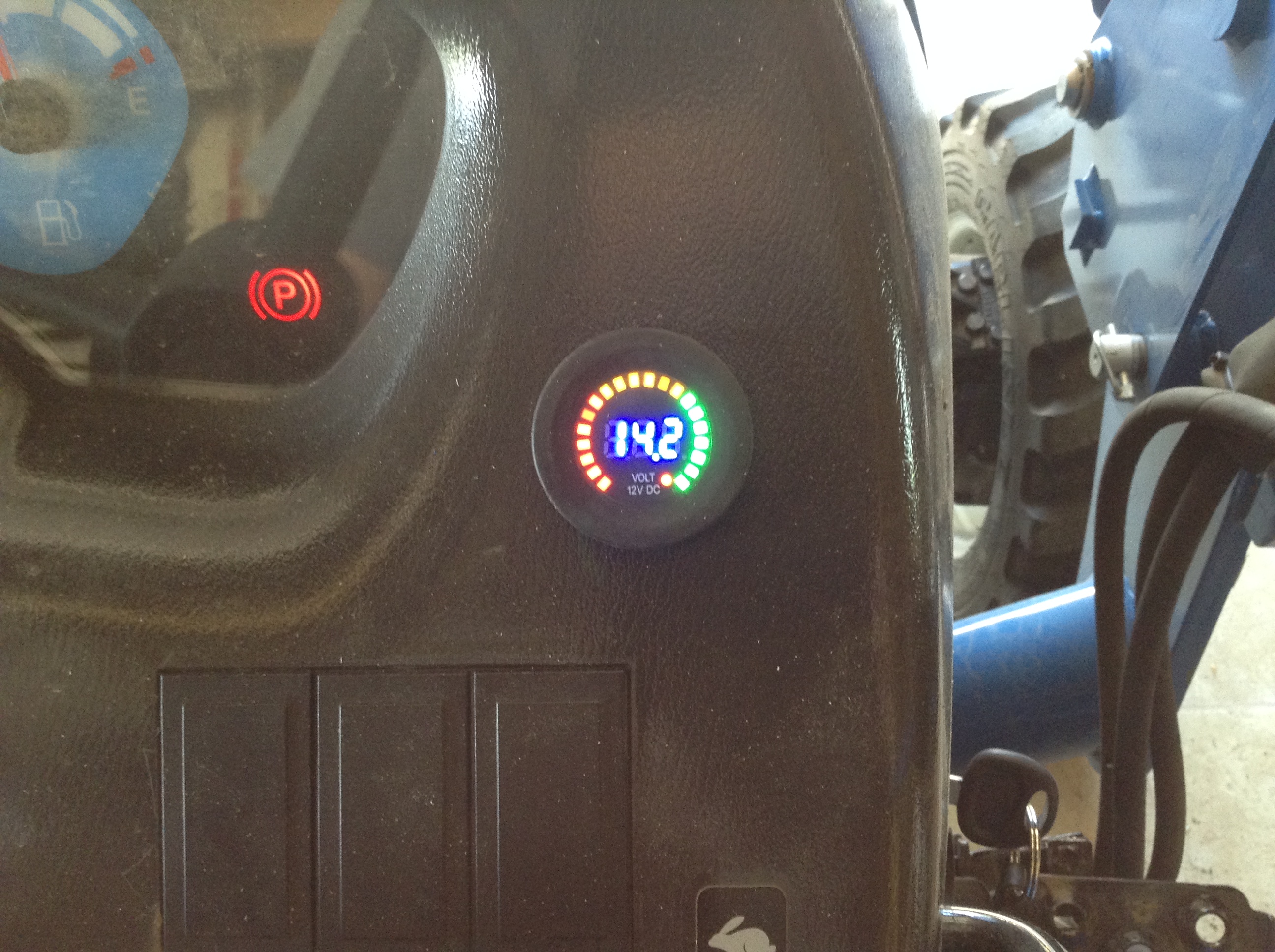

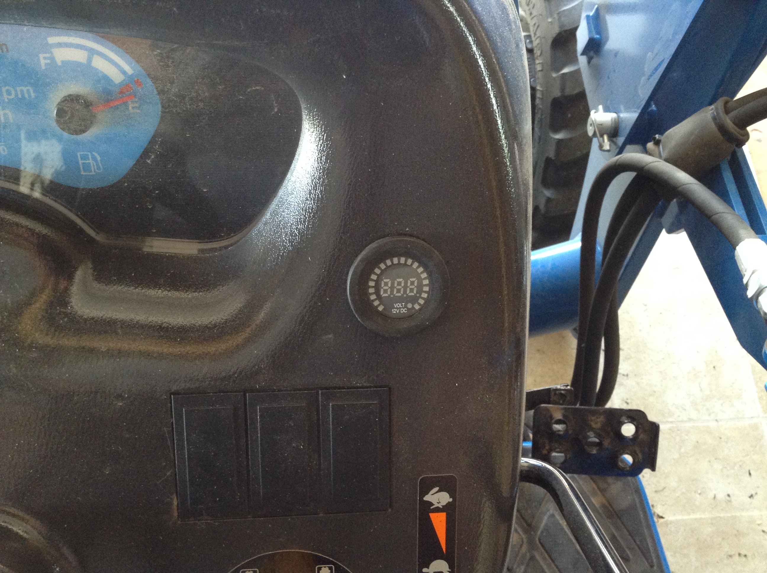

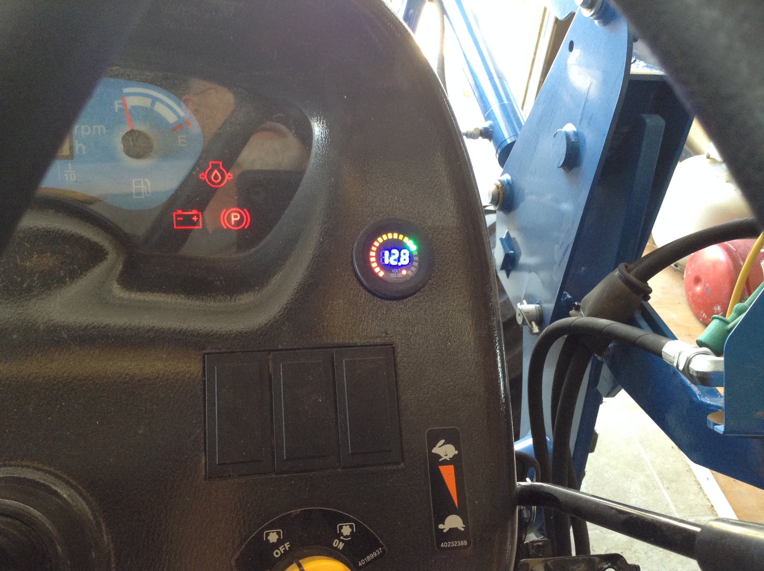

I didn't like not knowing what the battery / alternator status was so installed a voltmeter in the dash. There are red, yellow, and green status bars, plus a digital readout. Really easy to see with just a glance. :thumbsup::cool2:
I wish there was a quick "tap" for an oil pressure gauge....

The fuse box is located on the firewall just behind where the gauge was mounted on the dash (the fuses are on the engine side, all the wires going into the fusebox are on the dash side). There was a "spare" space, so I decided to use that slot for attachment. I just used a "spade" electrical connector on the positive wire on the gauge and plugged it in that slot (the power 'in' side)(where all the wires go into the fusebox). The negative off the gauge got attached to a nearby bolt holding a relay on the frame. Any of the ignition controlled (on when key is on, off when key is off) will work. There was a plug under the dash for a horn switch connection that I was going to use, but decided not to because I may hook up a horn.
It's a really simple hook up, if you have any more questions, just ask..... Good luck!
