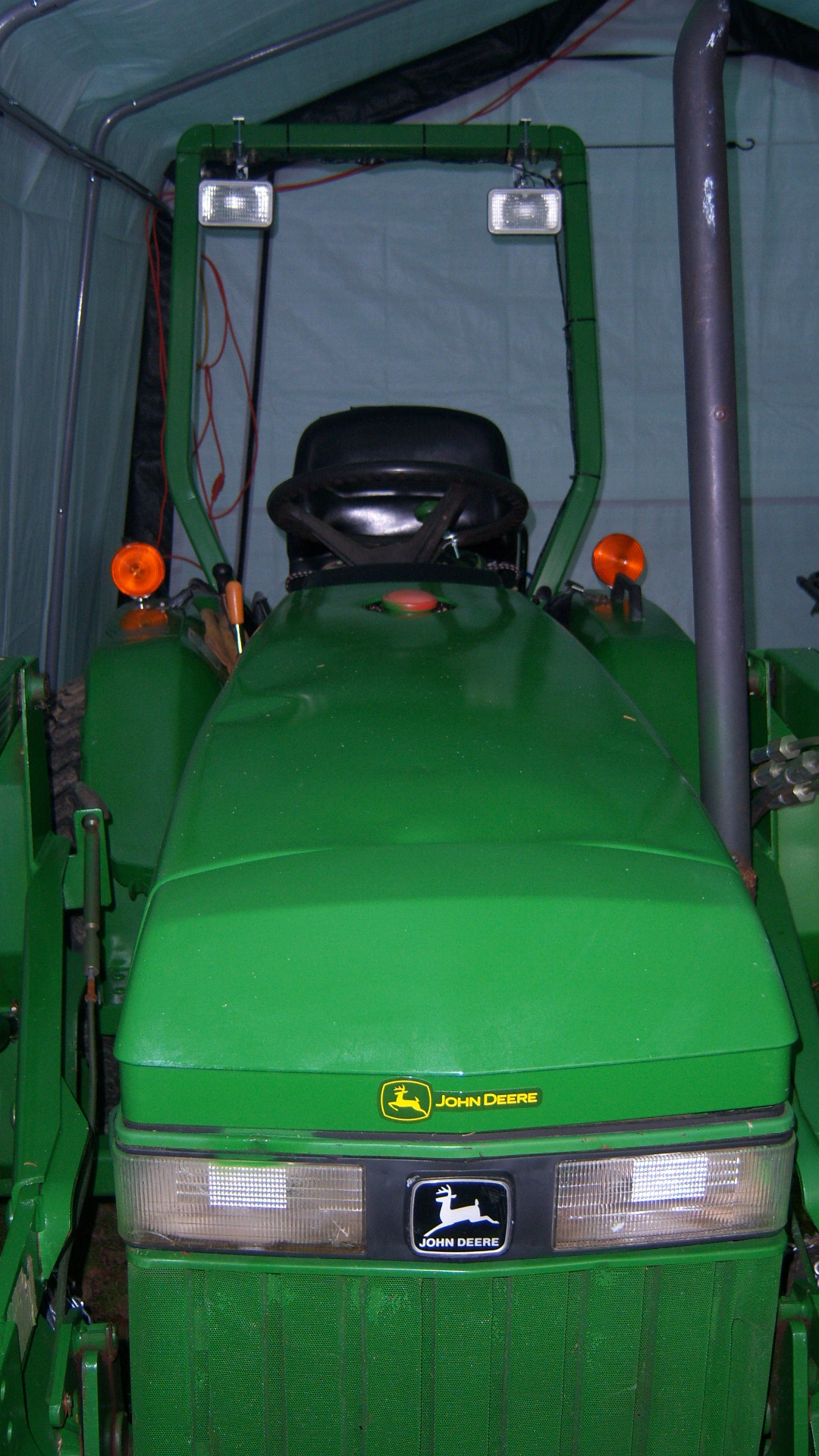

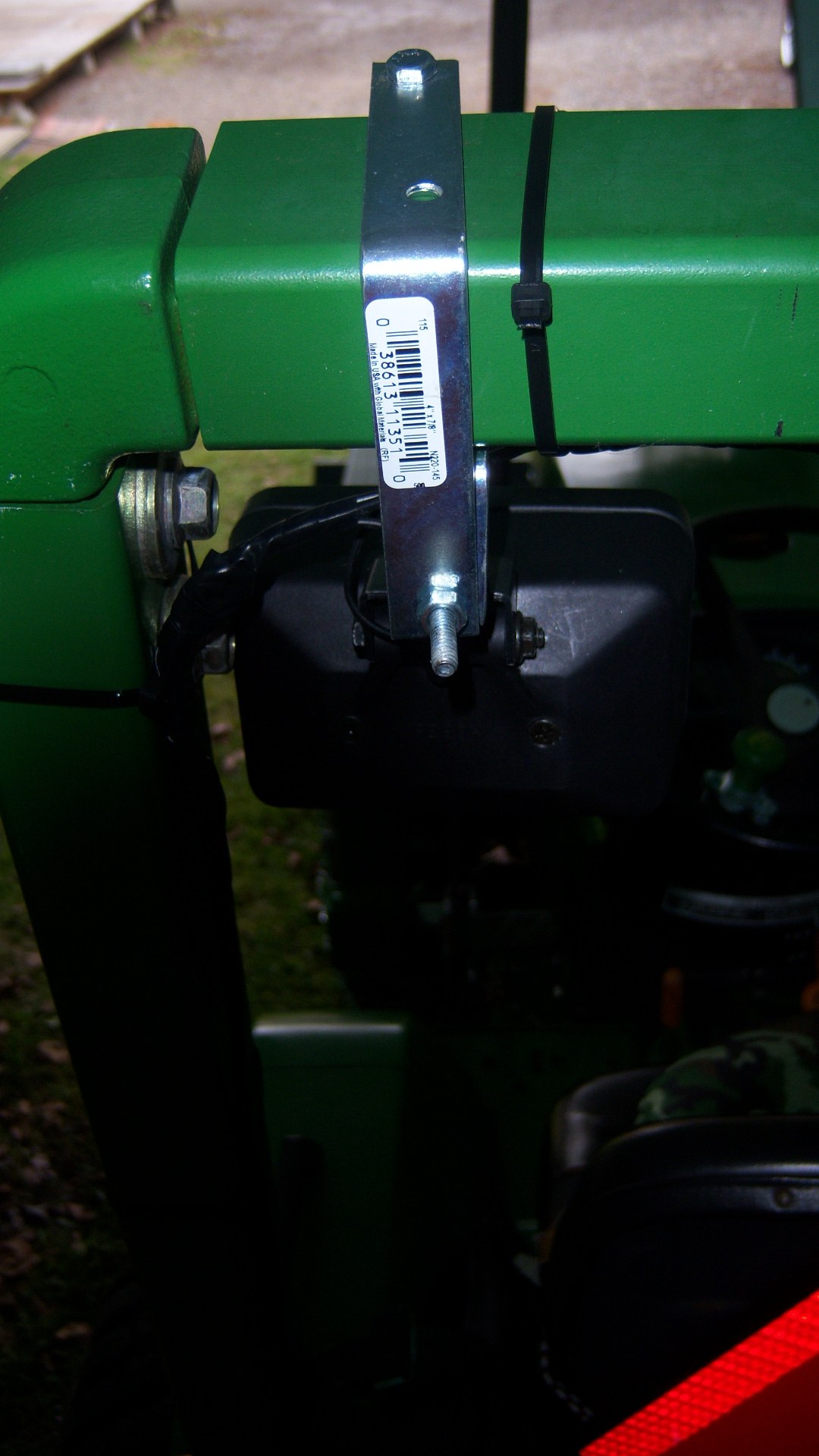

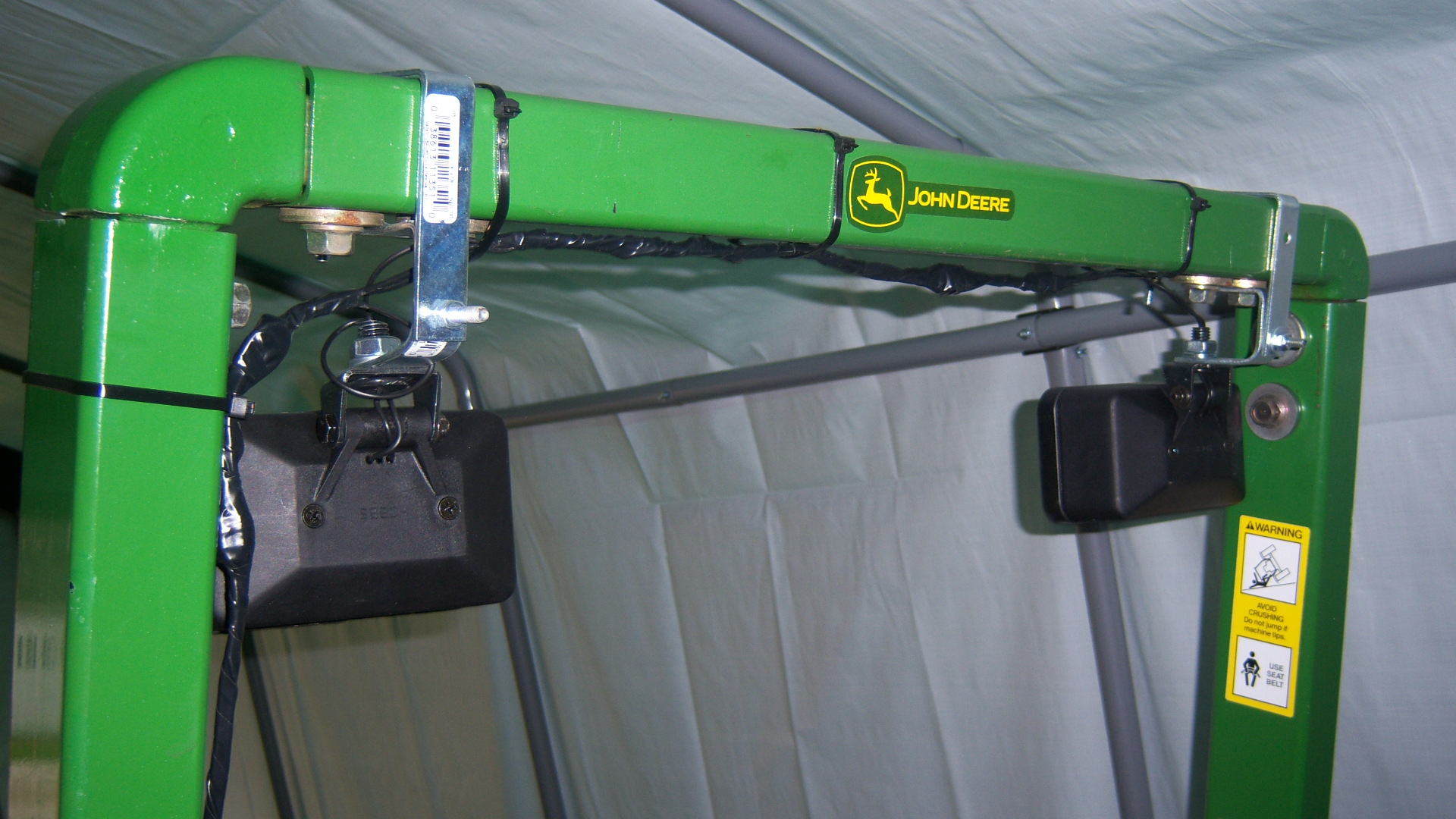

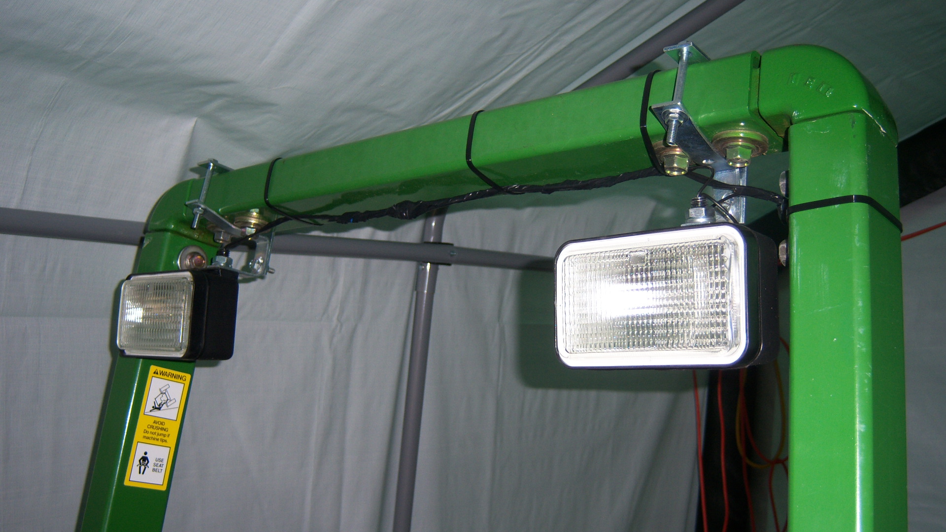

And figured out a very inexpensive way to mount them. lololol 4 3" angle irons and voila!!!!

Nice job.
How did you tap in for the voltage?
Same circuit as the headlamps?
New fuse/new switch different circuit?
I have been thinking of doing the same and am more than willing to use your experience to simplify mine.
Thanks
/ Installed extra lights on the ROPS
I got the lights at my local JD dealer for $25 bucks each.....then some wire and those angle irons and some connectors. The 790 has a harness near the drivers seat that you tap into and work off your headlight switch.
Trust me it had to be simple if I did this myself.:thumbsup:
I saw on a thread here that someone posted a link to some brackets for these lights. They wanted $30 each!! I made mine for just a few bucks.:p

Looking at your pics got me thinking! Do you (or anyone) think there is any reason why a (square edged) U-Bolt with a straight bracket or bar (straight bracket/bar down - so the U-bolt is upside down). I am thinking the straight bar would not be the one the U-bolt comes with, but would need to be heavier and perhaps an inch or 2 longer to accomodate a hole for the light bracket bolt. :confused3:
I would imagine a typical bracket/bar from Stanley or National or whoever manufactured your angles would work. Just curious....
You're right the square type U-Bolt was actually my first option but as luck would have it, the hardware store did not have a 3 inch.....thus i went with plan B!:D

Looks good! Did about the same thing on my 4100. Learned 2 things though, I put quick disconnects on the wiring so I could take them off easily due to tree branches and 2)keep a spare bulb or two handy because the vibration up there must be hard on them.

Are both those lights running off the same wire? Whats the max power you can pull off that wire safely?
#13
No they each have their own wire. Pretty simple hookup

Using the square Ubolts and 2" aluminum plate from TSC.
