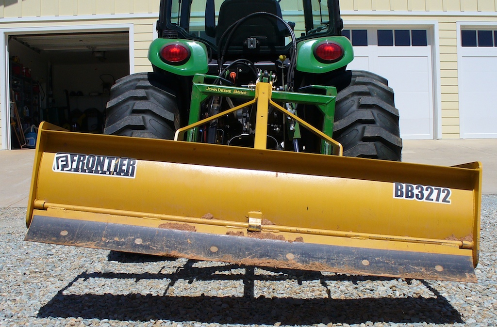

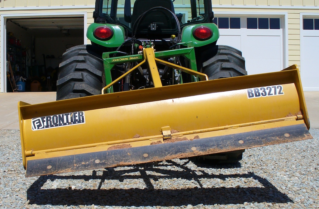

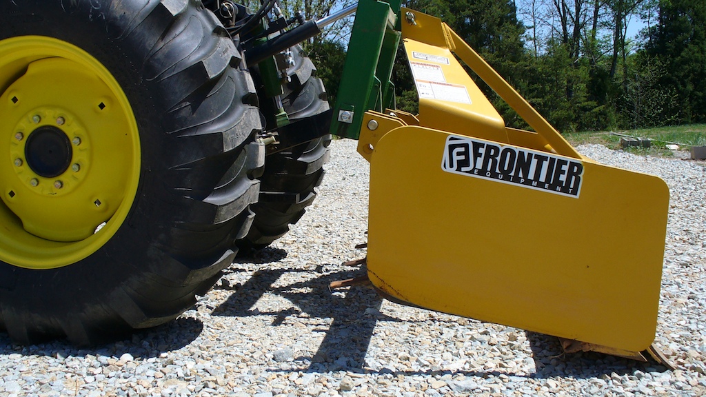

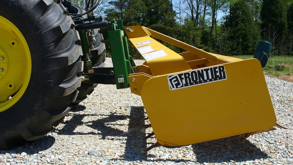

eepete, your rig sure looks nice. :thumbsup: I have a question though, do you find that your top link is to long? In the picture it looks like you can't get much forward tilt, is that the case or not even needed in your situations? :confused3:
   / Installed restricted orifice on my hydraulic toplink today #10
Picture is worth 1000 words, here's 4000 words worth of answer :).
I still have the manual side link on the other side, so if I want to get out of the cab I can bias the side to side tilt a bit more.
The hoses going up for the tilt are a little odd. This winter I'll look at getting them to re-direct under the tractor and not so they are touching the rear window of the cab. jenkinsph has his set up that way, it's cleaner.
Pete
