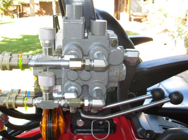

eepete, just finished installing the TNT on my little 3032E, and I have more or less the same problem with tilt (top link is ok). Tilt is a bit violent for my taste unless I'm really careful on the control. Further compounding the situation was my use of a 6" cyl for tilt instead of 4", so my tilt angle is I think a bit more than yours, too. I think I'm going to try one of the needle valves from Surplus Center that KennyD recommended.
Can't see EVER going back to the stone ages by not having TNT, though!

This is one of the things that soooooooo many people just do not seem to understand. If you use any grading implement, "TnT" makes such am improvement to the capabilities of that implement. :cool2: "TnT" is one of those options-improvements to our tractors that once you have it, you would never be without it again. :thumbsup:
Oh, needle valves are the way to go IMO. Be sure when you buy them that you get the valve that flows equally in both directions. I did not pay attention the first time and bought valves that only controlled the flow in one direction and had free flow for the return. :eek: :eek: You don't want to make that mistake.

What cylinder length would you guys recommend for the side link?? That's coming up for me soon.....from CCM, unless you have a better suggestion.
-Jer.

So for a low use small volume cylinder like my side link, taking the cheapo route with a home made fixed orifice restrictor would probably work ok? I'm hoping to keep things simple here.
   / Installed restricted orifice on my hydraulic toplink today #19
   / Installed restricted orifice on my hydraulic toplink today #20
While the restrictors help a lot, it is sort of a hit and miss type of deal to get the right size orifice. You might be surprised at how small the orifice needs to be to get the speed that you want. On my 3215, the needle valves are open as little as I can set them (virtually closed) to have them at a comfortable operating speed.
