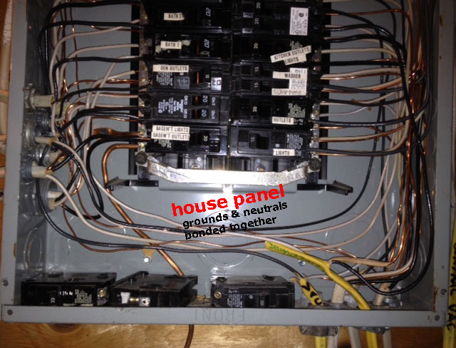

Sorry for contributing to the off-topic,,,,but this is interesting, educational.
On my "main" panel (200A service house panel) the ground bar and neutral bar are bonded together, bare grounds and white neutrals are mixed on both bars. Inspected and passed. But on the subpanel, grounds and neutrals are separate, and the neutral bar isolated from the subpanel box.
It may be obvious to some but I'm having a hard time grasping why it should be any different on the subpanel. If I plug a drill press into a "house" outlet, the eqpt case will be grounded and connected to the neutral bar. And if plug the drill press in at a "garage outlet", then the same grounding condition occurs (at the house panel).
Neutral is "floating" in the subpanel but neutral is bonded to ground 30 feet away at the house panel.
I am puzzled and interested in the reasoning for this detail and will appreciate another attempt at explanation maybe it will become clear.

   / Installing 240V Service To Your Shop - Price Breakdowns... #90
On my "main" panel (200A service house panel) the ground bar and neutral bar are bonded together, bare grounds and white neutrals are mixed on both bars. Inspected and passed. But on the subpanel, grounds and neutrals must remain separate, and the neutral isolated from the subpanel box. ..snip...
I am puzzled and interested in this detail.
Normally the service entrance on the house is a somewhat small distance from the overhead drop or underground feed to the meter. And it is much larger typically than a feed to a sub-panel is. So the thinking was at the time that there wouldn't be much of a voltage difference if you did the bonding in the panel (which is no longer allowed - it is now at the meter along with the ground rod connection).
A barn or shop is often a hundred or more foot run with smaller wire, and has the potential of energizing the ground with enough voltage by the time it gets back to the main panel or meter, to be a hazard. So in order to not use the ground wires as a possible return leg and energizing the grounds that could be a long distance from the earth ground, they don't allow it any more.
And they are reviewing ground rods now and probably are going to require more and longer ground rods in the future. Don't assume that just because something was allowed at some point that it is really as safe as it should be to keep people from being shocked or killed. Grounds have always been an area that have been somewhat unsafe in the past. In our area, they considered water pipes as a valid ground rod in the past, so as long as you had a copper water service line, and your panel bonded to it, it was considered ok. That was just plain dangerous...
