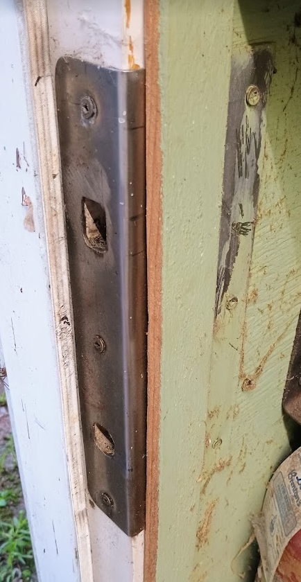

Hello Guys,
We’ve had 12 door break’ins in the last 2 weeks. Kicking in back doors the main MO. Wife is on edge when I’m traveling.
Besides the wife getting a .38 snub, I’m going to install these 12” strike plates and sub 3.5” stainless steel screws. In doing so, i have to remove 12” total of the copper flashing.
Is there anything that’s cost effective I can retrofit that 12” area to help keep in the cool air and keep out the heat? I have 4 of these so I’m going to repeat this process multiple times.
Pls see pic of product and 2 of the 4 thresholds. Thank you very much in advance.
Make damn certain the spanning distance is. Correct. I just had a similar situation and the spacing for the bolt to door is NOT the same on my door as that ‘security’ plate. And to my eye, that plate may not match your span.

Don't forget aout the hinge screws. 'They' usually detect the reinforced lock side, then kick in the hinge side because they generally have 1" screws in them. Use screws long enough to penetrate beyond the double studs of the door frame.
Also install a double keyed deadbolt (keys) needed on both sides with the inside 1 usually kept in there. This prevents 'them' fron breaking door or side glass and reaching in to turn the bolt. Yes it can be a fire danger if the key is not there and you are trapped. so park the key nearby ad out of sight.

I made my own strike plates on the mill full length and not a single jamb break since.
Now it’s the door that splinters around the lock so I beefed that up but any wood construction can be overcome with enough force.
One of my friends has 2x4 across to back stop force at at kick level and just below lock level.

When I built my garage years ago that was a concern of mine so I built some s/s plates for the jamb and the door:

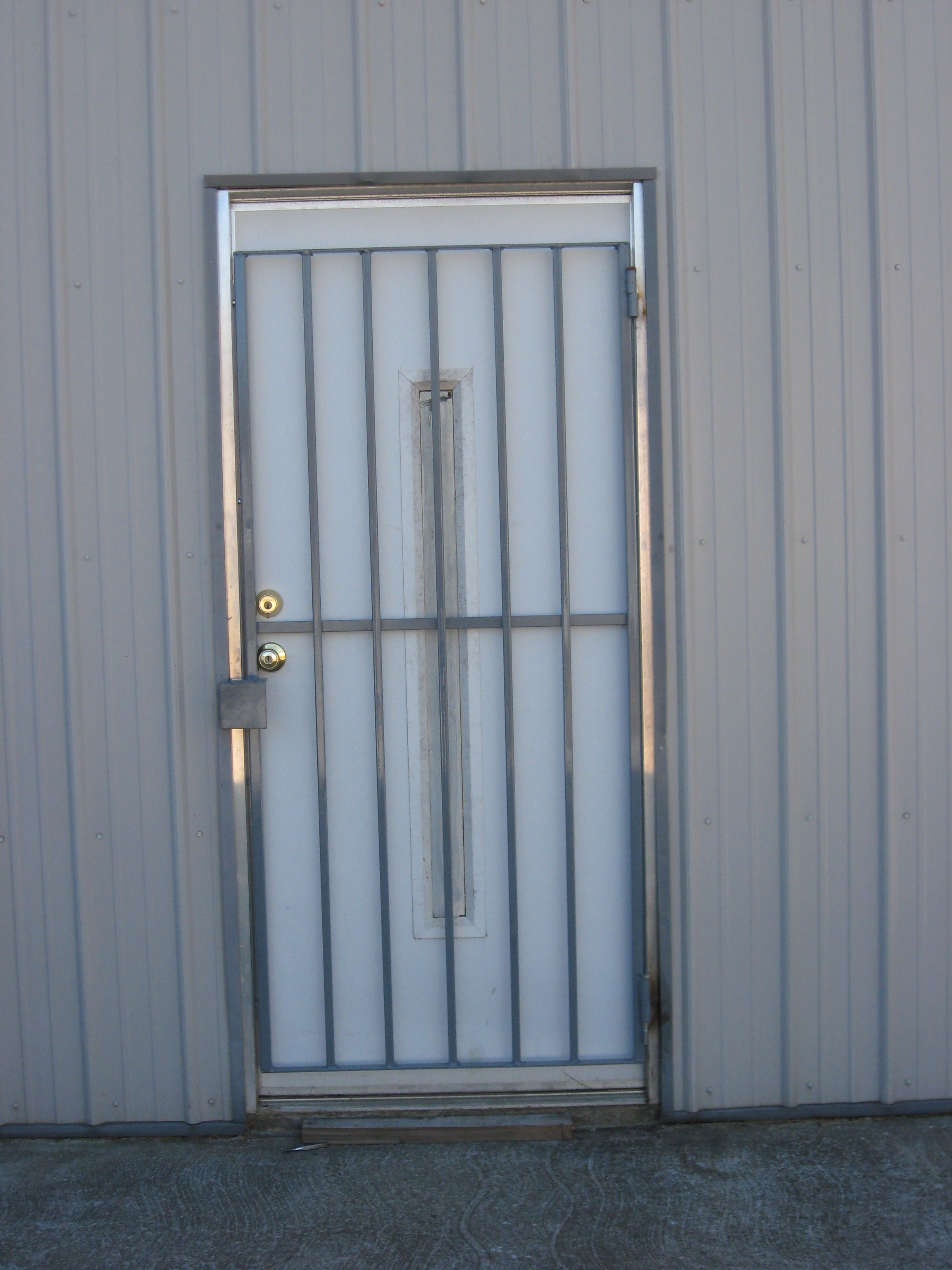

Sorry for your situation. Can't help with your specific question, but I do like the idea of security outer doors. I made my own ghetto bars for the shop.
