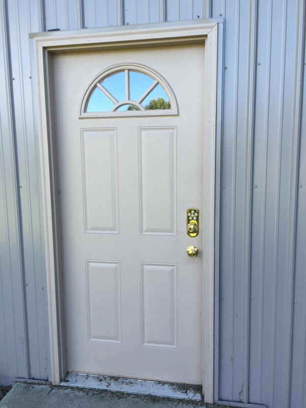

I was wondering if any body has a picture showing how you frame up for your walk in door ?? and also how you trimmed out the outside of it thanks

Here is one way. Can only post pic at a time

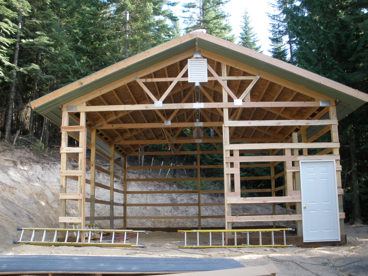

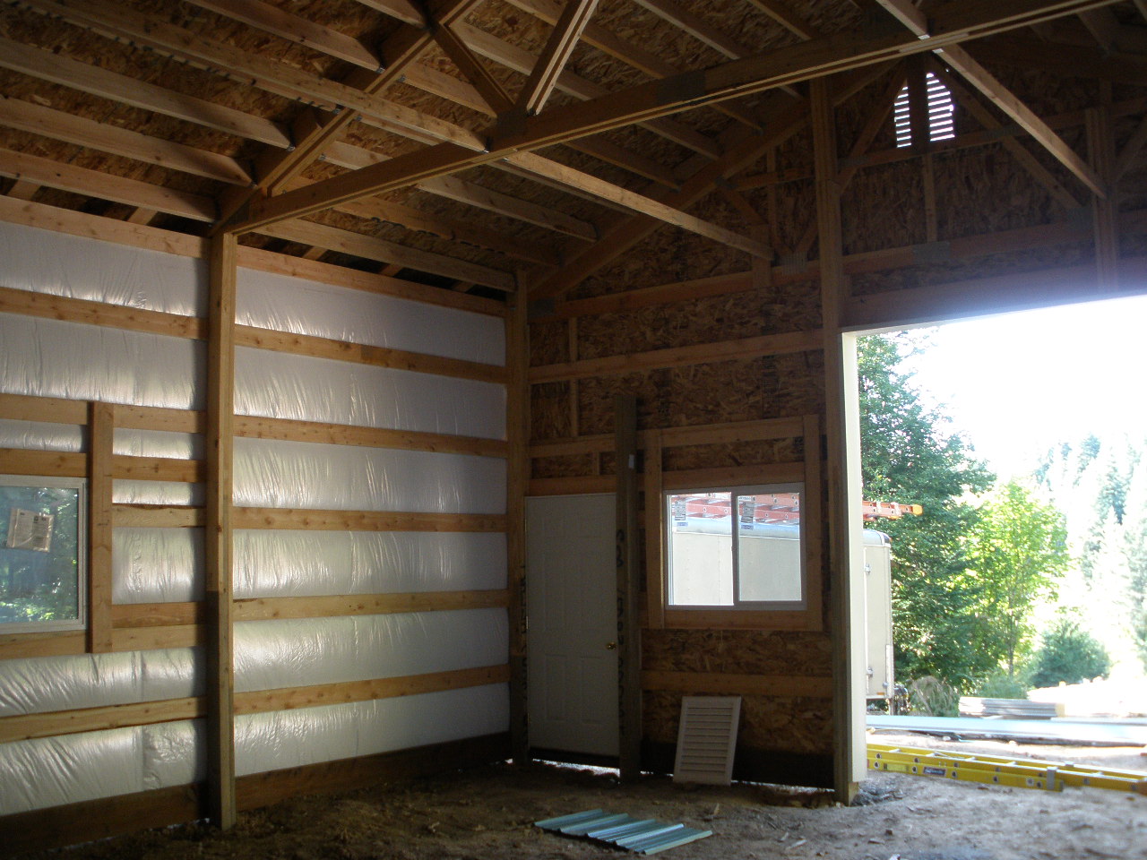

I like to take the posts all the way to the roof framing.

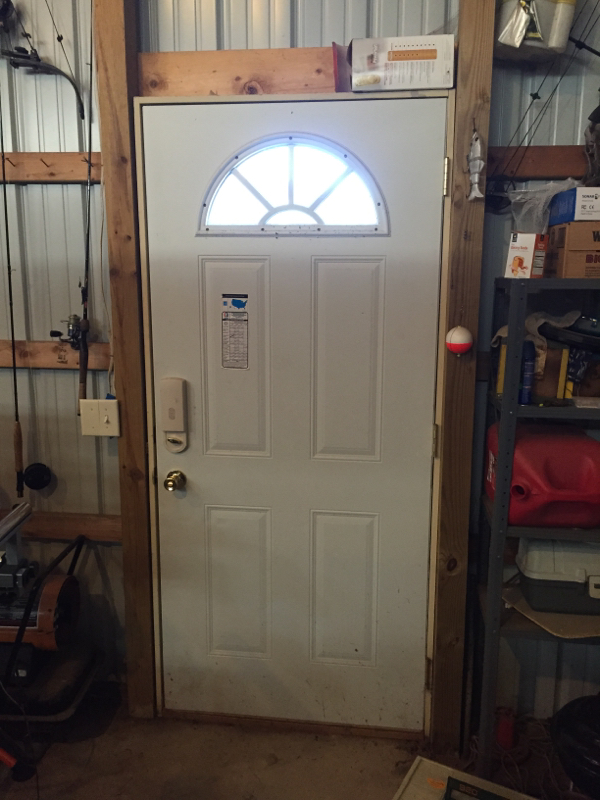

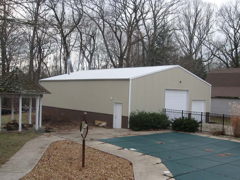

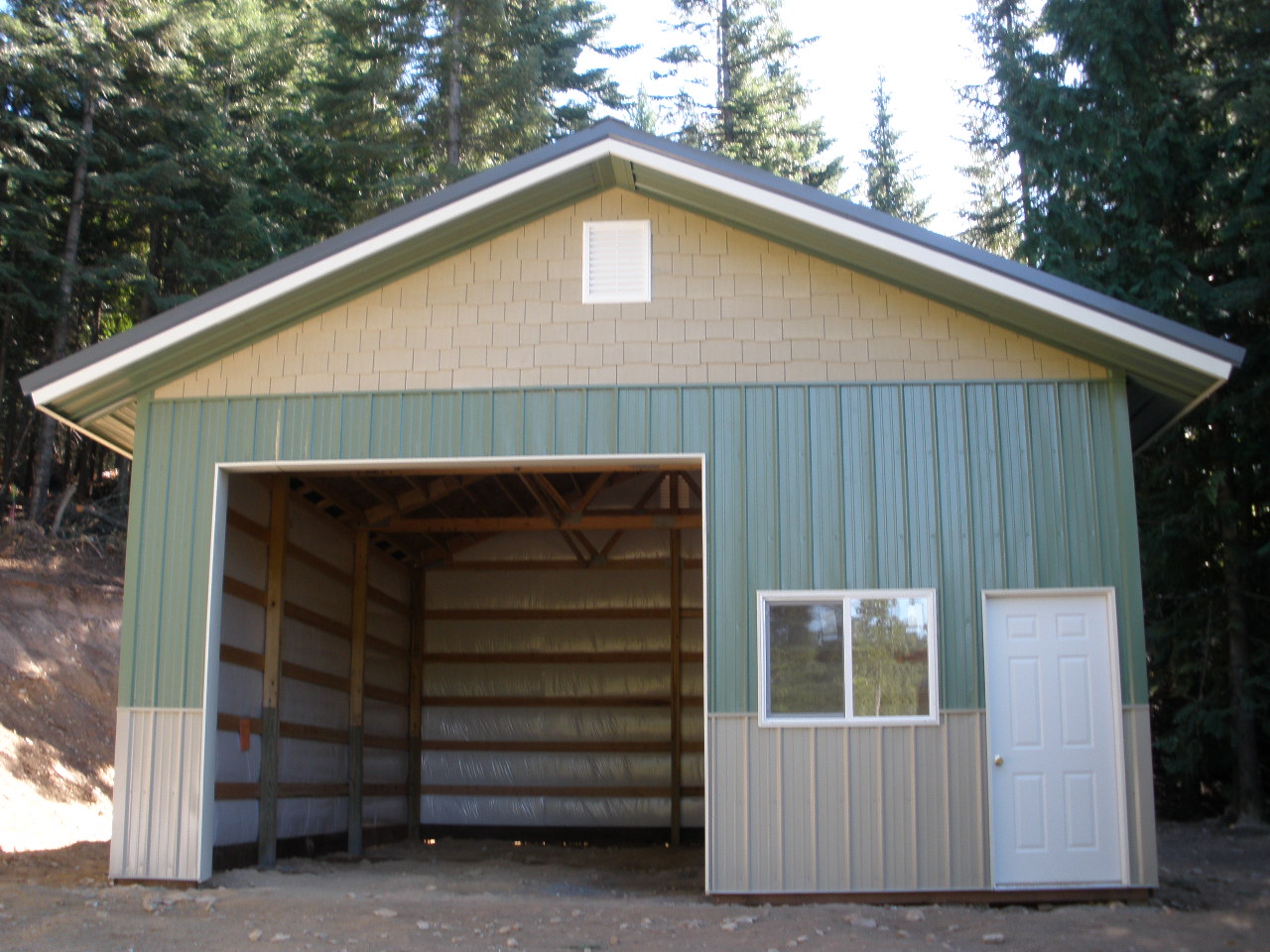

Here are a few I took during construction. I hope you can enlarge them and see the detail you need.

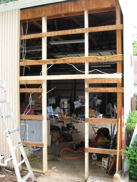

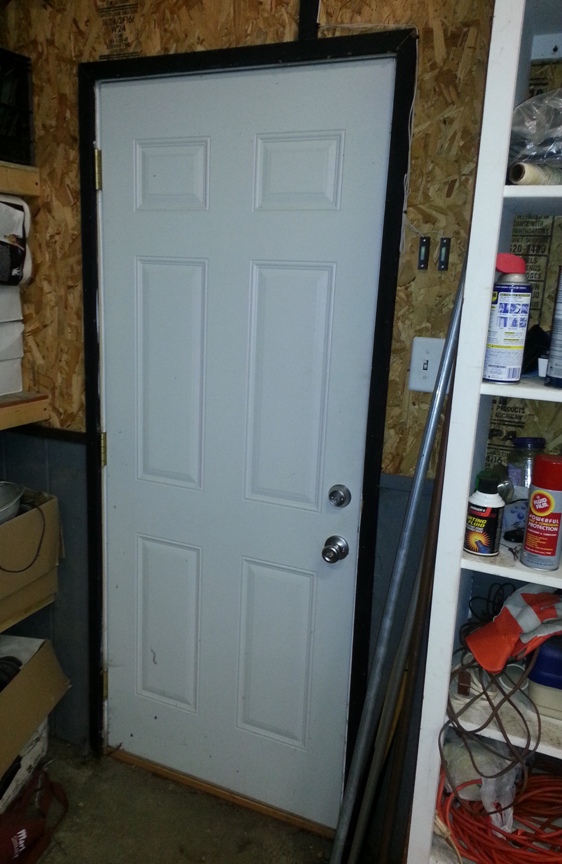

I think you are seeing a pretty consistent pattern here. I don't have a chance right now to show the details, but here are a few pictures of a door replacement I did. The original door was all metal (door and frame) and made for the 6" thick poles and metal siding, but it was installed badly and completely rusted out. I replaced it with a standard residential metal pre-hung door. I started out by putting in new 2x6 studs all the way up, as tman recommended. I then framed the door opening inside these studs with 2x4s, biased to be even with the inside of the 2x6s (because I was going to finish the interior. I then installed the pre-hung door, with brick mold trim, into the 2x4s. This left the door recessed, but when I put new siding on, I trimmed it out with metal trim inserted into the gap between the 2x6s and the brick mold. Worked out very well. I won't be back home until this weekend but I will try to get some detailed photos to show how the final trim worked out.
/ installing door in pole barn #7

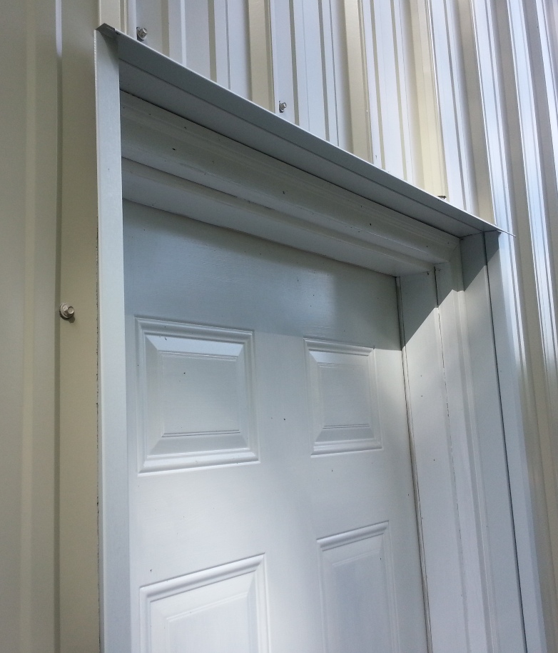

KennyG, was the trim something you put together or was it purpose-made metal siding trim? It looks like it matches the other doors really well.
/ installing door in pole barn #8
It is the standard "L", "J", and drip edge trim that is available from the metal siding suppliers. I replaced all the siding and trim after I replaced the entry door and added a new second overhead door.

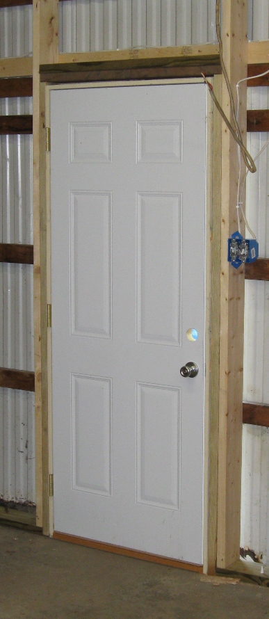

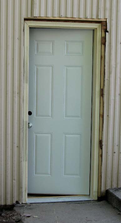

Ok, here are a few more pictures if you would like a little more detail. The first one shows the framing with the 2x4 framing for the door inside the 2x6 framing that goes to the barn itself. I also put 2x6 treated plates on the concrete, anchored with driven nails. The second shows the final trim. A 90 degree angle trim goes just inside the brick mold and over the girts. Then the j-strip on the sides and drip edge goes over that and the siding goes on. I should caulk between the brick mold and trim but I haven't done that yet. The last picture is the finished inside.
