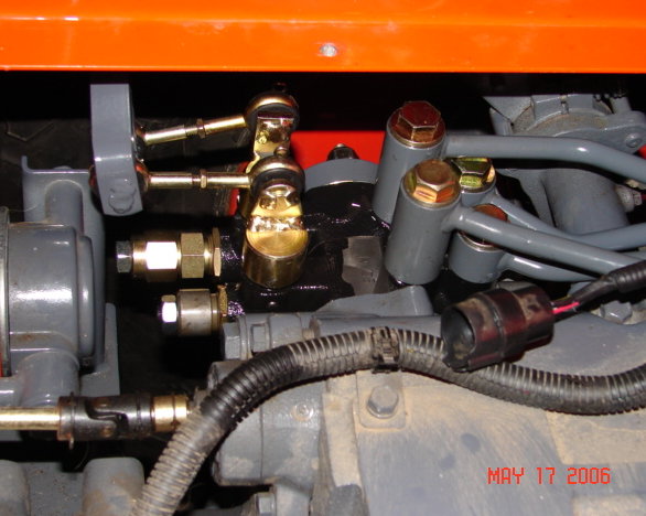

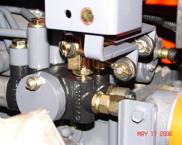

Dodgeram,
You have half of the work done, sort of. You'll have to disconnect your hydro lines and linkage from the first valve and remove the valve to install longer studs for the two valve combo. Should go quick being that you know how it all works.
