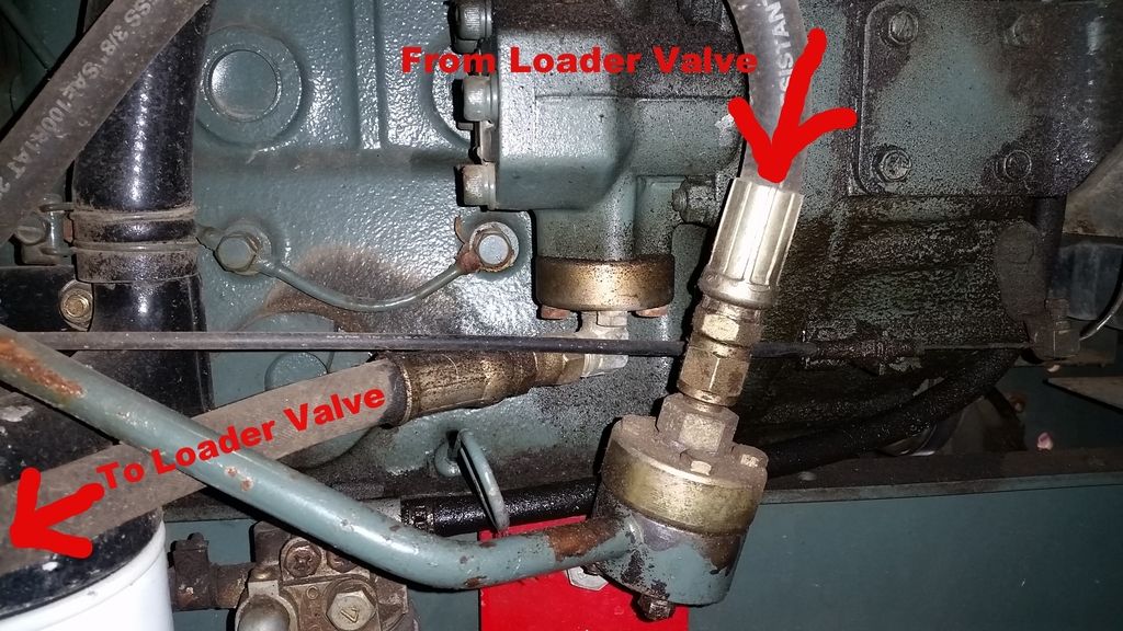

My current loader set up has what Hoye calls the HA-38 (Yanmar Tractor Parts HYDRAULIC ADAPTER - ADD A LOADER / LOG SPLITTER). This comes off the pump with a HP Hose to the loader Valve. The Loader valve has a HP return line that goes to another HA-38 to a hard line that I am pretty sure feeds the 3pt. It works.

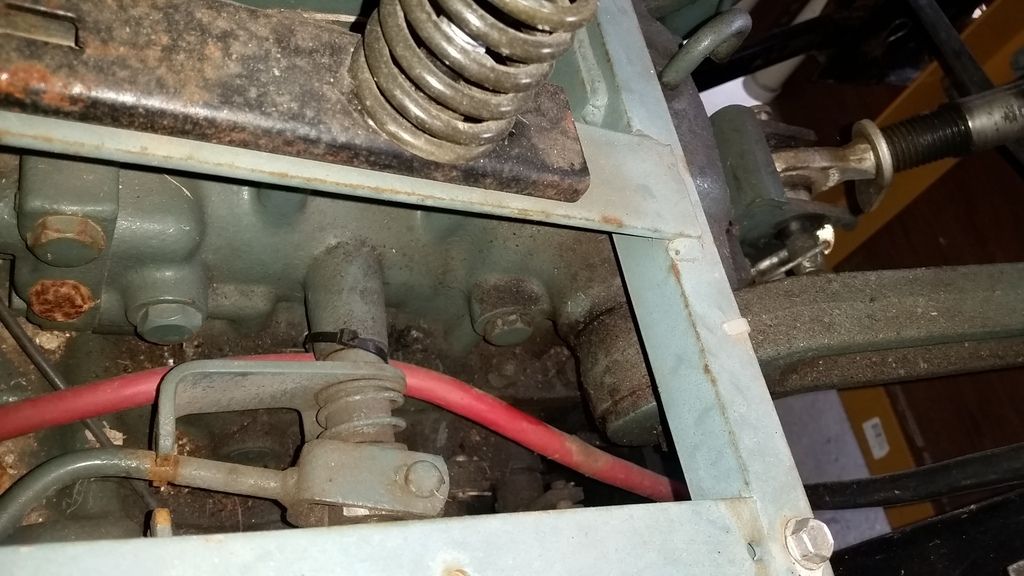

Thanks Gang....I understand the flow much better now and have plumbed it up except for the dumping of fluid back into the transmission and am at a stand still at the moment. In my model, instead of dumping back into the dip stick hole, the instructions say to remove a plug very close to the 3pt arms. The problem is the casting is in the way to install the right angled fitting they provided. I assume there is an extension fitting I can buy, but the local hydraulics shop was closed.
In this picture its the plug on the right near the lift arm. I am wondering if the one on the left goes to the same place. I have a similar problem as the pto bracketery is in the way though.

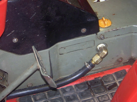

My old 2002d had a side plug on the transmission for the return. Would your 2020 happen to have one here. If so, a 3/8npt fitting will screw right in. You can screw the dip stick out and watch the return flow.

... and since this is a return drain line, it never sees pressure. So common water pipe fittings should be sufficient. Scotty, could you install a short piece of pipe there, then a coupling or elbow, common 3/8 water pipe fittings, to move that opening out where you can work with it?

Quick update....I opened up the left port and fluid began pouring out so I stopped...Will wait until Monday to get an extension. Since the tractor is stationary...mine as well change the hydraulic fluid and change the oil.....good excuse to go to Tractor Supply.
... and since this is a return drain line, it never sees pressure. So common water pipe fittings should be sufficient. Scotty, could you install a short piece of pipe there, then an elbow, common 3/8 water pipe fittings, to move that opening out where you can work with it?
I thought of that....but questioned my logic.....The return hose that Hoye/Fredricks supplied is rated at 3000 psi and so is the fitting provided and it comes off of the cylinder. I was wondering if it had more pressure that I thought???
I dont have a port like that Winston....
