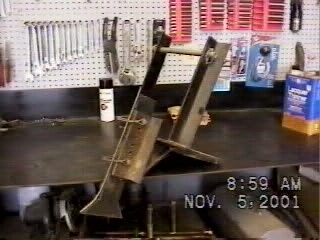

well ill try again
Hoghead

Where we live, having a hole or trench in the ground is a valuable thing -- because of the rocks. It's almost so bad, that, when we have a hole, we save it just in case we need it for something later.
Because of that, we installed our invisible fence through the woods just laying it on top of the ground. There's only animal traffic, so it is safe (so far). It was just laid on top of the gravel driveway for 1-1/2 years, until I had a chance to get a piece of conduit under the gravel (it broke every time that the drive way was snow-plowed and having to find the ends of a piece of yellow wire was fun - ha-ha).
