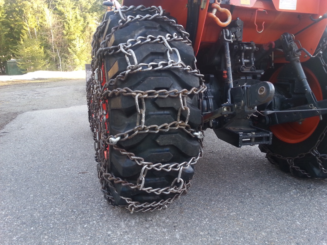

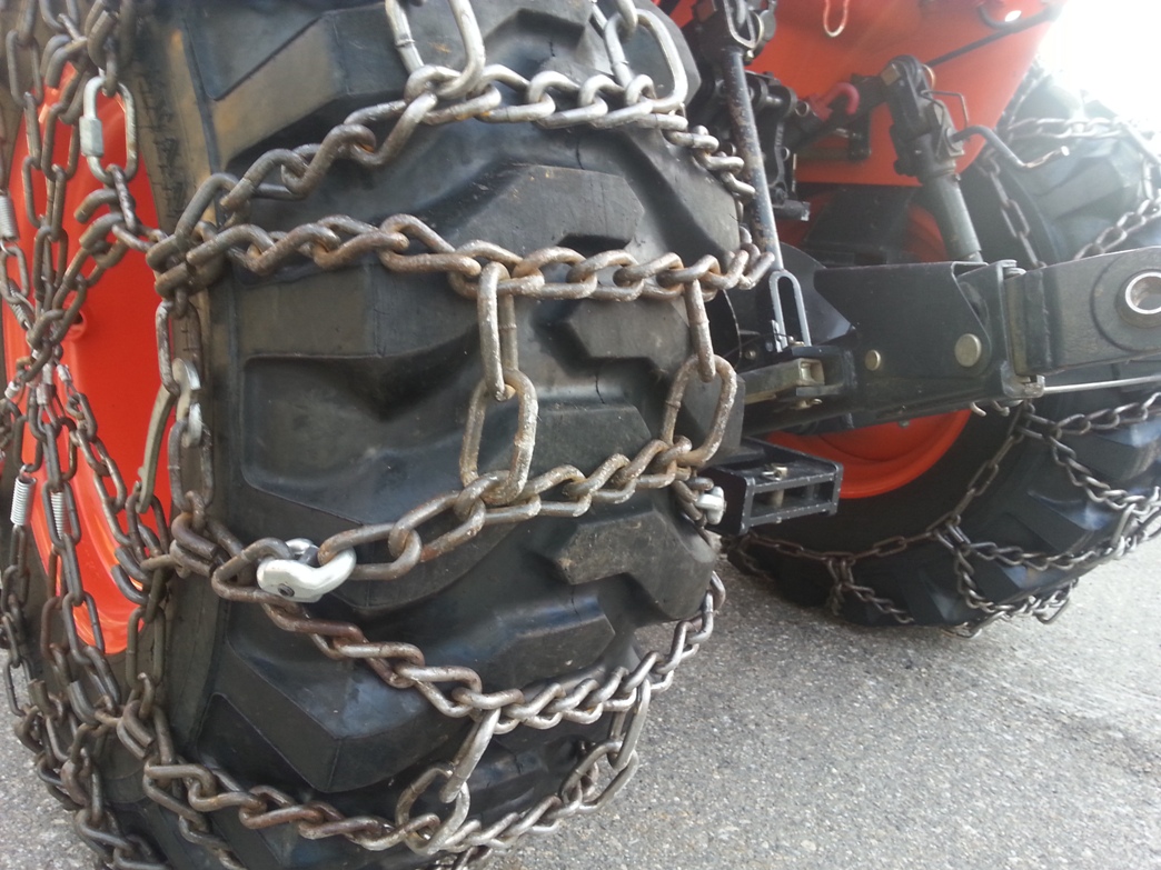

Something else that might work is a pin coupler as shown here:
Tire Chains Equipment Pin Repair Coupler
I got mine at a local industrial equipment shop at a much cheaper price than tirechains.com. I believe they are 10mm for my rear chains and 7mm for the fronts.
Attached are photos of them on my rear chains.
Although I have spares, I have used the same couplers for 4 winters with no problems.
My tires have worn since then so I replaced a side chain link on each side with shorter pin couplers. They make a compact, secure connection.

That is what I would use too for circumferential chains if I had to cut off the special Chinese Puzzle connection hooks to make them fit or move where a cross chain connects to the circumferential chain.
