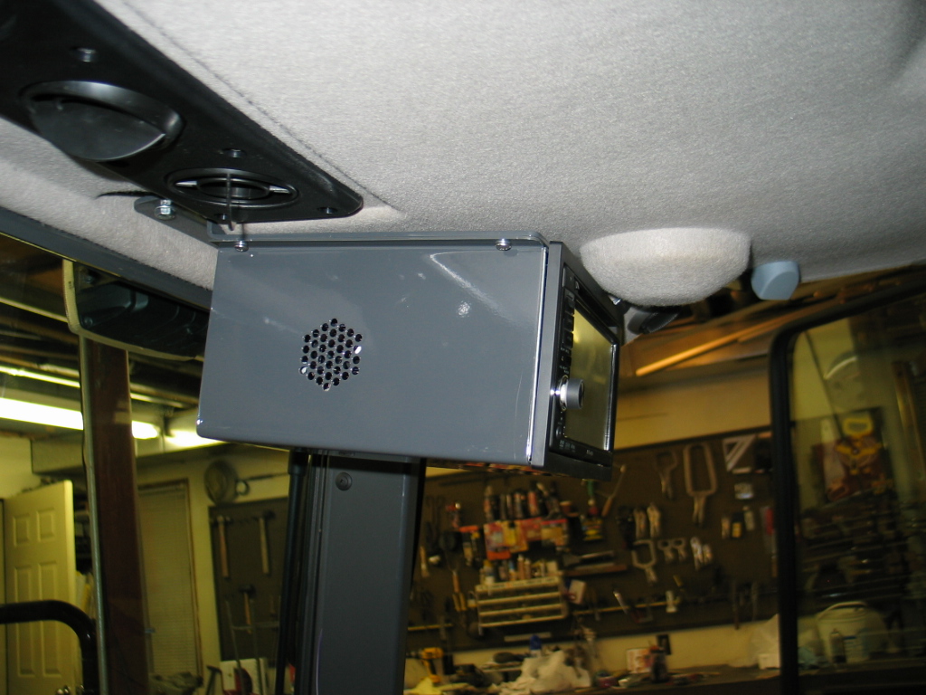

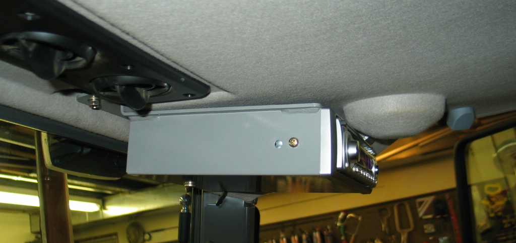

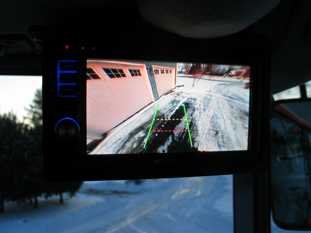

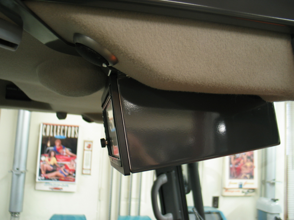

Do you have any pictures of your stereo installation i cannot see the ones that you posted in "installing speakers in a headliner".
Thanks
Jeremiah

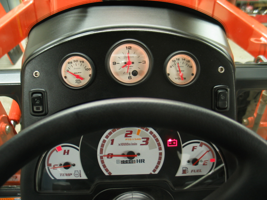

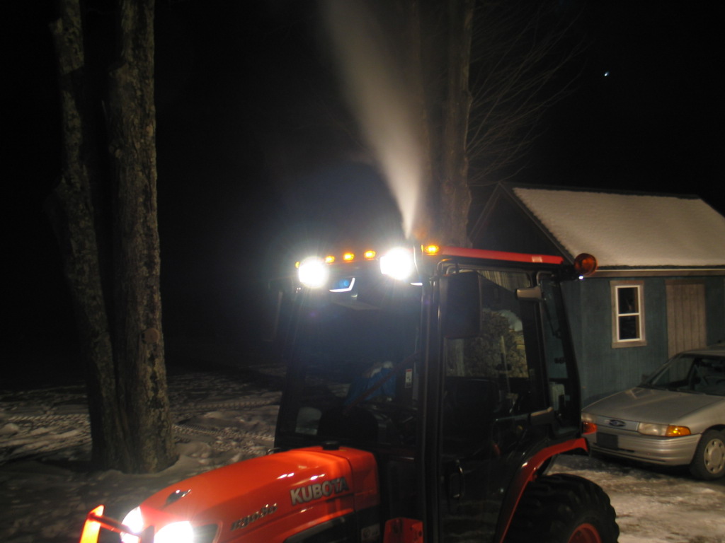

The first picture is the factory radio mount, then I replaced it with a DVD player so I can use the monitor as a backup camera monitor. It also plays my Ipod, movies etc. I have done a lot of customising on my tractor. I mostly use the stereo when snow plowing, the engine is not running at PTO speed and I can have the volume at a cofortable level. I mostly watch movies only when using the loader or working on a steep hill (thats a joke for those who want to yell at me for having a DVD player, but as I said it doubles as my backup camera monitor.
Is it all needed NO!.......but I had fun mking/installing and using it all.

Here is a video which the radio is heard in the backround, I was not distracted by the radio, It was not blaring loud and I didn't need headphones. I was even was holding the video camera with one hand behind my back to shoot the video and pulled the whole thing off. You're right I guess if you're doing something you really have to concentrate, my radio has a volume control and an off button. YouTube - Kubota b3030 backup camera

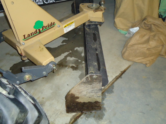

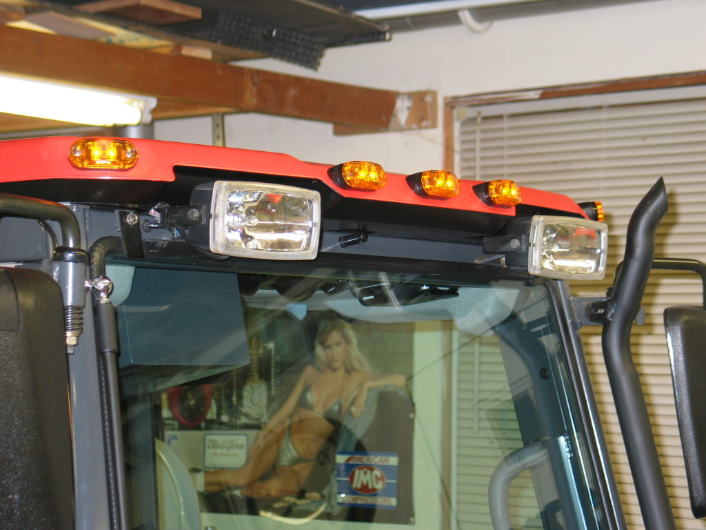

DSC00235.JPGI am new to this site but have been the owner of a B3030 wo/cab for many years. I have been reading posts on this site for just as long and found the people to be very helpful and knowledgeable. I have made several mods over the years and I have just purchased a new B3030 with the cab and added some more. I joined specifically to somewhat give back to the people on this site and post some of the ideas in case someone might be interested.

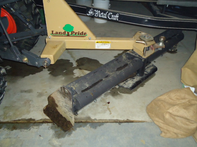

Rear Blade:
From my name you can imagine I have horses and mules. If you are not familiar they create a lot of work cleaning up after them. I modified my rear blade to add weight but built skid sides so as to scrape the corrals and not remove the subsoil. I added weight with some XXH 4" pipe filled with gravel and welded the ends shut. Supported with 2" angle underneath. Skid shoes built from 1/2" plate

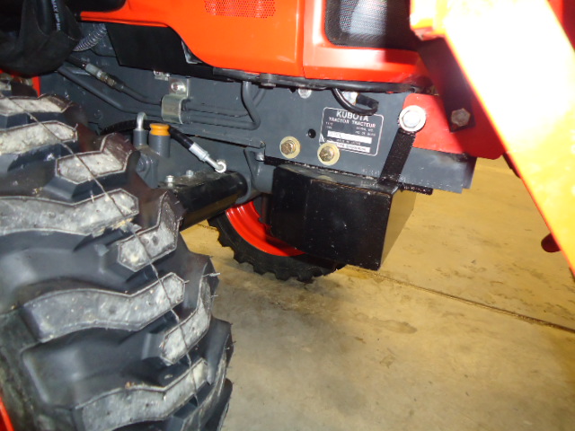

Front Weight:
I wanted some weight for the front but I have a snowblower that limits what you can do. I built a box weight that fits inside the frame and just below. It is angled to miss tire chains and sets back to allow attachment of the snowblower under carriage. I welded a 3/4" coupling on the top and bottom so that I can attach it empty and them fill it with buckshot. If I need to remove it I can drain the shot first. Adds 190 lbs.

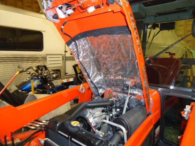

Cab Noise:
I saw many posts about cab noise on the 3030. It is a little so I bought some of the foil backed underhood insulation from JC Whitney. Lined the hood and firewall. Added some on the floor boards under the mat and inside the steering cowling. $50 and a few cigars in the man cave and I think it helped. I can hear the stereo pretty good. Also noticed the doors have two closed positions. Closed and really closed. Keeps the noise out more when in the really closed position. Just had to adjust them a little so I didn't have to slam as hard.

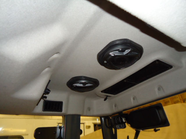

Stereo/speakers:
I added a Sony(has what they call a tune tray for your ipod) stereo with 4" speakers in the headliner. Used electrical connections so I can remove the liner with the speakers in place. Used a 1/2" plastic spacer so the speakers did not wedge between the headliner and roof too much. Also put foam boom mats around the back of the speakers. By the way Waxman's post on how to remove the headliner was tremendously helpful here. I am sure I would have broke something without it.

Hopefully the pictures I tried to attach actually worked. First time and all. An engineer with a wire feed welder and an idea is a scary proposition. Thanks again all.
