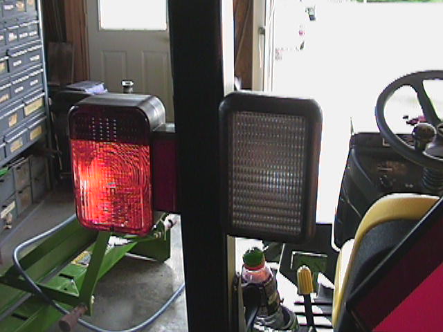

Moving lights to the inside is not a problem. (See attachment) And unless your only about 4 foot tall, i don't think you will be pumping your head on them.
You could get some 2 "wide metal strap and bend a cage around the out side of the lights. Kind of like a full capital letter C. Drill the inside tabs of the C for the mounting bolts from the lights and install the cage between the light base and the ROPS. I've seen this done for top mounted lights on other TBN threads.
If your hitting that much stuff when mowing, what is the sides of your 2210 going to look like in couple of years? I'm still waiting for my first scratch, then I will breathe a little easier.
John /forums/images/graemlins/grin.gif

I had to trim all the trees around my property to be able to mow with this new ROPS. I'm thinking about moving the top lights to the bottom inside of the ROPS, which might make them head bangers. I'm also thinking about another set of the rectangular work lights for top side instead of the round. They seem to throw more light, in a wider pattern, and they could be mounted tighter to the ROPS.
