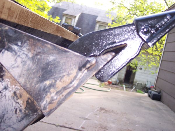

The toothbar is way tight for my bucket. Should I presume to beat it on with a 2lb hammer hitting the spikes? Looks like the bucket bottom is about 3/16 to thick for the little v's in the toothbar.

Hey thanks for the quick reply. No, it's a new ck30 with the factory bucket and is welded.
I've never seen a toothbar installed, but it looks like the v in the teeth is made for the tip of the bucket to fit snugly in it.
Am I wrong? should there be a gap of about 3/4" between the tip of the bucket sharp edge and the inside of the v in the toothbar?

Heck, a picture is worth a thousand... See attached.

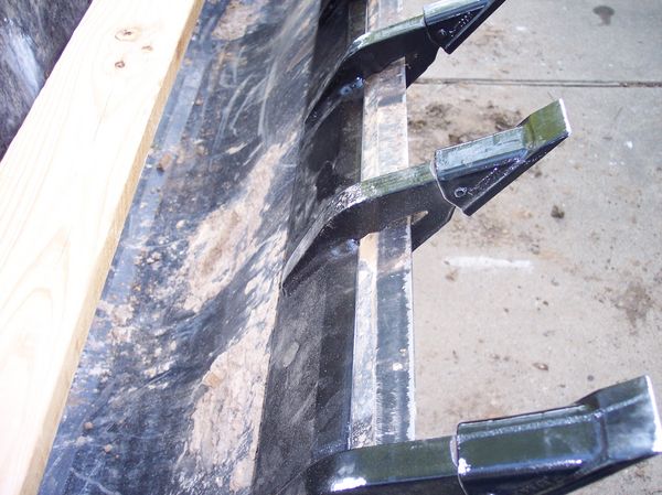

   / Installing Toothbar #15
another

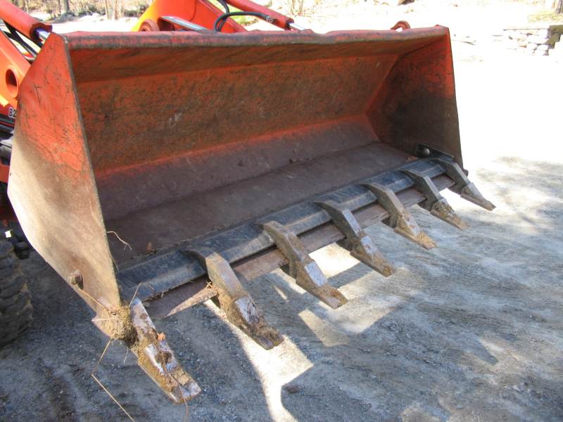

Mine is like that, it's not a problem. The tooth holder is designed so that it will fit several styles of cutting edge. It is also designed so that if your cutting edge is worn the holder will still fit tight. It's hard to see with all the dirt, but my cutting edge is worn and the tooth bar fits tight but there is a gap.

I think Mad is correct. Just get the tooth-bar seated as best that you can before installing the holding bolts. Digging forces will take care of the rest.
