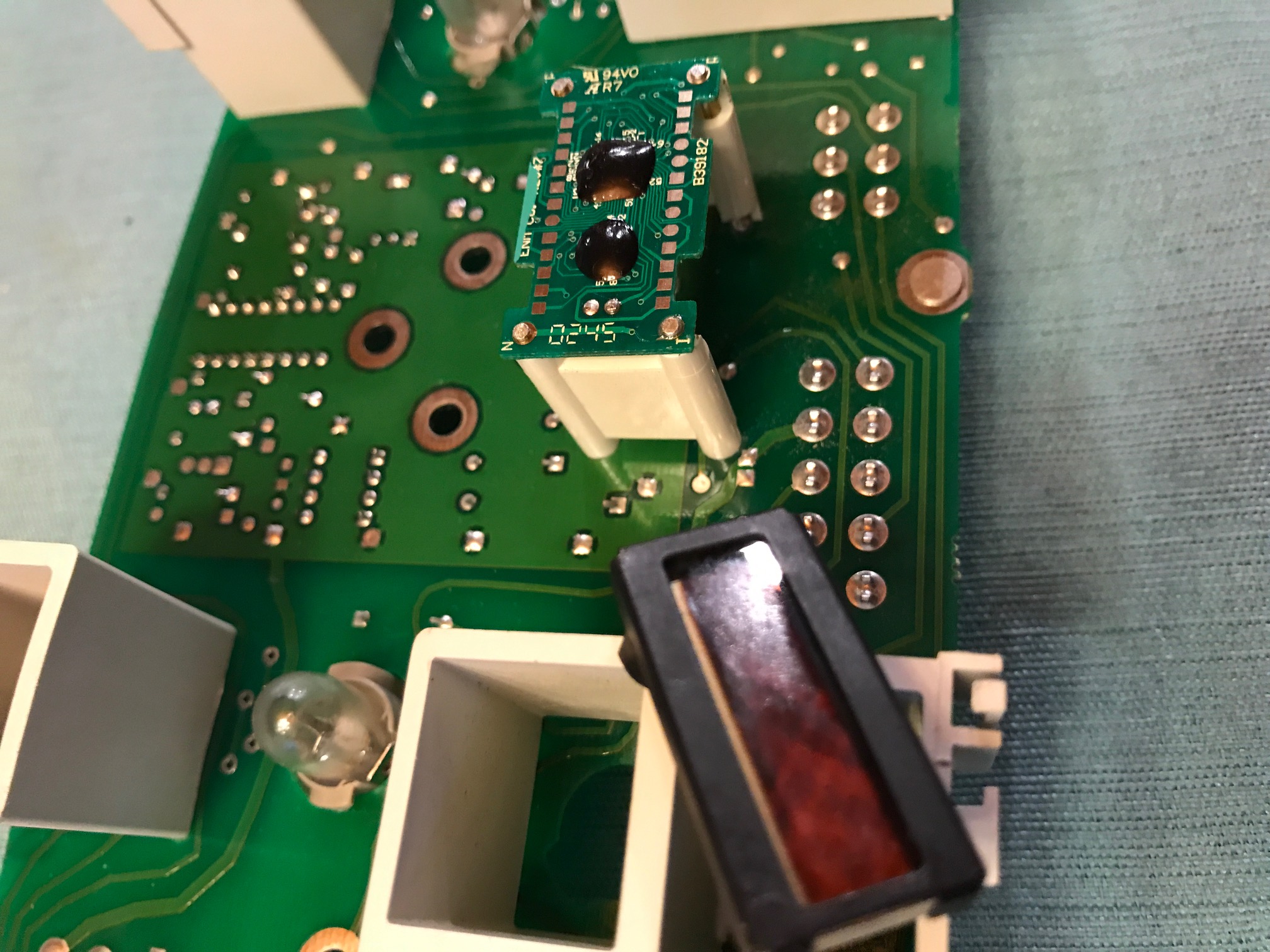

I keep hoping - this isn't backlit - it almost looks like it has an oil leak inside.

51510550714__63A47E3F-9856-43D4-9169-48C2F60F8B5A.JPG Here it is
/ Instrument cluster repair - Electronics tech #6
That LCD is toast. You could just add another "separate" meter. Google " lcd 12 volt hour meter " and you'll find plenty. Look under "images".

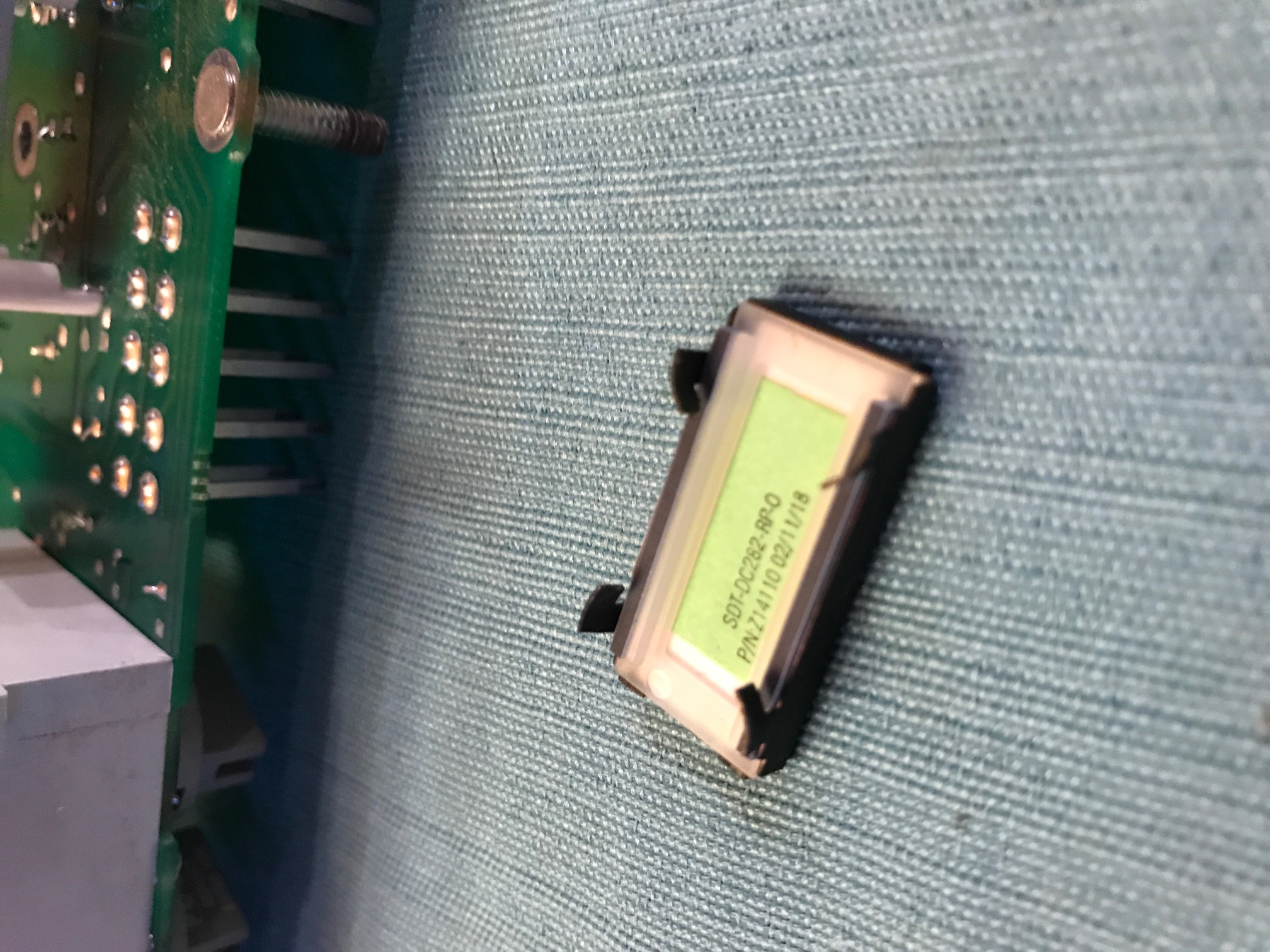

#9
OK, this is almost embarrassing how easily it can be repaired. The hour meter is an off the shelf componant that is used all ovr. The display is held on with tabs. No soldering at all.

Part number was plainly printed on the side. Quick Ducking found the unit and $18.95 has it on the way

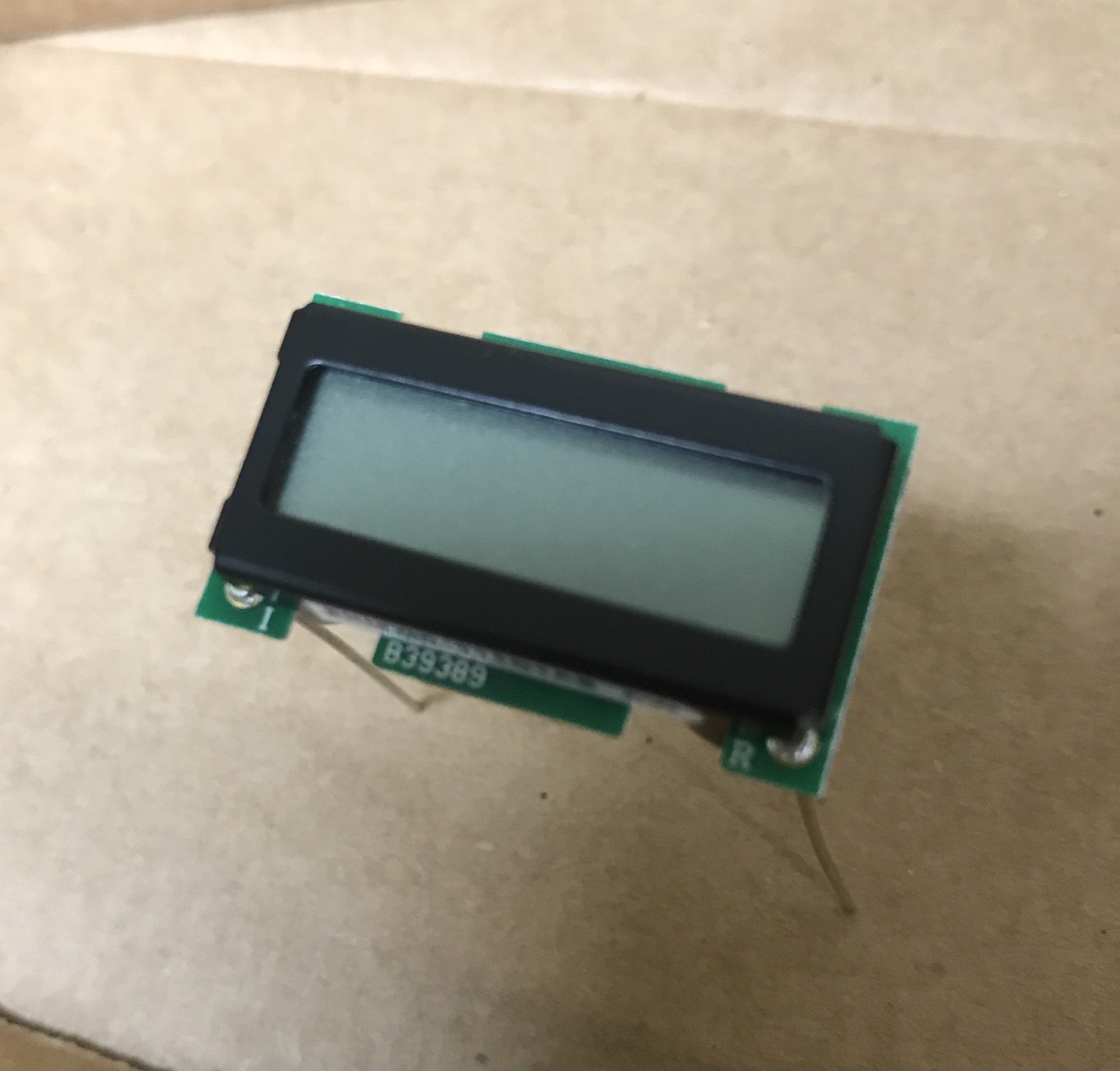

How the LCD should look Hope to install tonight.
#16
the Saga continues!
there are 12 years difference in the date codes on the hour meters. the new LCD's won't display correctly.

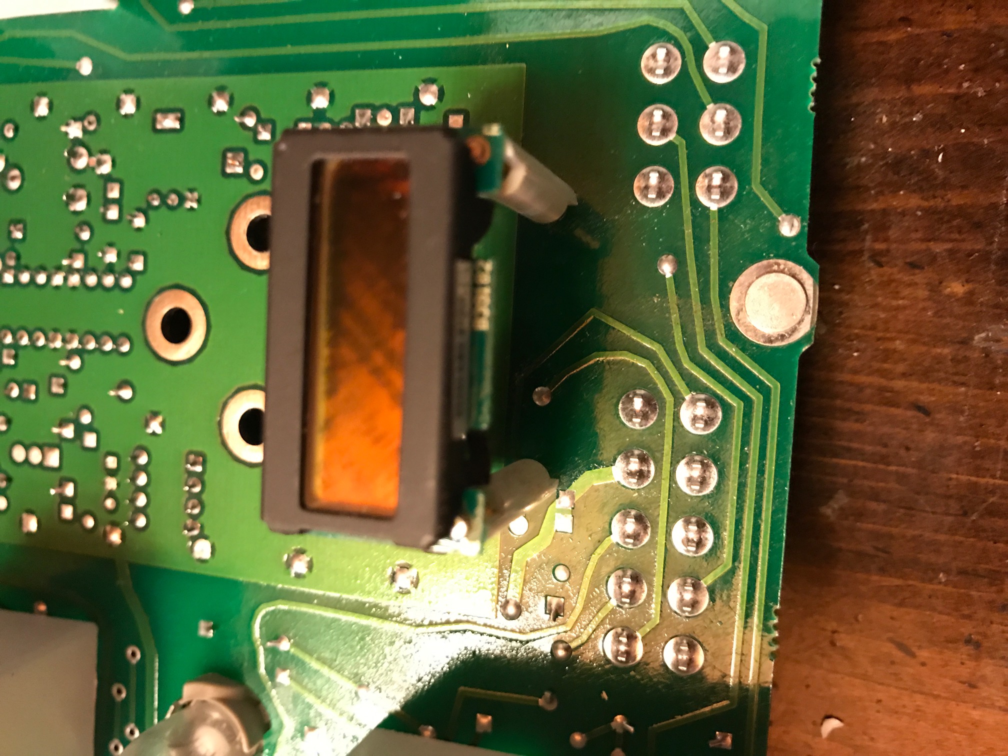

Help me understand what you've found out thus far. Does the LCD screen have a driver chip built right onto the back side of it? Or is that the controller board in your pic and it also tracks hours?
Does the new LCD display anything at all? For a college project years ago I had to reverse engineer a graphics LCD based on a Hitachi controller. I beat my head against the wall for several days until I figured out one of the voltage inputs needed to be driven negative to have sufficient contrast. Until then I was drawing characters and graphics just fine but couldn't actually see anything.
#20
the display appears to be passive and driven by the timer module to which it is sandwiched.
The new display set on the old board shows ' 1E 8.8 with no hourglass on the far left.
the characters are of course wrong. shouldn't be an 'E' - i have over 500 hours, and the last 2 '8's are even iffy.
