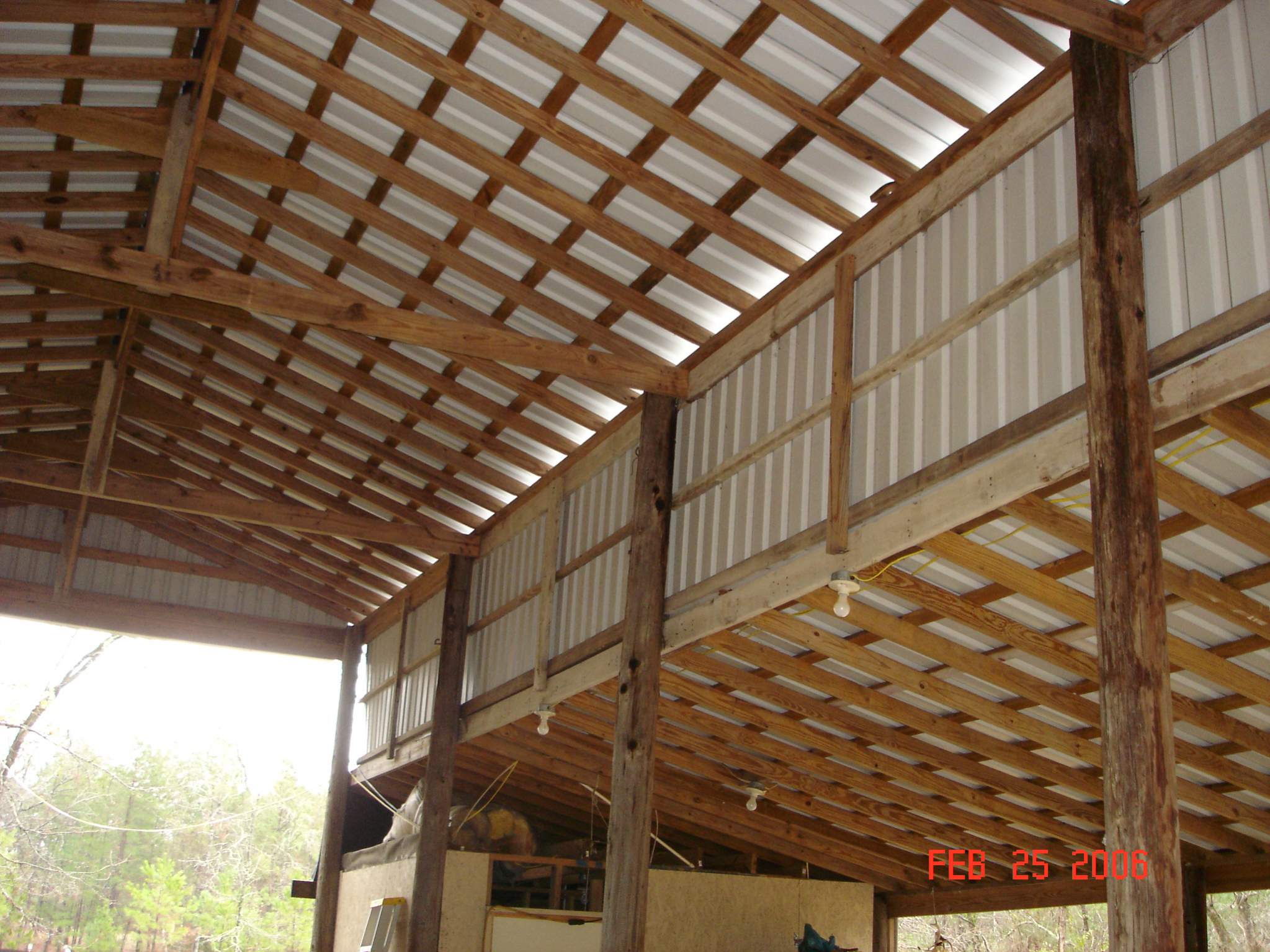

I know this is an old thread but I was hoping to get some help from the members who wrote posts to it.
I am in the process of converting half of my 40' x 40' pole barn in to living quarters. I will have to insulate the walls and ceiling inside the house portion. I thought about pulling the metal sheets off of the roof and installing the roll insulating on the batting and then reinstall the roof. Or should I just put insulation between the 2"x4" joists? Same with the walls. Should I install insulation or have it sprayed on? Thanks.

I would think that pulling all the metal off would be a bigger pain then spraying in some insulation. I spray foamed my basement and found it real easy to do. I bought my kit from foam it green .com.
   / Insulate/Upgrade Existing Pole Barn/Shop #44
Oh man. Don't pull the sheeting. You will have a major mess.
Use icynene spray foam
http://www.icynene.com/
It's a bit more expensive, but great stuff. Several you tube vids of the install process.
