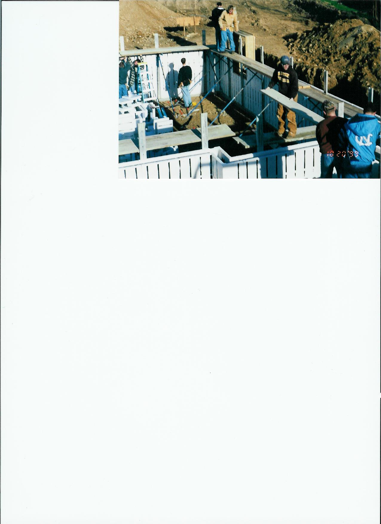

looks like the Arxx blocks alright! Did the students enjoy the experience?
One of the two builders we interviewed for our project attended the class that Arxx hosts. He said that he planned to offer the ICFs on any new jobs he did. Said that they were much more flexable than conventional stripable forms.

Yes, the students really liked them. They were way lighter than the forms we have set in the past and all we had to do after the poor was strip the scaffold. It was easier than some of our other pours because we used a pump to place the concrete. We could do that on other pours, but we can usually get the truck close enough and I have plenty of students to wheelbarrow if I can't. We will probably use this system again this spring when we start our next house. This fall we finish the last house we started.
