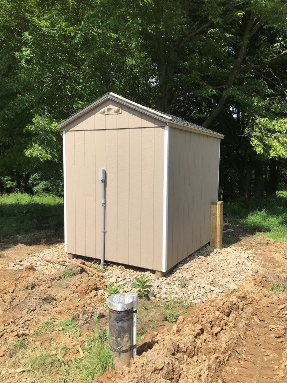

The pump won't last for ever. How will you pull the pump with a large heavy 6x8 shed covering it? My experience is that things seldom quit working when it's sunny and 70 degrees outside.
The shed will not be overtop of the well, but next to it.

How is the water pipe from the pump getting into the shed? What is the depth of your frost during the winter? You'll need to insulate the pipe as it passes through the part of the ground that freezes, and passes through the air up into your shed. - Heated buildings that are over the pipe as it travels up can frequently prevent the ground from freezing in that spot, the pipe as well.) That is harder for you as the shed is small, even if heated and to the side.
I'd dig out the pipe to below the frost level and insulate it with thick pipe foam (look up how much you need - thickness to prevent freezing) up to the entrance into the shed and above. Then you just have to keep your shed heated.

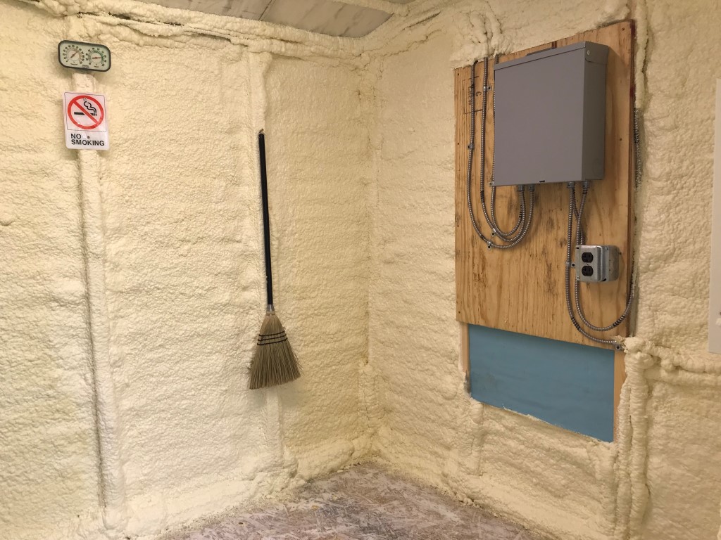

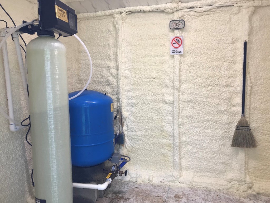

I wanted to provide an update on this project. We used two of the DIY spray foam kits on the walls. 1.25" foil-faced insulation on the ceiling, 2" pink foam board on the floor, covered by 1/2" OSB. There is a wall-mounted electric heater on the wall. The water line from the well and to the farm hydrants exit the wall and enter a 2x PT box that extends into the ground. Those lines are wrapped in heat tape to below the frost line. Here are some photos of the finished product:
