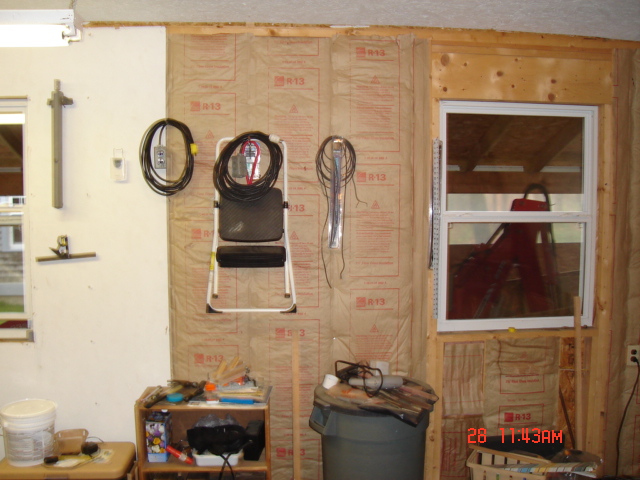

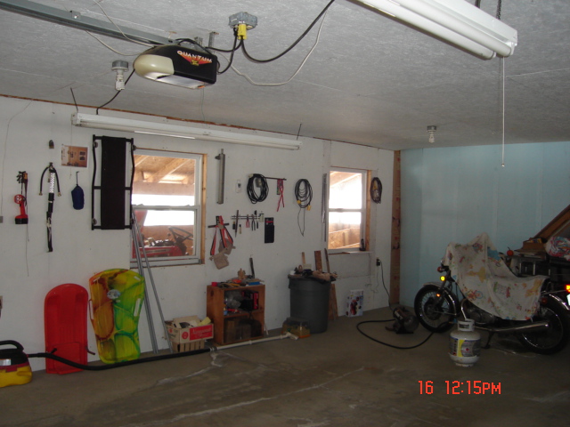

My garage was standard 2 x 4 stud construction, but I did much the same... inexpensive 7/16" OSB on walls & ceiling, after adding batts of insulation. One thing I did which really helped was to paint surface of OSB white before hanging stuff on it-- makes lighting much more effective.
George2615- is that a '55 or '56? Used to drive one of those old tanks just like that-- even the same color! The Olds I used was a '55. "Rocket" V8!
  • Garage interior 2:09.JPG
  • Garage wall 10:28:08.JPG
