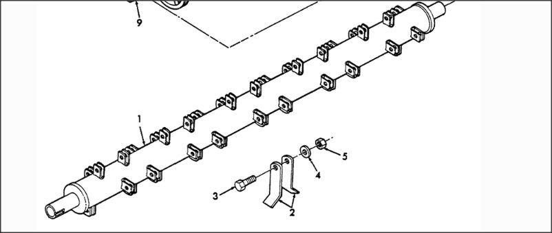

Mine is a 917L which means the flail is bolted directly to a lug in the rotor i.e. no loop or "hanger" or whatever they are called.
917 may or may not be the same design?
917 is different with a bar with mounting holes in it welded to the rotor. Flail knives hang on a D-ring & bracket to hold that to the bar.IMG_20150529_181633-1.jpg
