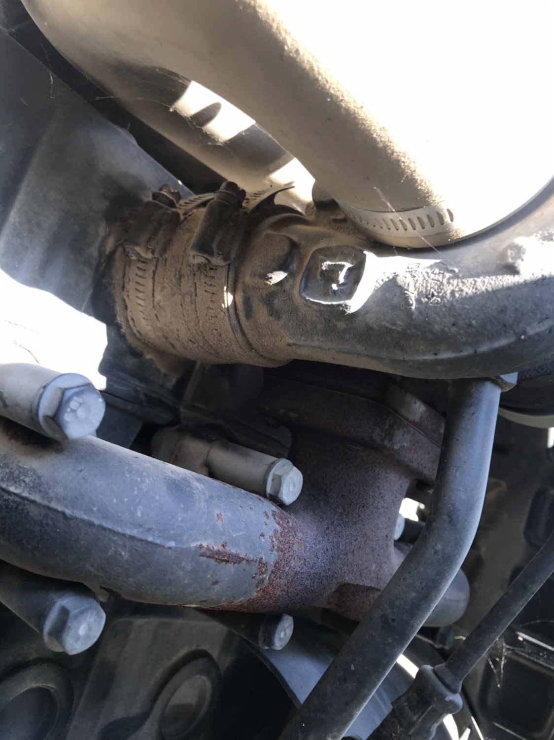

Anyone added an intercooler to their 4120-4720?

My 4120 doesn’t and there’s not a lot of room between the turbo cold discharge and intake manifold. Like maybe 1.5” at the most. IMG_9695.jpg there’s about 3/4” in between the hose clamps.

See if the 4720 has a different turbo bracket. Both the 4720 and the 4120 have the same block and the same chassis, so if you want to buy a few parts, you can for sure make it happen.
It could easily be 2-3K for the parts though. What do you hope to accomplish? I would be surprised if you gained 5 hp.

As hot as the intake temps are I would have thought it would be more hp. Though I might add the debris getting stuck in between the cooler and the radiator might be a hassle. I just have to blow the radiator out now. The screen catches most of it. Not worth 2k. But I would like to think that the longevity would be better?

I just checked...The intercooler is $570.00 so you could probably get all the parts for $1200 or so.
The early 4520 had 5 more hp than the 4320 (before the 4520 got an electronic controlled engine). The 4520 has an intercooler and the 4320 does not.
I don’t know how much the intercooler will contribute to overall longevity. Maybe some of the diesel experts could quantify that.
