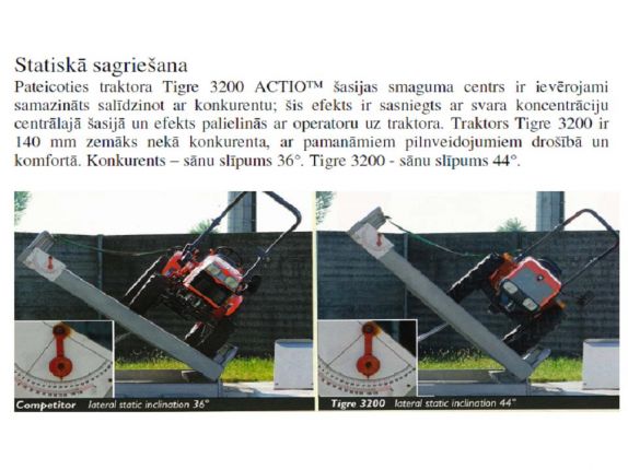

Another machine that you may want to have a look at is the antonio carraro. IO have had the ttr440 for some time now and can use it on a 45 with major pukker factor. I comenly use it in the 35 range very comfortably. I just have the turfs on it . loaded in the rears.

I think all of us that looked at a slope tractor drooled over the AC. Problem was the price point was completely unacceptable except to those who were running orchards and vineyards.
Beautiful tractor and bless you if you can afford one ;-)
