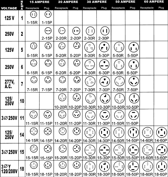

Thanks for the replies and suggestions. It looks as though a 120V welder is a waste of money and that I should focus on 240V. Should I install a 30A or 40A outlet in my garage? I know it would depend on the unit, but am likely to opt for the unit Shield Arc suggested, or an equivalent mig.
Wrong. A 120v machine would do what you said you wanted in the original post. 3/8" is the limit but if that's all you need there is no reason to go higher. I have a portable dual voltage machine and do 90% of my welding using 110 because it is easier to find a 110 source than a 220v plug with the correct receptacle. If you plan to do all your welding in one place and you already have a 50amp 220 source there then by all means get a 220v welder. For the average home welder though a 110v machine is a decent place to start. Less money to buy, no need to run 220, less weight/size and easy to sell if you want to upgrade.

I've had a Miller Thunderbolt AC/DC stick welder for decades. They are old school and heavy but reliable and cheap. Around here they are on Craigslist all the time for $200 - $250 and can probably be bought for less. Good way to get started without using much money. As someone else pointed out, you will want a lot of clamps and jigs, good set up will save a lot of frustration.
Both my welders (Thunderbolt stick and Miller 211 MIG) use a NEMA 6-50P connector. 50 amps. See chart.
