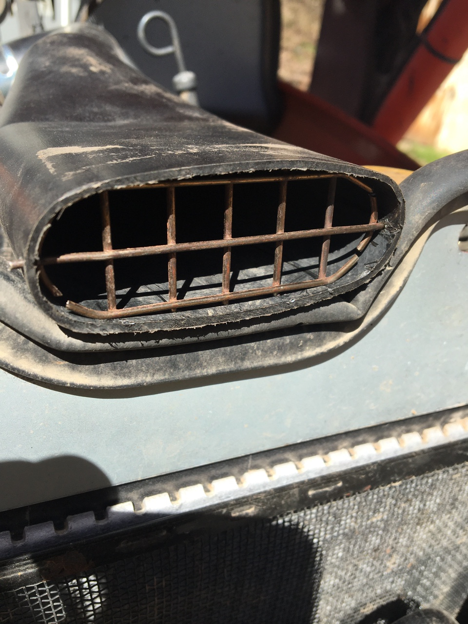

I put ¼" hardware cloth screen over my intake to the air filter before parking my tractor outdoors overnight for the first time. I already had a mouse chew my truck wiring harness.

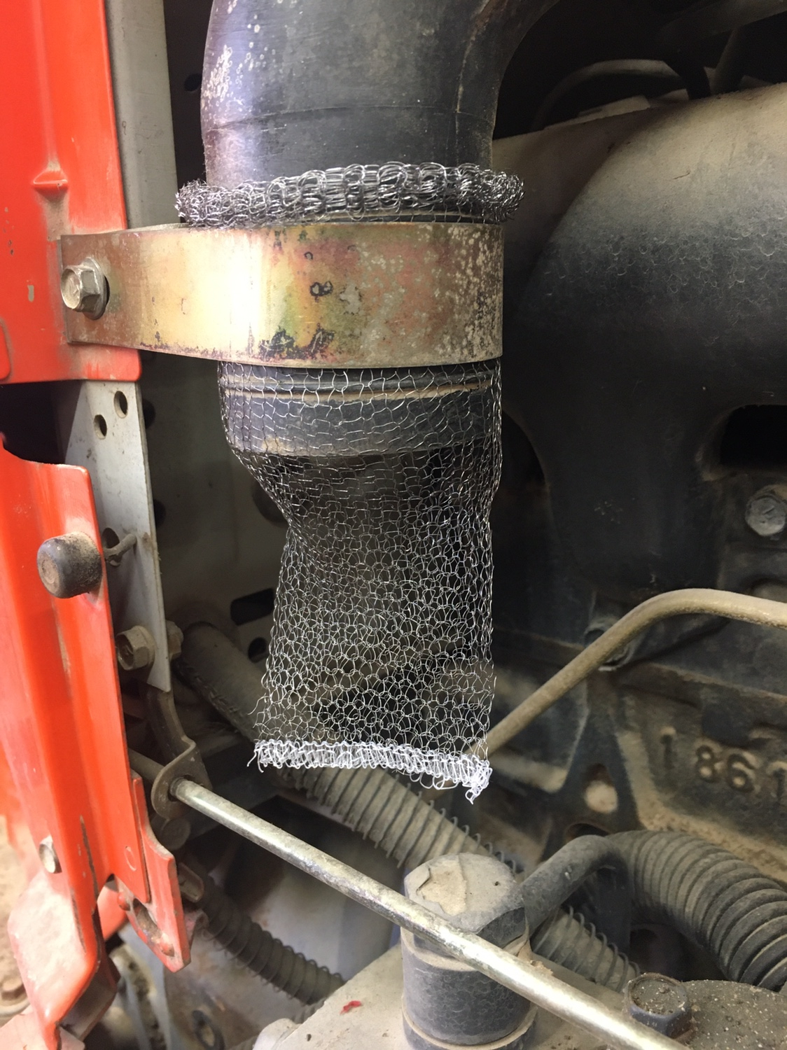

I use these to try and keep mice at bay from my intake.
