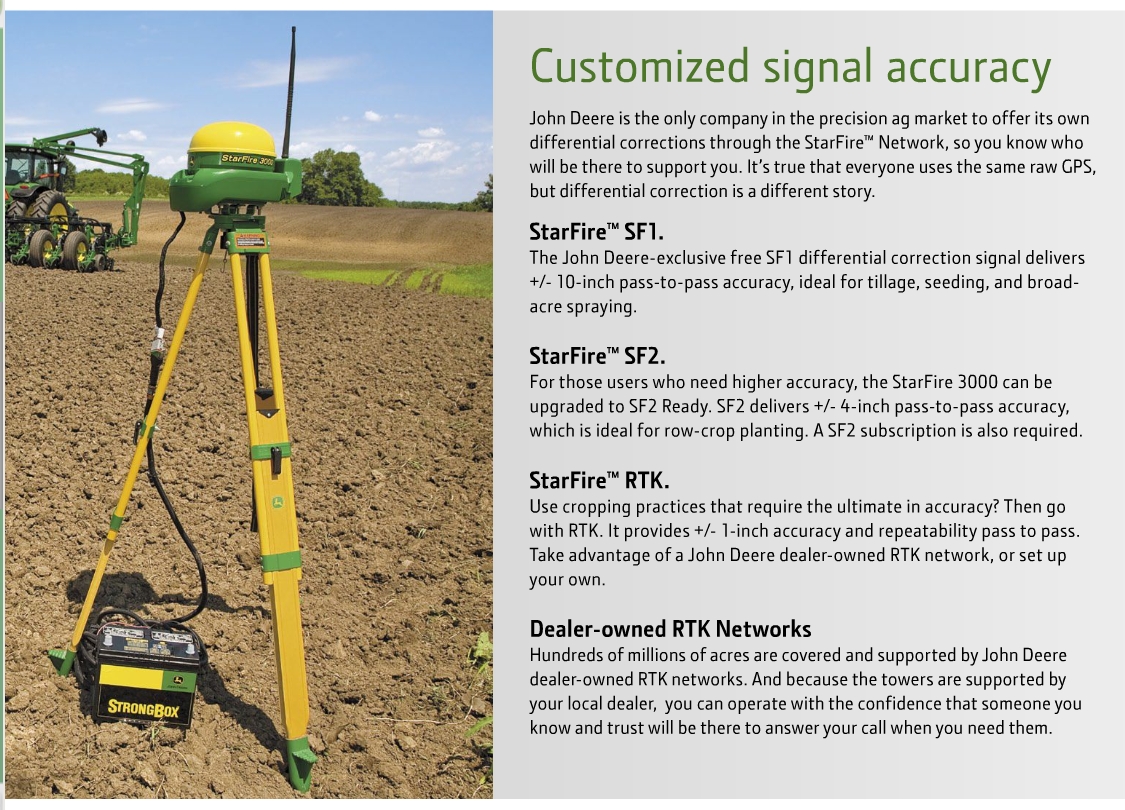

Accuracy is a function of how much you want to pay. Yes, the best accuracy requires a base unit set up in the field to provide error corrections.

They're not oulandishly expensive though, are they??? Couple grand gets you into it, no??

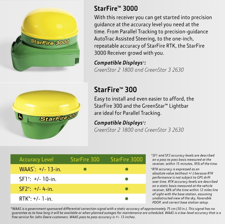

Don't know what the cost is, but a local dealer has set up base stations on towers to cover six million acres with the maximum RTK accuracy. Saves costs and setup of doing that part yourself.

Not sure which "it" you're referencing. I recall a number of $26,000 coming up in a conversation, but then not sure what that all referred to either. I believe there is hardware, software and subscription / activation pricing that comes together to form the total package of whatever one is trying to accomplish.
Here's a link to some of the components with some pricing

IIRC they are more accurate than a foot. A foot wouldn't work worth a darn for planting. I believe it is a inch or so.

Accuracy with RTK is one inch. See charts in my previous posts.
