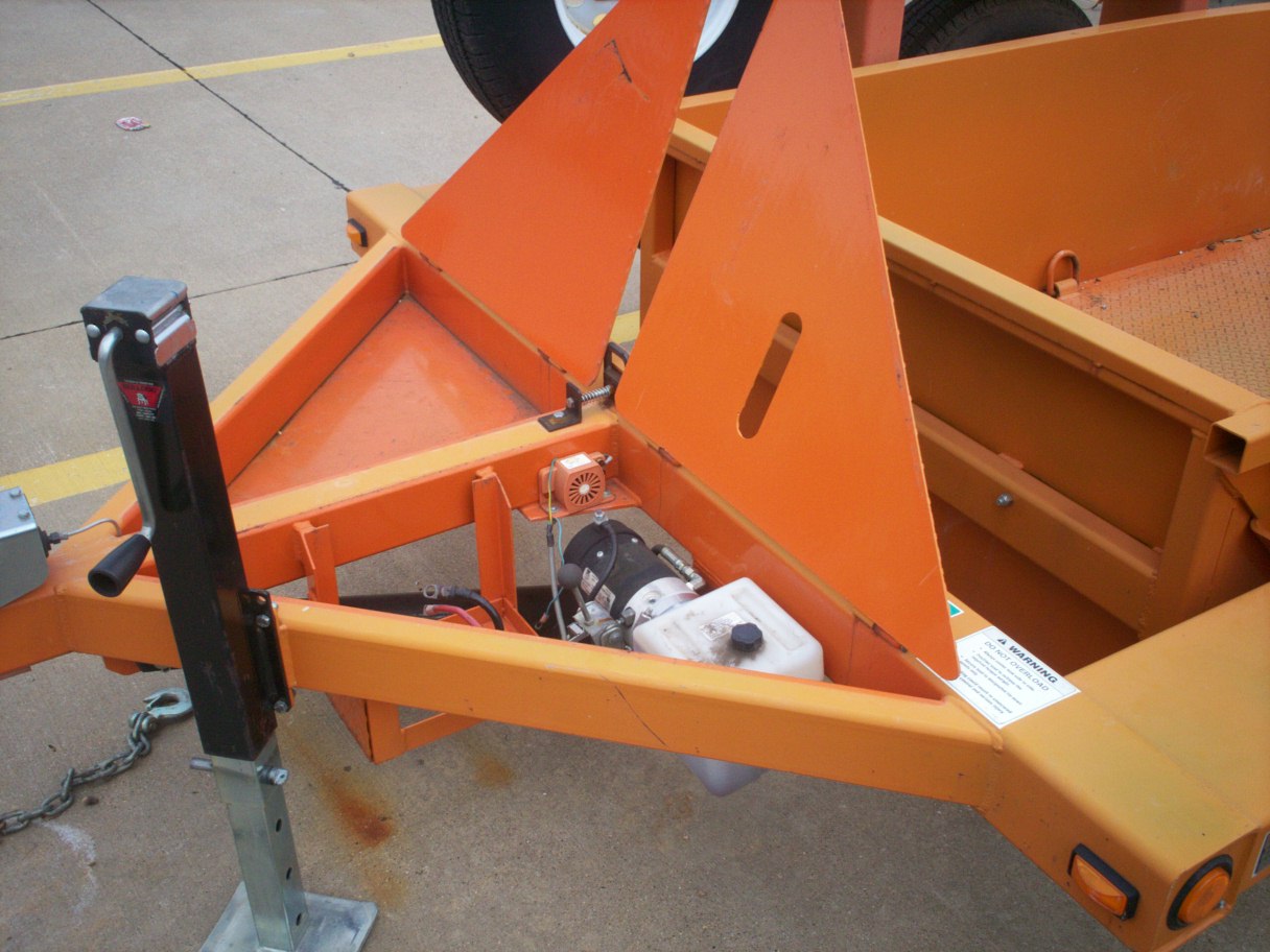

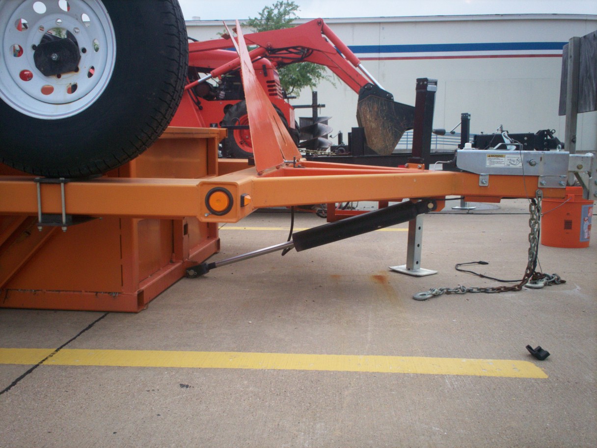

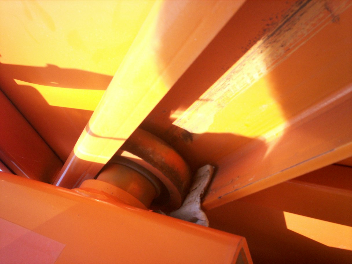

Saw this today at Home Depot. Unique design, but don't know how much weight it will carry. It appeared to be for hauling a small trencher rental unit, or maybe a small manlift.

   / Interesting "lowering" trailer @ HD.. #2
They work great for small pavement rollers.

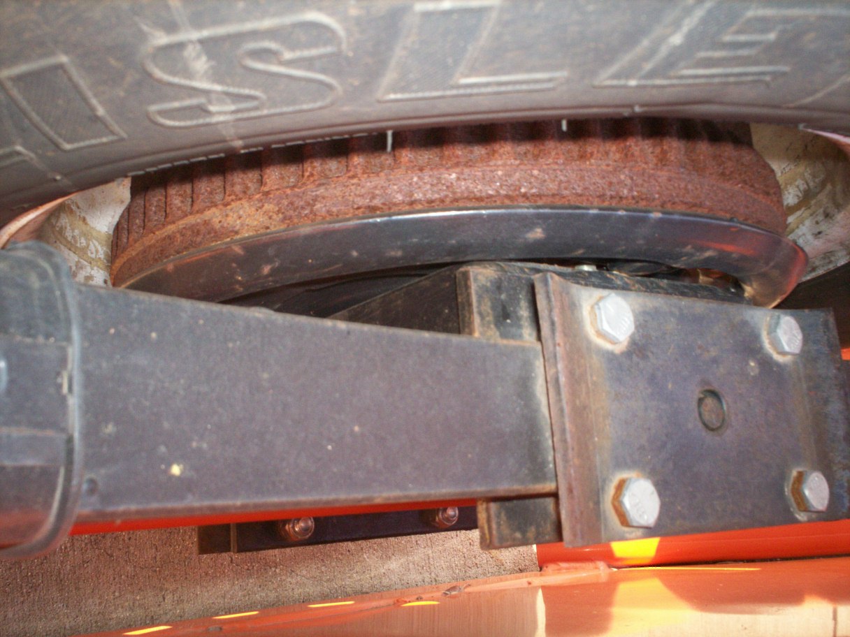

   / Interesting "lowering" trailer @ HD.. #3
8 lug wheels indicate at least a 5K axle. Could be more.
   / Interesting "lowering" trailer @ HD.. #4
I believe they're known as "hydraulic trailers". Also very useful for shop machine moving.
   / Interesting "lowering" trailer @ HD.. #5
as its a stub axle design (not solid) i highly dought a 5K rateing
   / Interesting "lowering" trailer @ HD.. #6
According to Triple L trailers, the UT49 in the picture is rated for 4500 capacity.

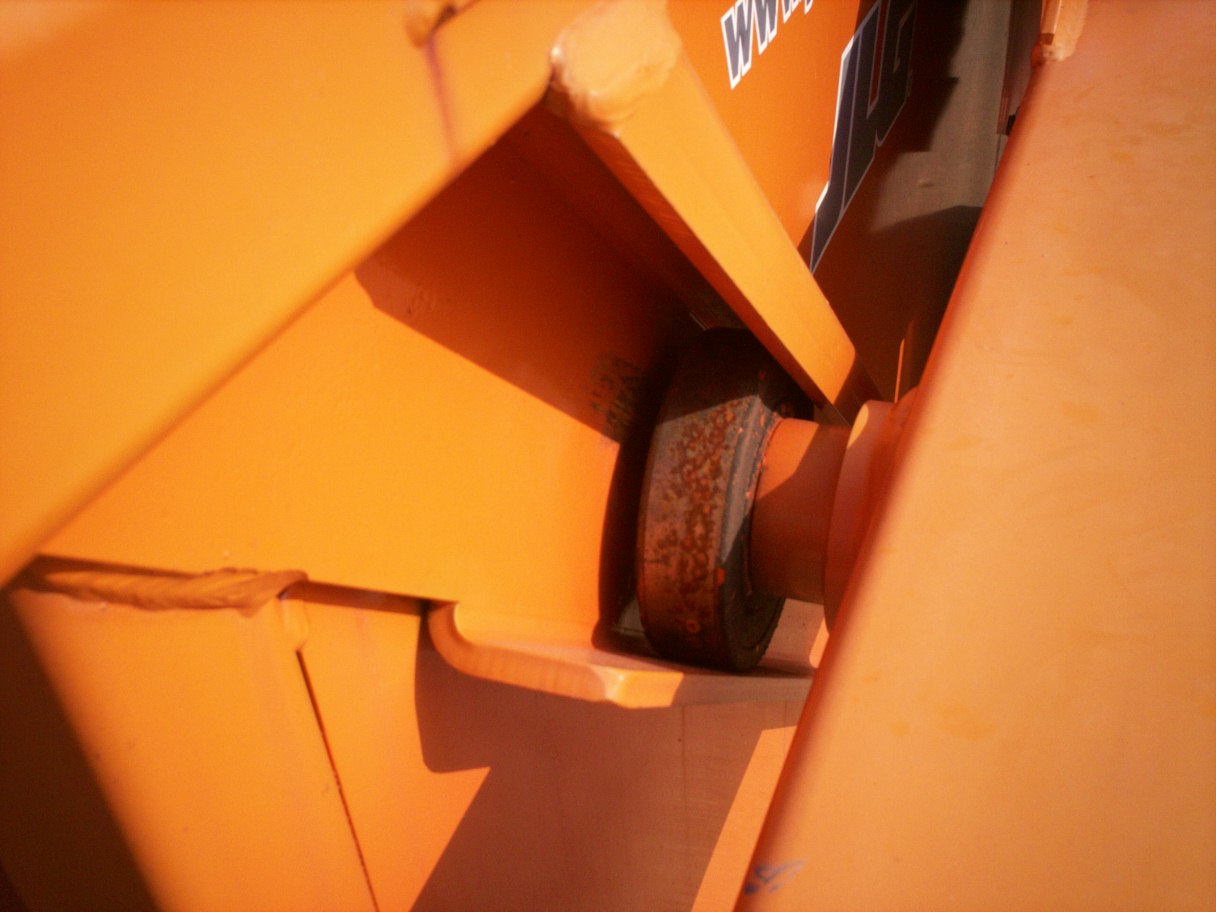

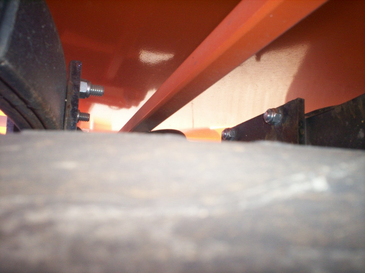

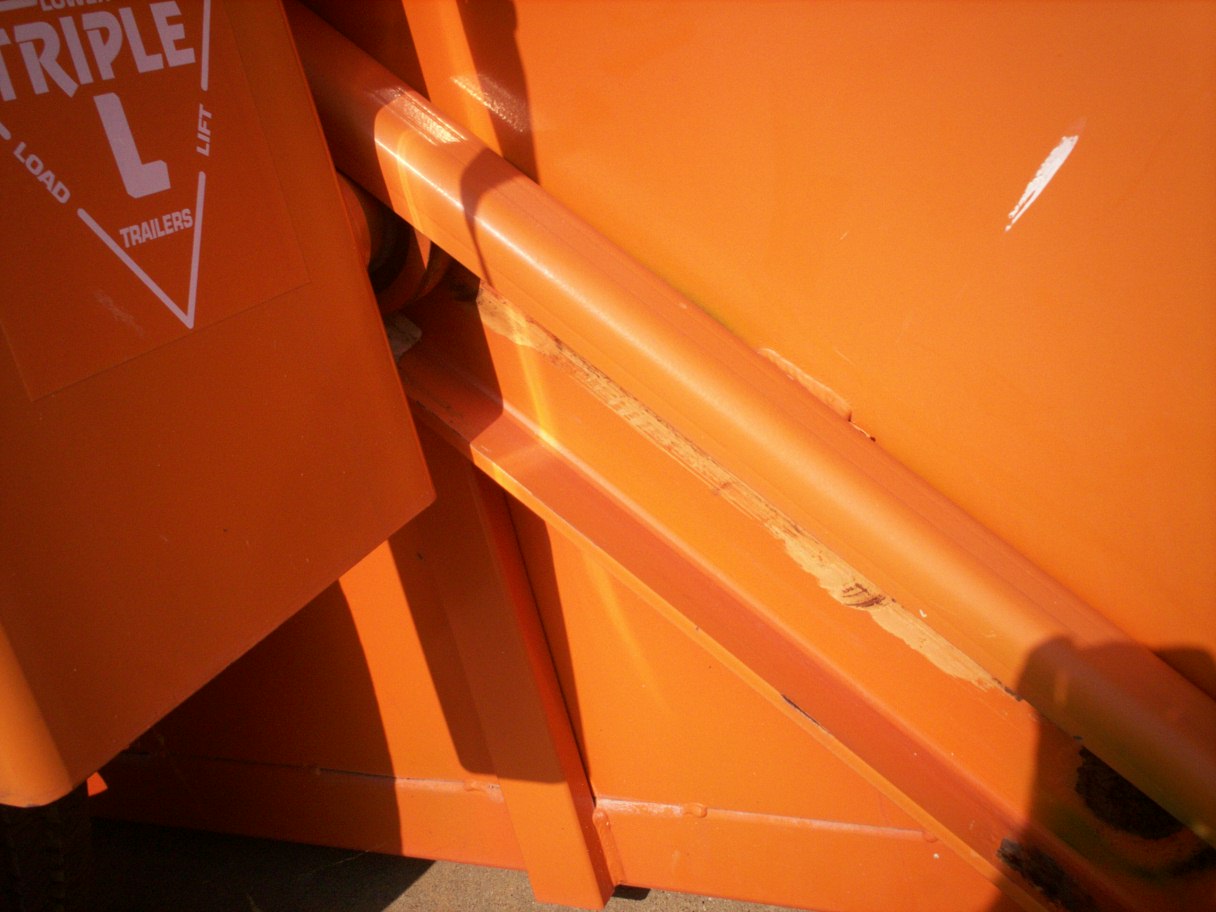

Does anybody know what the channel slides on, is there a wheel or bushing? also is the load held only off the ground by the hydraulics, or is there a lock?
BTDT, if you happen to see it again at home depot, could you take an additional pic of the channels, and the piece on the wheel side that it slides on ?

   / Interesting "lowering" trailer @ HD.. #8
the local HD i visit has one, ill try to remember to snap some more pics the next time im there.
   / Interesting "lowering" trailer @ HD.. #10
Does anyone have a link to an axle stub like this unit uses? Most I've seen seem to stick out farther from the trailer bed.
thanks,
Rob
