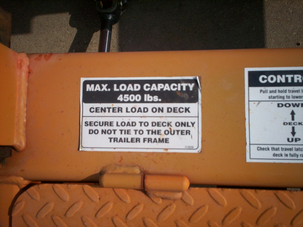

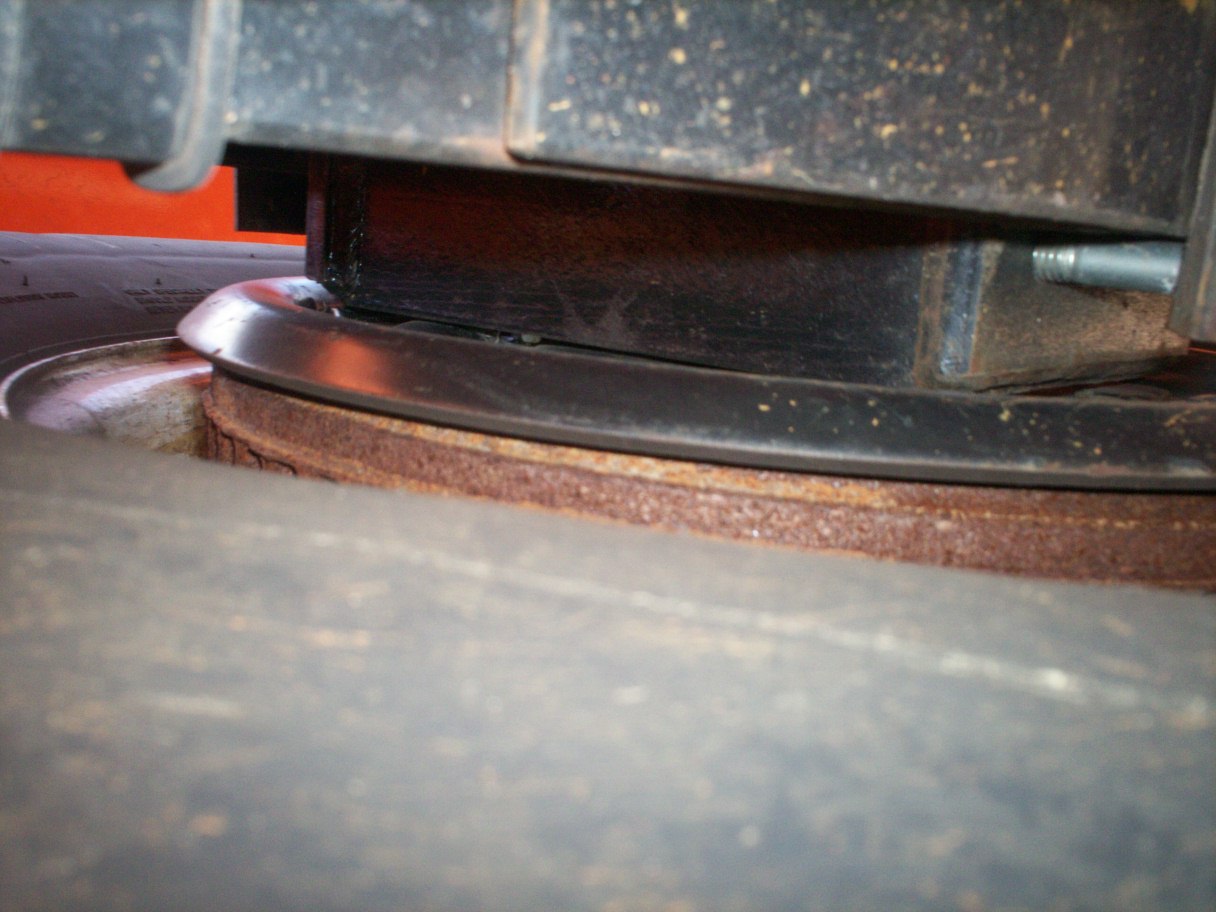

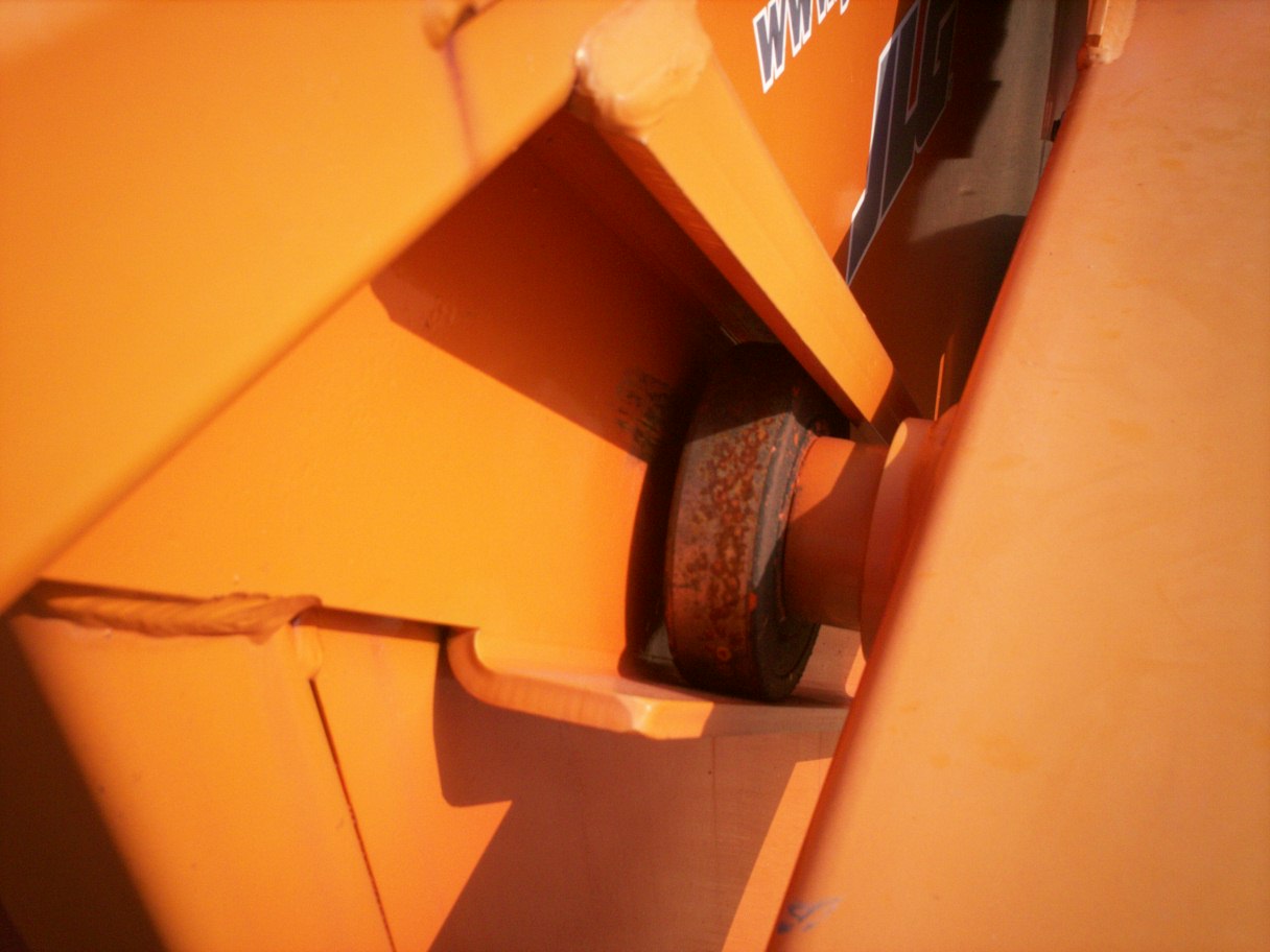

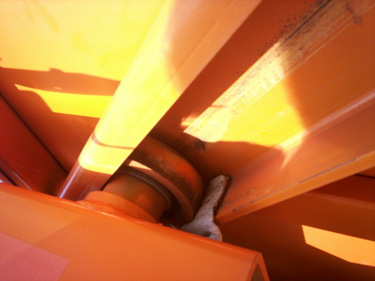

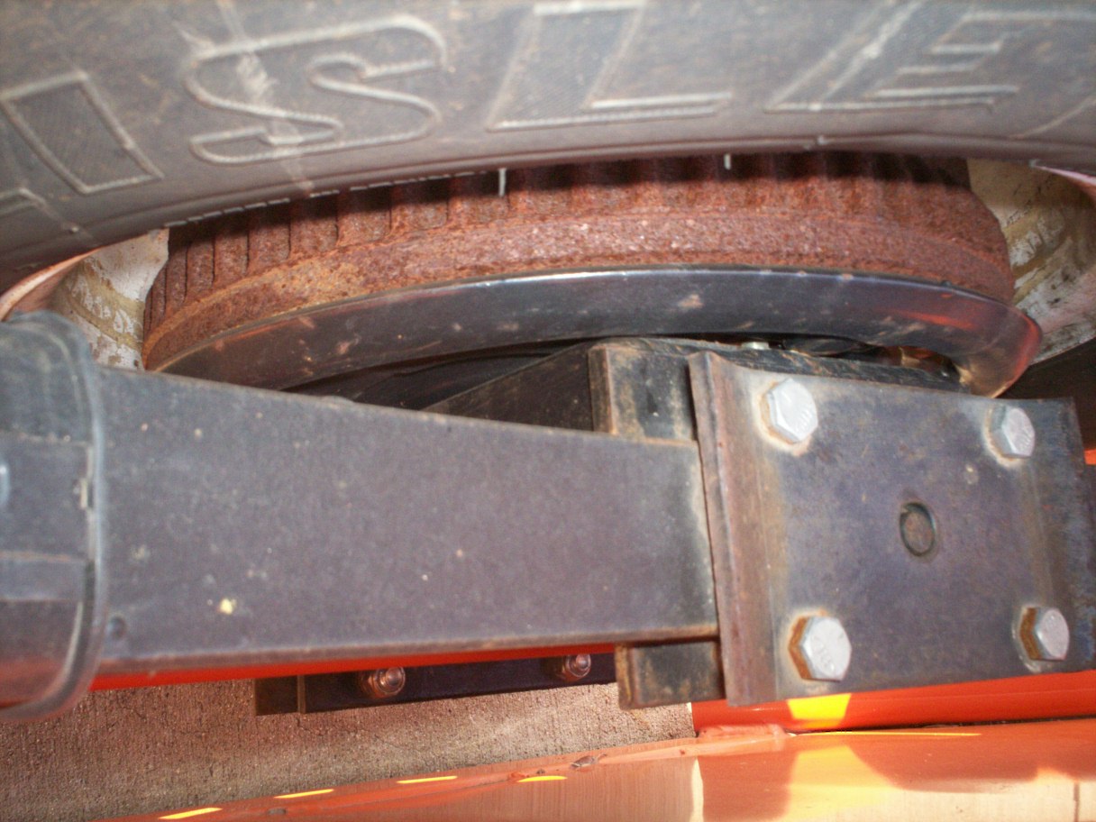

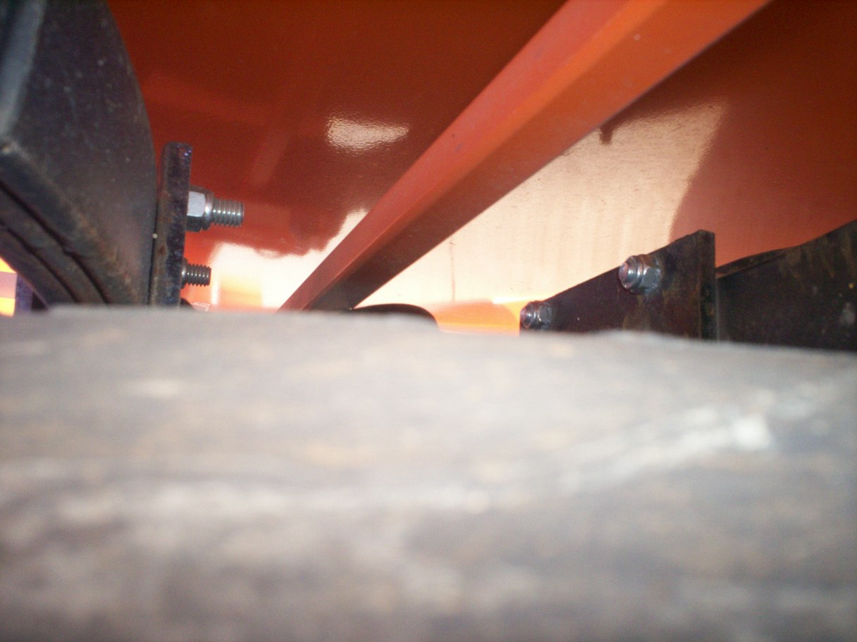

project_X said:
Does anybody know what the channel slides on, is there a wheel or bushing? also is the load held only off the ground by the hydraulics, or is there a lock?
BTDT, if you happen to see it again at home depot, could you take an additional pic of the channels, and the piece on the wheel side that it slides on ?
Cheers,
Rob
Here are a few additional pics. Pretty tight quarters where the tire fits, couldn't get a good shot of axle setup, it's just bolted between a couple sets of springs. The rollers look like large sealed bearings on a stub shaft.
