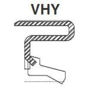

The top bearing still doesn稚 get any grease in it. If you pumped the cavity full of grease to actually push grease in the top bearing then you?*e going to push the seals out. I think quality sealed bearings are the better way...............................
Maybe so in most homeowner mowers, however in a commercial mower like (Kubota F3060 for example), the deck spindle upper seal is "VHY dust seal, no spring" and will be installed lip pointing up.
I.E. it will let out old grease as needed.

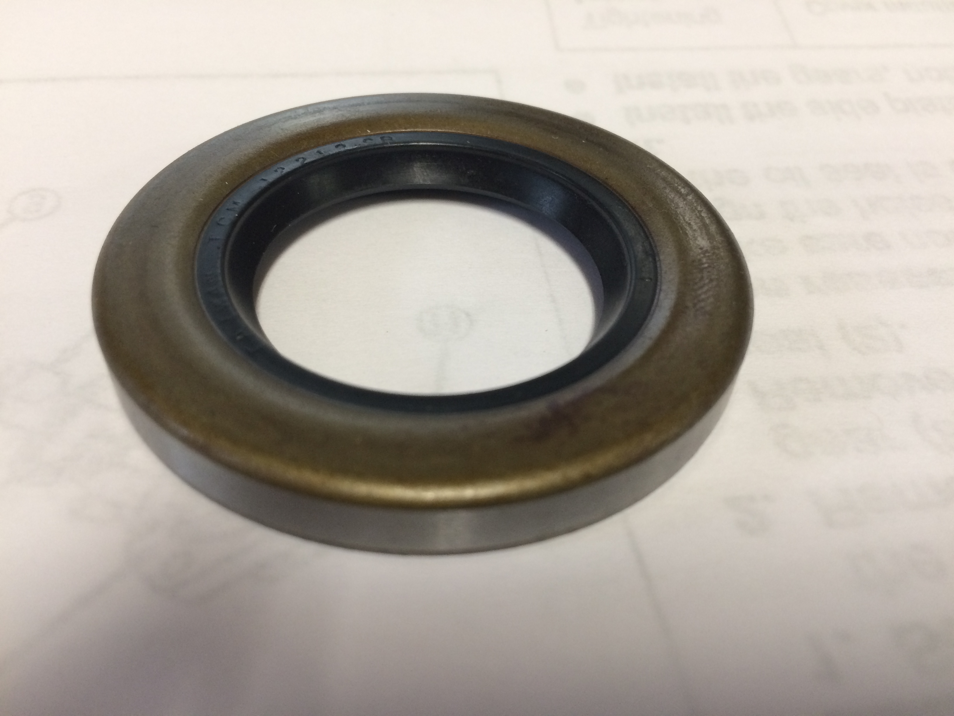

The lower seal is a SB type (with spring), and will be installed lip pointing up.

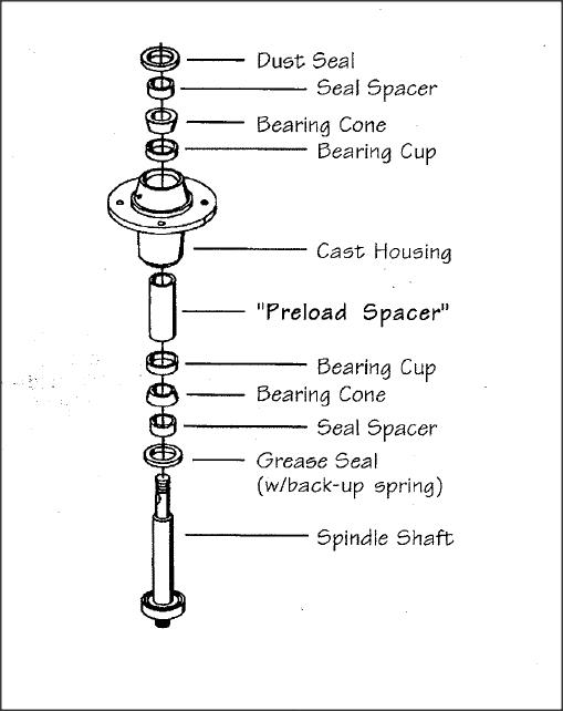

The grease fitting is at the top end of the spindle shaft.
View attachment F3060 Blade spindle parts.pdf
PS. These roller bearings are the same size & type as a very common boat trailer wheel bearings are!

I pulled a spindle from the x744 62c deck and the bearings had no seals. Instead, the separate seals were mounted outboard of the bearings and they rode on a bushing. Bearings top to bottom were well lubed and looked like they should last for a long time. (similar to the above ^ drawing) The deck on the CC 982 has tapered roller bearings and will outlast me.
