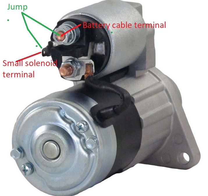

Any time I hear "Starter Spins but does not engage," I am inclined to think the wrong terminals are being jumped.
This is a common occurrence by those who are not using this technique all the time..
Study attached marked up photo and try again.
Dave M7040

If the OP is boosting with an external charger and properly jumping the starter (I use a remote starter tool that has an LED that lights up when properly connected) and just the starter spins without the bendix kicking,
Then the OP either has a weak Bendix, or weak starter. In either case, Kioti will sell the whole starter unless the OP has a rebuilder around the corner.
