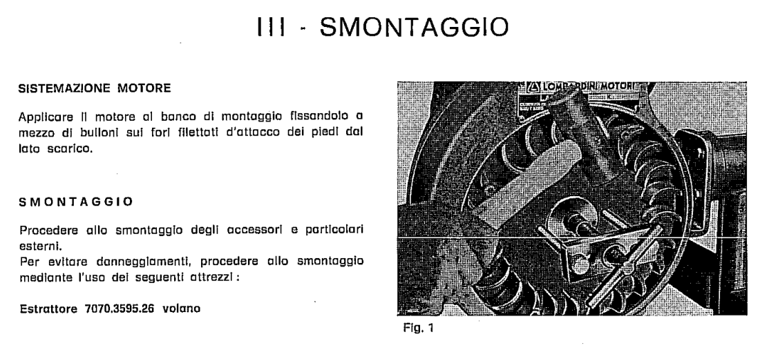

No, it isn't like B&S (granted, that I've never dealt with the ignition on those, only at most cleaning the carburettors). For setting the distance from the coil to the flywheel, the repair manual (in Italian) says to use a piece of card stock 0.5-0.6mm thick.

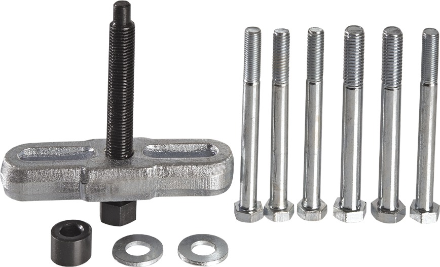

Now pulling the flywheel is another thing. It has two holes for 10mm screws to lock in the special tool I don't have. I put some hex-head screws in them, and tried using an ordinary pulley-puller with the legs gripping under the screw heads, but not much luck. Seems I need to fashion a puller like what they have.
   / Intermotor/Lombardini 12HP gasoline motor flame out the exhaust?
#16
Or, even better, is just order a puller... 12€...
I don't have thick enough pieces of metal to rig something up-- tried with some square tubing, and it just bent! Now more waiting...
