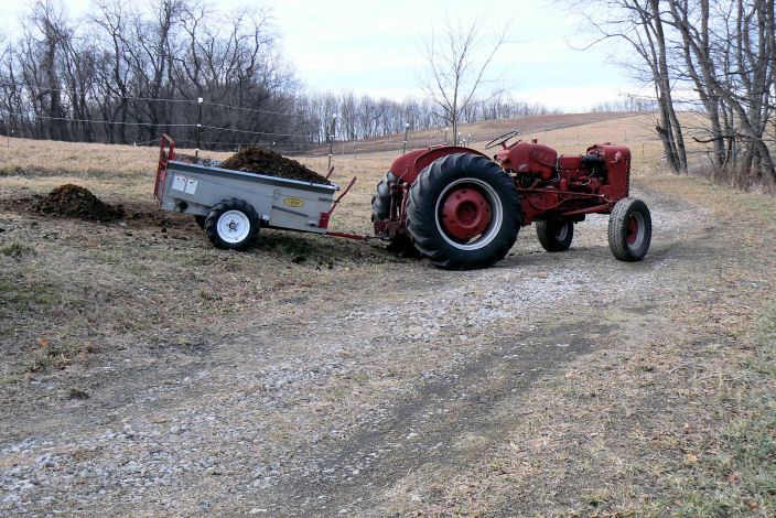

New Years Day was cold and sunny with hard frozen ground...perfect for spreading manure. I've been tinkering with the 300U for a while and it was wanting something to do. I'm used to a hydrostat, power steering and half the size, but nothing broke and nobody got hurt, so I'll call it a good day.

I grew up around an IH 300 Utility. Neat old tractor. We used a 3 pth wood splitter on it for years. It flailed the front tires (power steering box destroyed) so my father sold it for parts.

I can see a way to make it steer a lot easier! Put some new triple ribs on the front and you will find it will steer a lot easier!!! Great old tractors, but your going to need a bit larger spreader to make it work at all!
   / International 300 Utility gets a job
My wife bought the spreader to use behind a Kubota BX2200, which makes a pretty good match. The 300 will get used with a rotary cutter when I get a beat up, used one, welded up with a new deck.
My next thing to buy is tires and tubes for the front. The truck tires on it now have no side hill traction and the sidewall is too soft and flexible for steering.
The BX is good for that size spreader! For a bush hog you should be at least 6' wide or a twin spindle 7' for the tractor. Good luck!
