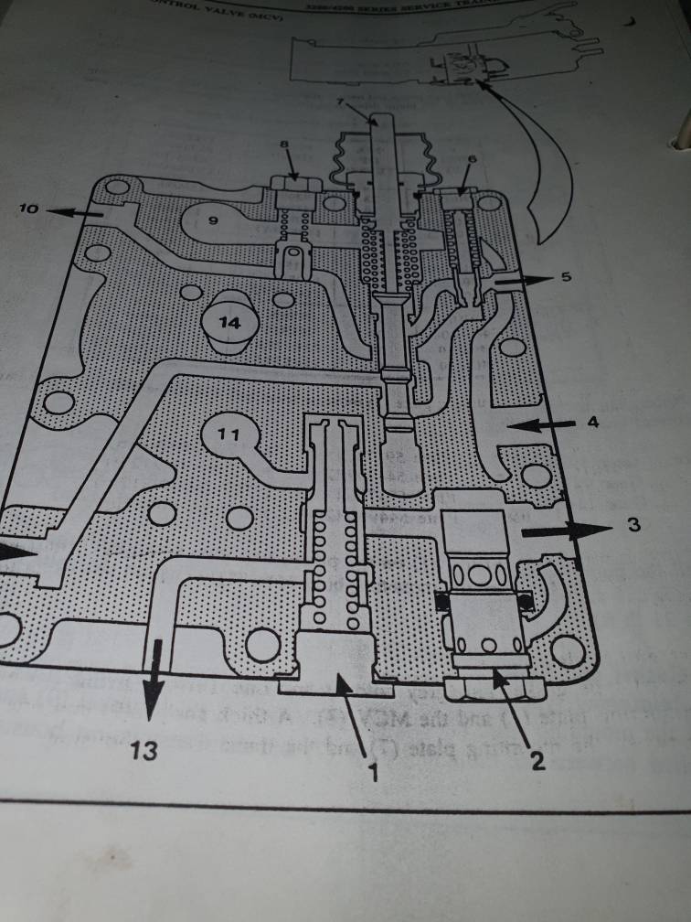

International 574 broke the shaft of the hydraulic pump !!
Hello friends, I ask you for help, my 574 cut the gear shaft inside the hydraulic pump, the pump is new, I am worried about putting a new pump back and it will break again ... Has this happened to you? pump problem or hydraulic circuit problem? Thank you!!

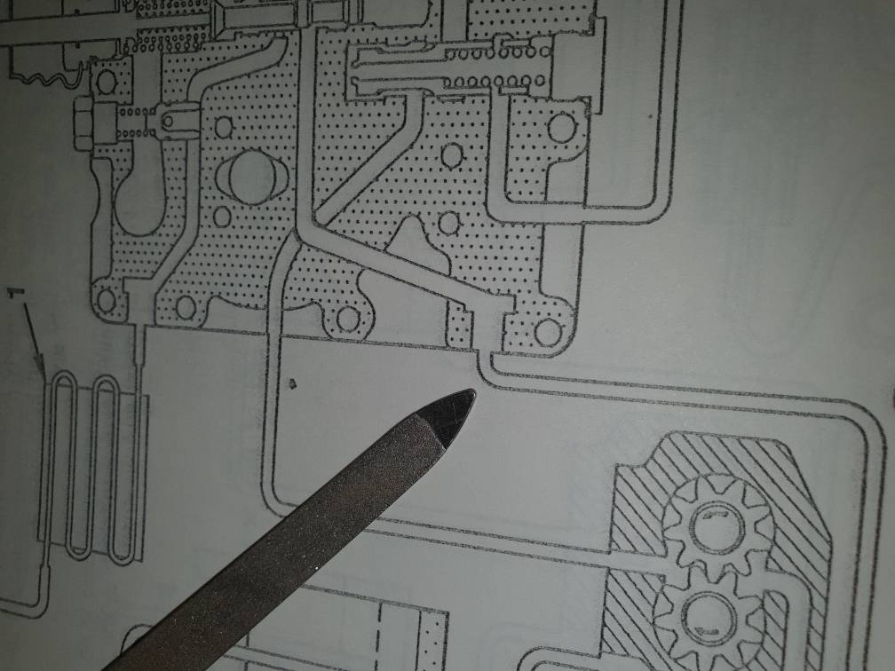

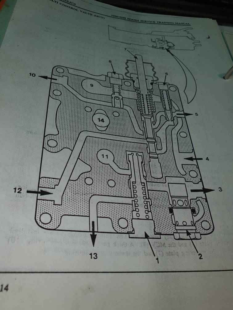

Does the hydraulic system of these tractors have a main relief valve?
   / International 574 broke the hydraulic pump shaft #4
   / International 574 broke the hydraulic pump shaft #6
Sorry ! No 13 go to steering and no 1 is priority valve for steering20200604_123159.jpeg
   / International 574 broke the hydraulic pump shaft #7
If you look under the MCV you will see no 2 can be removed witk a socket and no 1 with a allen wrench
   / International 574 broke the hydraulic pump shaft #8

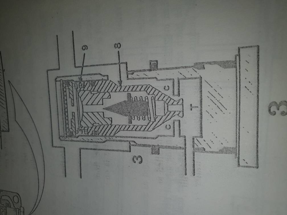

As i have said relief valve is no 2 and its pilot operated . Meaning it will lift your implement plus say 6 lbs.
There is another valve that will release at a max pressure and that is located infront of your MCV( multipile controle valve) . Thats that valve block where the hydraulic filter is. Next to the fitting with the pipe on it.Image%20(3).jpeg
