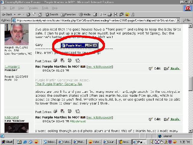

OK guys I have an issue with IE6 that just popped up and I don't know how to "fix it". Whenever I click a link to another website, the new page opens minimized. See attached screen shot. I know it's easy enough to just click the box and open it, but it used to open full size, no more.
Where can I find the fix for this? I've been all over IE help and Microsoft's support pages.

   / Internet Explorer Guru's HELP!!! #2
Re: Internet Explorer Guru\'s HELP!!!
Did you install any new programs lately or how about a virus. A virus can do funny things like that also. Update your virus program. Does it do that when you first start up IE? There use to be a switch in the properties in regards to how a new window opened up but I just can't find it right now.

Well, for now, all is well. Did a System Restore to a point before I had the problem. Downloaded AVG, it still found one Trojan virus.
But I know there is a way to change a setting in Internet Options to make a new window open full size, I just can't find it.

   / Internet Explorer Guru's HELP!!! #7
Try this:
http://inetexplorer.mvps.org/answers2.htm#window_small
I also copied this from a newsgroup message:
"Close all windows EXCEPT the one that open "minimized"; right click on your
Task Bar, either on the open space on the right or left end (your choice);
select "Tile Windows Horizontally" and IE will maximize; close IE. Re-open
IE and it will be maximized. Just showed a buddy this trick yesterday and
works like a charm. Enjoy."
It does work like a charm.
Here's another approach from a Frank Saunders post:
"From: http://www.fjsmjs.com/IE/offpos.htm
Symptom: IE opens a maximized window shifted down and to the right.
Remove any 'Auto-hide' option for the taskbar and while the window is
maximized, resize the taskbar then return it to the desired size. This is to
try to make Windows re-calculate the window size and boundaries.
If no joy, run regedit and remove these registry key values:
HKEY_CURRENT_USER\Software\Microsoft\Internet Explorer\Main\window_placement
Explorer\Desktop\OldWorkAreas\OldWorkAreaRects
Then reboot.
