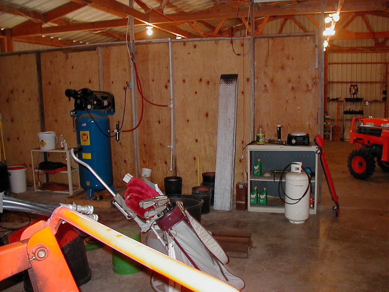

I am generally an Ingersoll-Rand fan when it comes to air tools, but have no experience with their compressors. I only recently learned that Northern Tool was selling the Puma compressors. I did not buy my Puma compressor from Northern Tool. At one time, I'd had a brief repair experience with Industrial Air of Texas and liked them. In December, 1998, they were located on South Cooper Street in Arlington. On 12/9/98, I noticed the Puma showed "6 hp". The salesman said, "We call it an imitation 6 hp." He then showed me one of their own real 5 hp electric motors on an 80 gallon 2 stage compressor and of course it was twice as big as the Puma compressor motor. But he said they had some of the Pumas in shops running all day 5 or 6 days a week and never had a complaint. I'm not sure exactly what the price of the compressor was, but I find in my records that I paid them $617.61 that day, including some fittings, pressure regulator/filter, sales tax, etc. It was a fine compressor and never gave me any trouble at all, but of course, I only had it nearly 4 years. When I had to move back to town, the realtor who sold our place out in the country, bought that compressor from me (he had a ranch in the same county himself).
Now I see, assuming it's the same company, now in Grand Prairie, that they don't list the Puma as one of their brands so perhaps the Ingersoll-Rand is the better choice if you're concerned with parts in the future. Personally, I'd go with the Puma because I like that V-twin design and had such good luck with mine, but I can certainly understand reasons others may make a different choice.

Just a quick question Bird...are those air lines plastic??
if so please beware. a friend of mine had run plastic lines......they exploded. Luckly no one was in the shop at the time. it shattered a window and had embedded shards in the insulation.
i ran mine in copper pipe after i saw the results of his mess.
