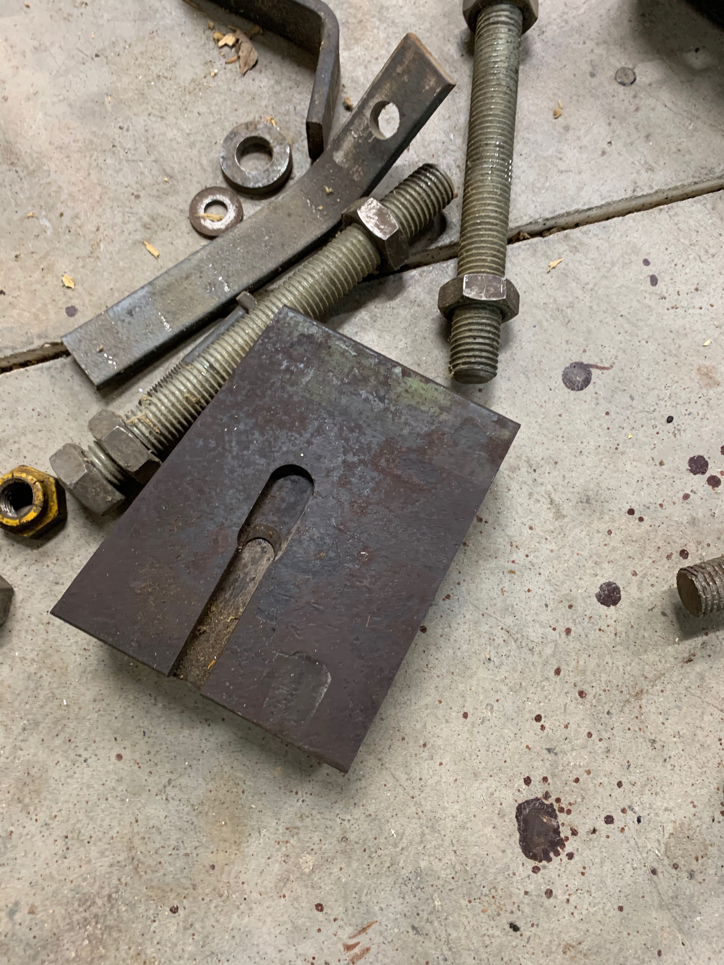

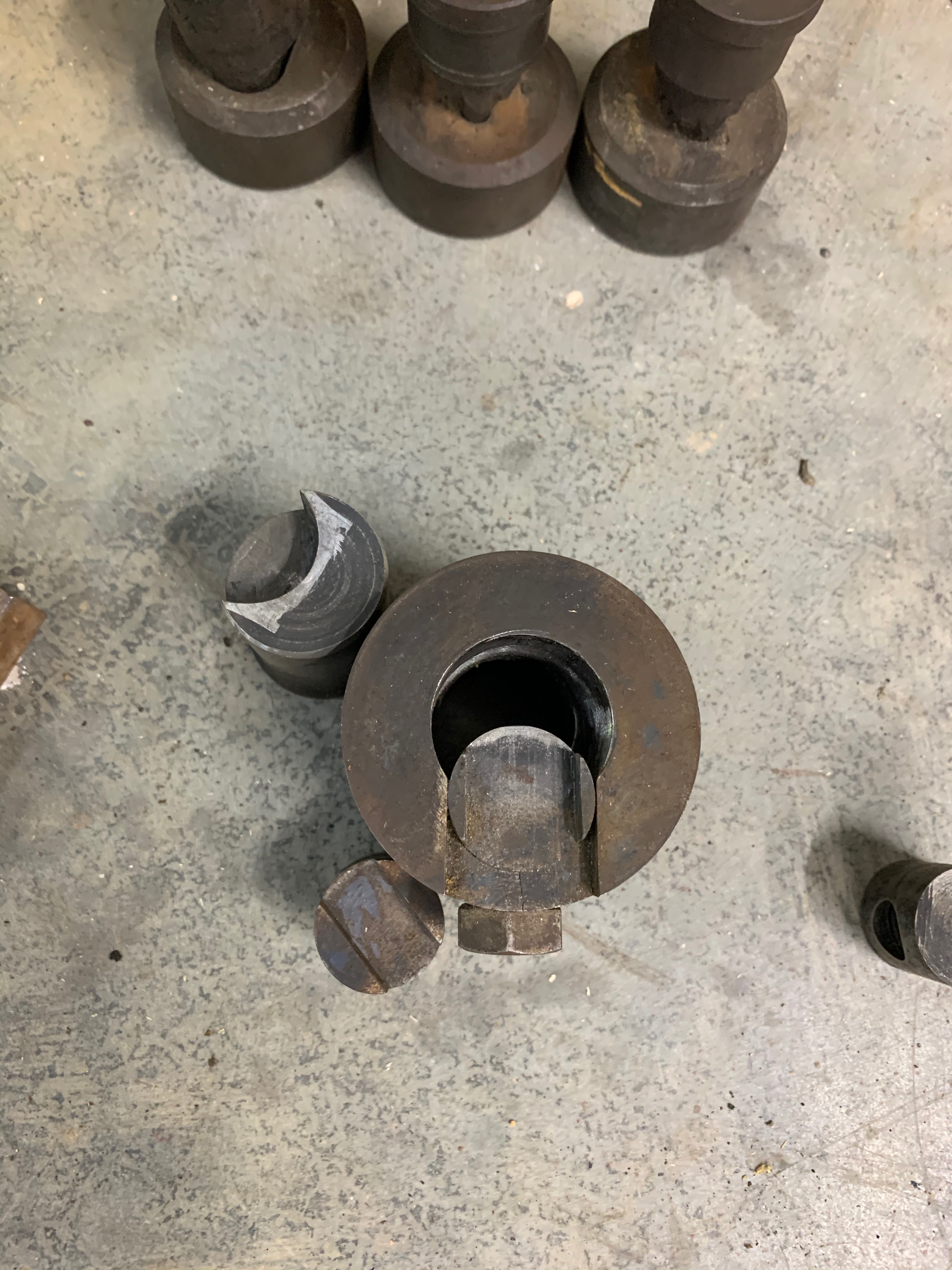

It has the shear and a bunch station and I got a bunch of extra tooling. One piece in particular has me baffled - I will attach the photo of it below. Sort of a half circle. Thing is it is small, maybe ス" - I was thinking a tube notcher but it is too little. Any guess what it is or what I do with it. I have a bunch of the round punches and a few rectangle type (3). I also think I can add a press break very easily and it came with a small version.
Also a T shaped thing - not sure what it is for. Then the big chance of metal with a slot out of it (Thinking it is just a spacer or something that was tossed in the box with the tooling perhaps) Photos - 1 of 6.jpegPhotos - 2 of 6.jpegPhotos - 3 of 6.jpegPhotos - 4 of 6.jpegPhotos - 5 of 6.jpegPhotos - 6 of 6.jpeg

it looks like #2 and #3 are for making c-clips. that's the shape they would make. #4 and #5 look like jigs made for a certain job..

Wondering if the curved die is a corner notcher?
   / Iron Worker/Iron Crafter and machinist type of help #7
We had one of that brand at work, with all the goodies you have you should be able to form and punch for a lot of applications. That special die set looks a lot like a corner cutter we had to uniformly round off plate corners, saved a lot of time on the disc sander.
