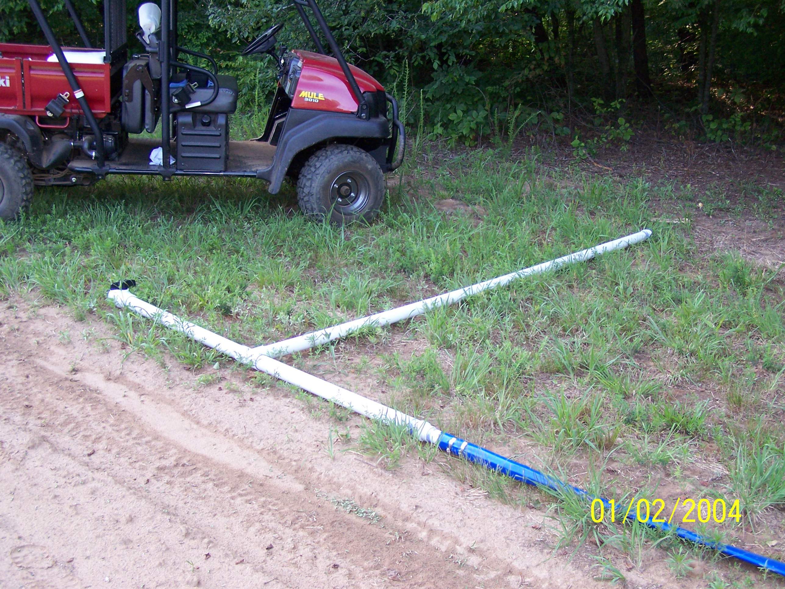

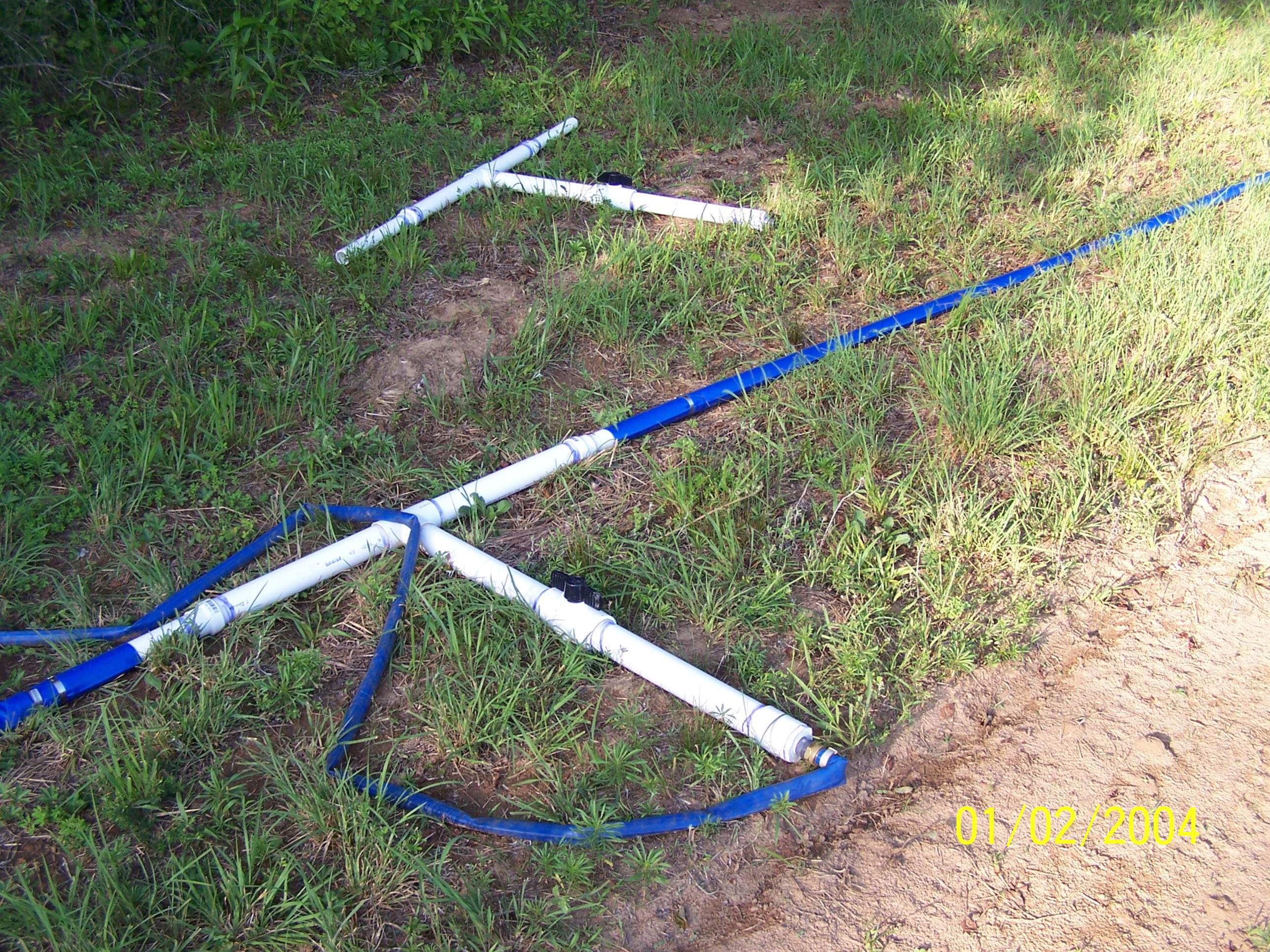

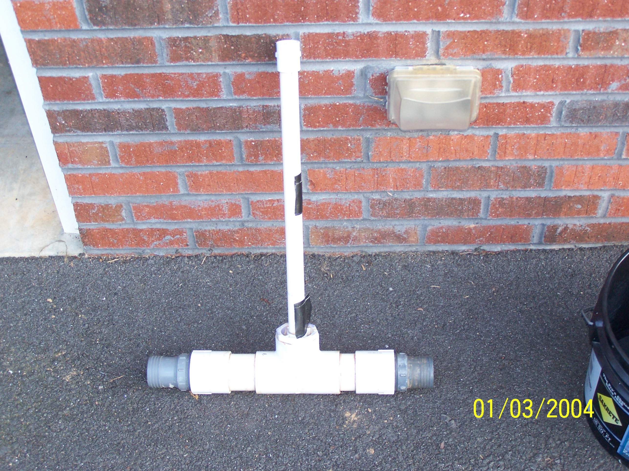

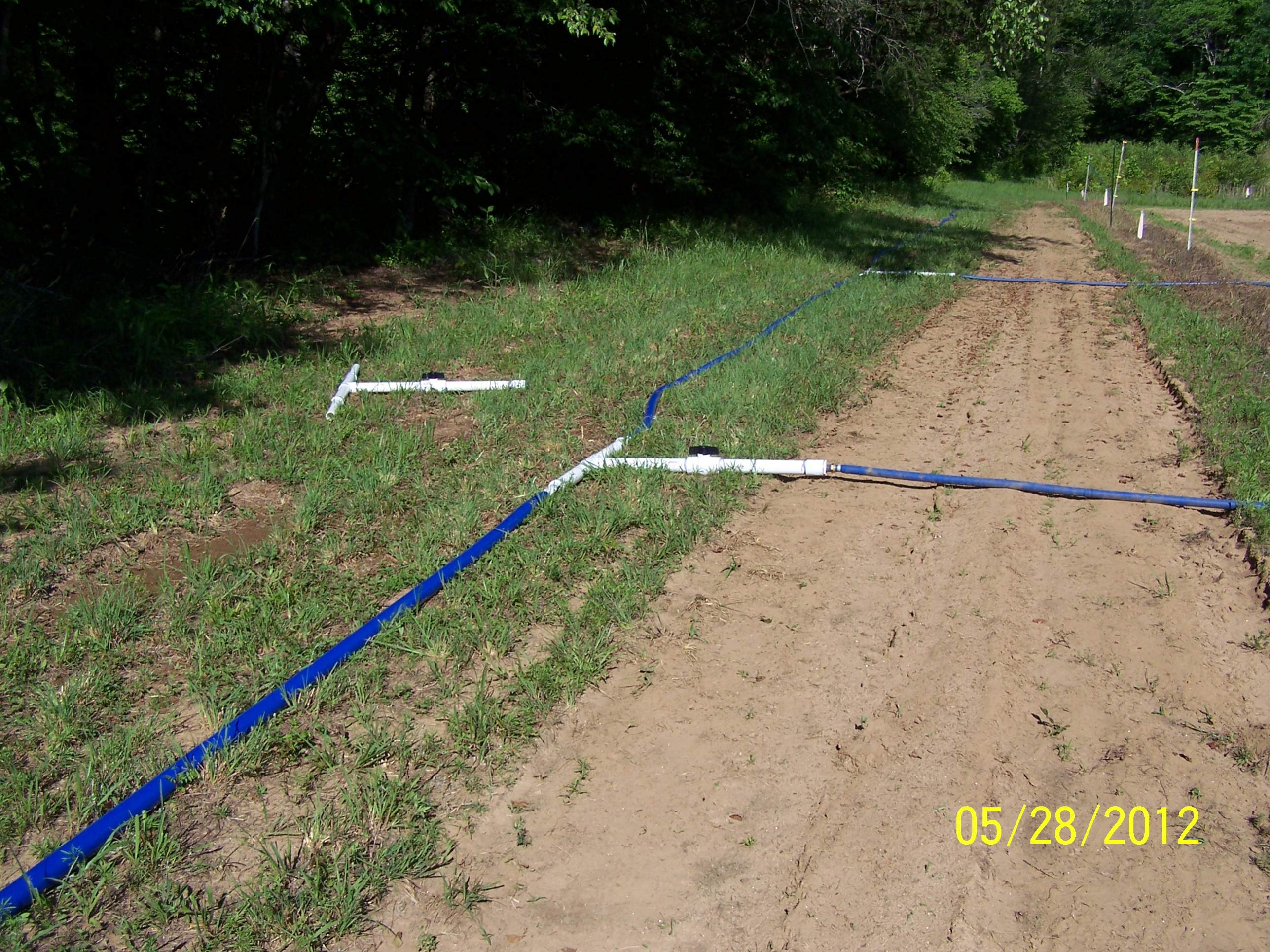

I bought the Red Lion from TSC and irrigate between 2-3 ac. I have an intake filter attached to the pump and have a 15-20 foot rise out of the small river I pump out of. I can run 4-6 sprinklers and a fire hose nozzle at the same time. I use 2" flat hose and "T" off at several locations with cut-offs on each T. This allows me to irrigate different sections of the field. I attached a few photos. !st picture is where I T off coming out of the river. I connect the discharge hose to the PVC. The second picture is one of the in-line sprinkler set ups I use, but most of my sprinklers run off a 5/8 garden hose. I used this system last year and it worked great, however drip tape would be a more efficient way to irrigate. The date on the pictures are wrong as this set up was put together in 2012.
I plan to go with T-tape which is a type of drip irrigation this year or next. Most likely next year since I also want to use plastic mulch with drip irrigation.
