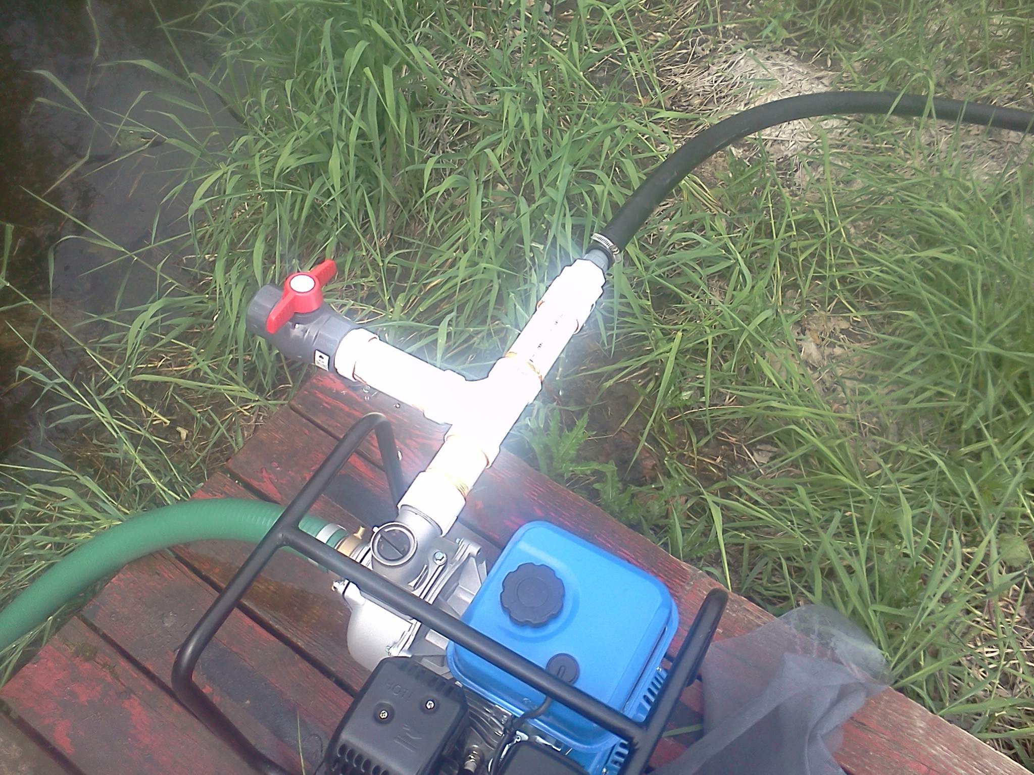

I got the pump running nicely today. Getting a nice 30 ft radius from a groundworks tri pod sprinkler. The key so far is to use a 2 inch valve at the outlet tobleed of pressure before it downot choked down to 1.25 black poly pipe. A total run of 220 feet.
Do you have any pictures of this setup? I'm doing the same thing you are basically and i can get mine pumping right. Are you saying to put a 2" ball valve coming out of the pump then put a reducer to 1.25"? what would be the differance if i just used a reducer and no valve? Thanks!

I think the ball valve is critical. I tried it without it and the pump was dead heading on start up. The valve on the outlet just before the reducer allow u to open it up, then close it depending on your needs. I have found this to work the best. these pumps are not built to build pressure. its kind of a safety release. I will post pics tomorrow.

I dont use any valve on the output side just reducers (my in and out are the same dia.) but I've used other pumps that just wouldnt prime up unless the outflow was temporarily closed off. The old Hale fire pump we had had hand lever you could hold down to temp close off the out port until it primed then just let go to release it. With the hand lever held down you could feel the pressure building up. Need to be careful not to deadhead a running pump that doesnt have a pressure relief or somethings gonna break and hopefully thats just be at a slip on connection. Many times I've seen the poly pipe blow apart from undue pressure buildup where they have been clamped together.
   / Irrigating garden with trash pump supplied by creek?
#20
This is my set up. A 2 inch ball valve is just before the 1.25 reducer that is connected to 100 ft of poly pipe.
