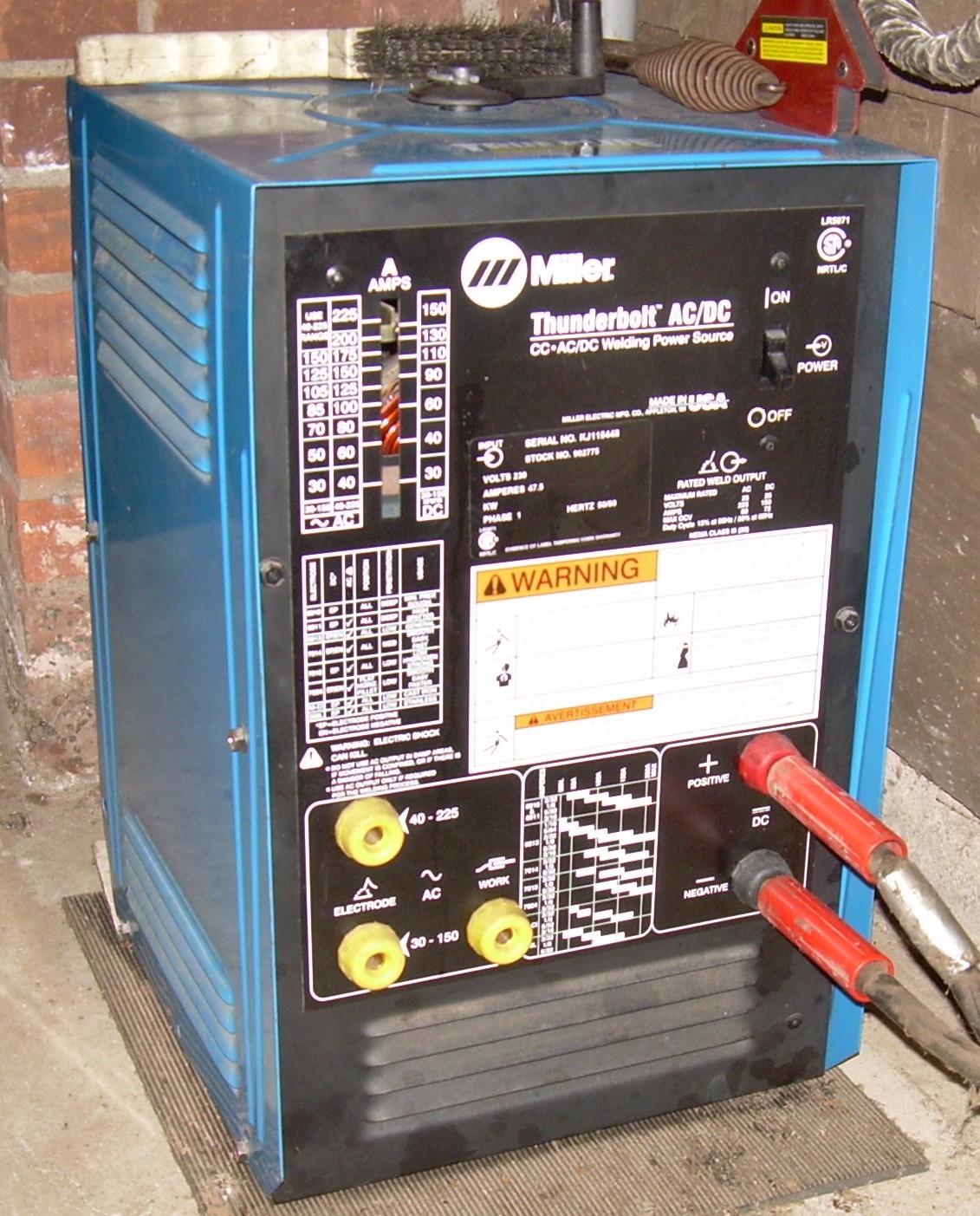

i would get a thunderbolt acdc .the infinite adjustment and 150 amp dc makes it better. 1/8 7018 sometime needs more juice than 125.it can be run on a 50 amp breaker.bigger transformer welders use more power at the same amp settings.if you have a 100 amp breaker i have used a dial arc,ideal arc and esab 252 and they are superior machines.for a farm welder not necessary.i have a 140 amp everlast inverter and have used several miller inverters,i like the way they weld but if i had only one welder for farm use {50 amp breaker } it would be a acdc thunderbolt .
That's what I have, couldn't be better suited to my needs so far.
Got it real cheap, in what looked like brand new condition at the time.

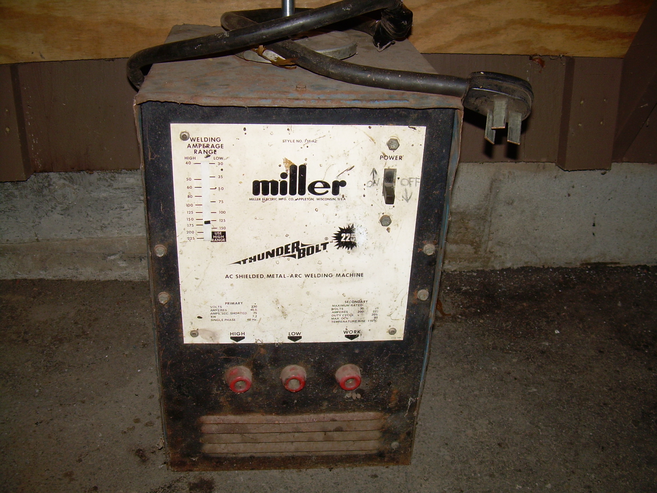

Had the ac only version for 30 years, I literally found it on the side of the road in a pile a rubbish, hope the ac/dc lasts half as long.
JB.
the old and the new
