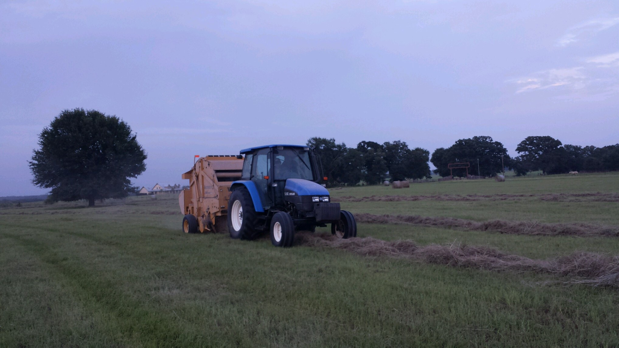

image.jpg mine doesn't have a loader but I like the way the 2wd rides over my 4wds. Not really fair comparison cause the frame is longer,25 more HP and it weighs about 3,000 more. If I had one tractor with loader I would have to pick the 4wd around 80hp.
Just haying and loading hay etc. 2wd will be fine just put some weight in the rear end,fluid in tires or weights but for all around tractor doing loader work around the place I would won't the 4wd.
I wouldn't be in my hay fields if it was wet I hope but I baled at my in-laws with my Kubota and the hills were pretty steep and I had use 4wd cause the sandy soil. I don't know what it's like in UK sorry,hard for me to say really on the 2wd for you but you wouldn't have to worry and later if needed to sell it the 4wd would possible look better to others around you.

<img src="http://www.tractorbynet.com/forums/files/buying-pricing-comparisons/443302-2wd-ok-bale-image-jpg"/> mine doesn't have a loader but I like the way the 2wd rides over my 4wds. Not really fair comparison cause the frame is longer,25 more HP and it weighs about 3,000 more. If I had one tractor with loader I would have to pick the 4wd around 80hp.
What NH is that? Looks just like the one I'm looking at getting
   / Is 2wd ok to bale with? #19
2004 TL100
