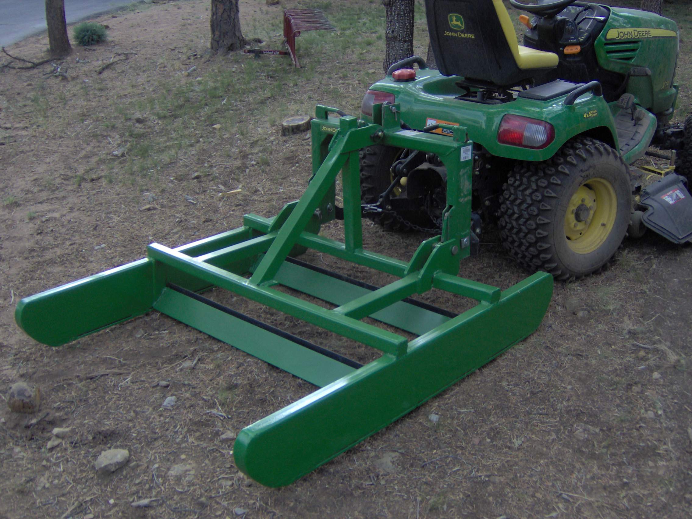

   / Is 3x3x3/8 angle ok for grader/plane build? #4

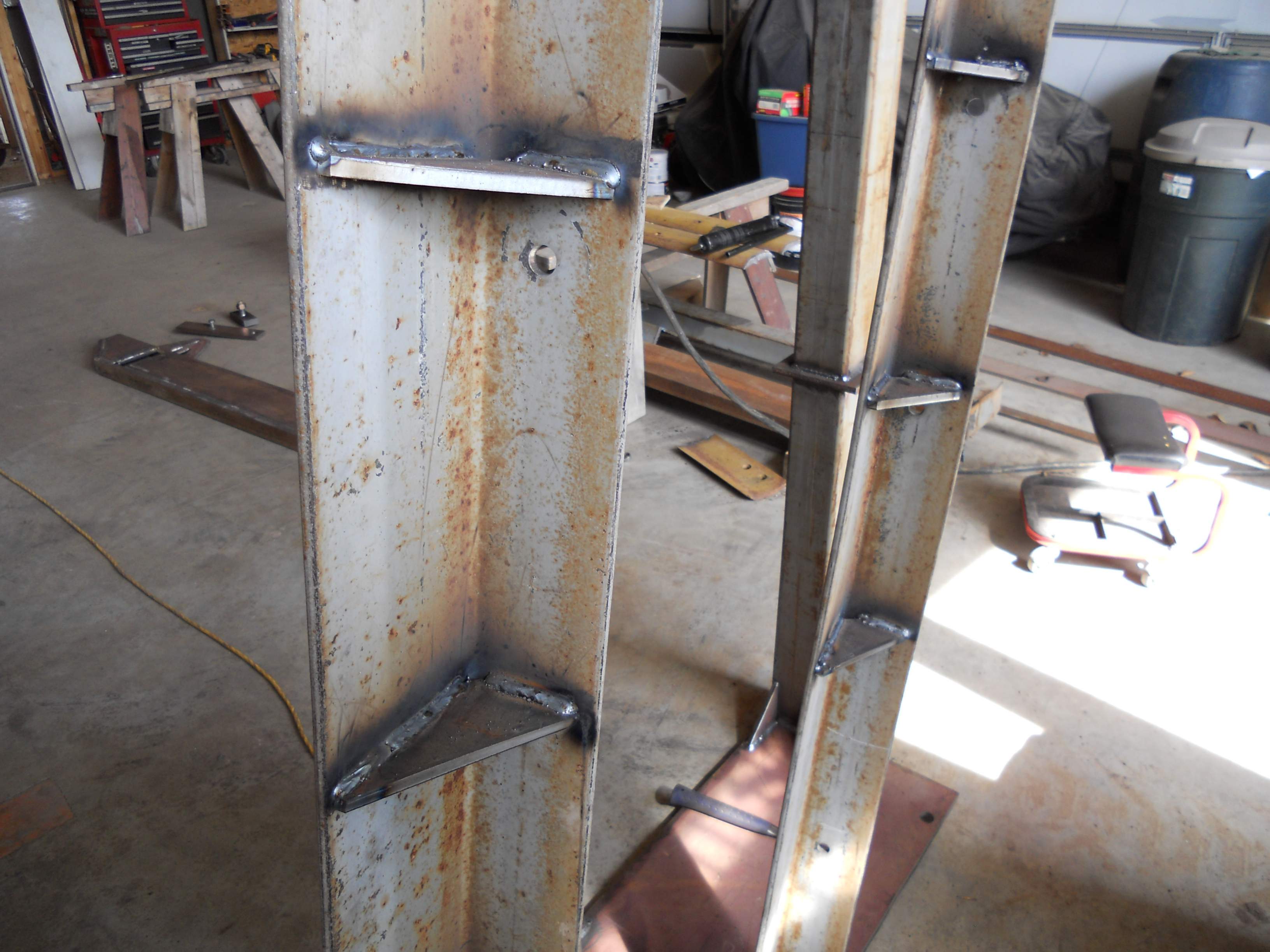

I used 4x6x3/8 with triangular "gussets" welded in underneith every 2' or so. I may have overbuilt it but my concern was that the grader blade bolted to is would prolly not put up with much flex before it cracked. The 4x6 also sets up a good blade angle.

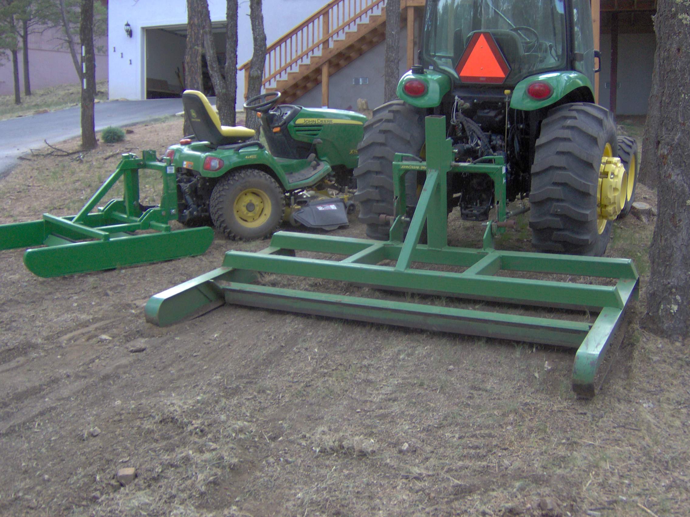

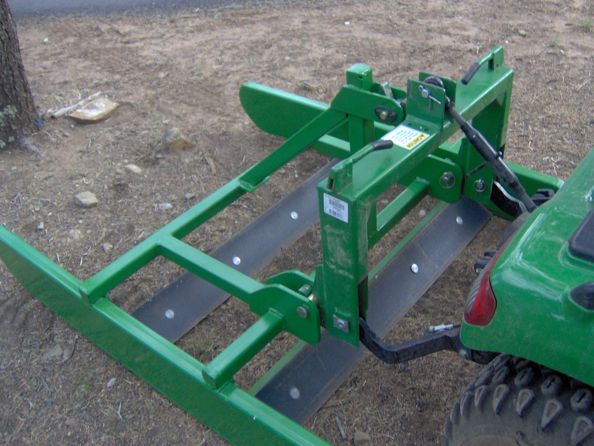

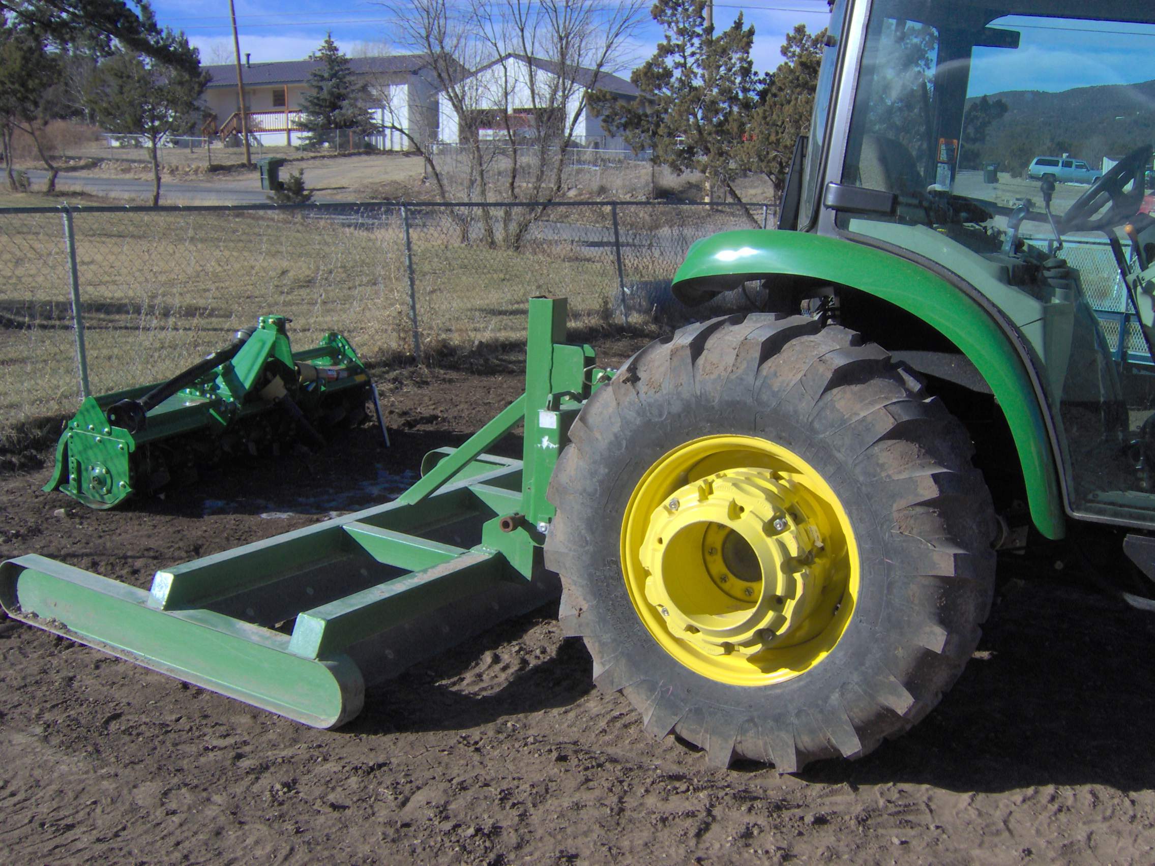

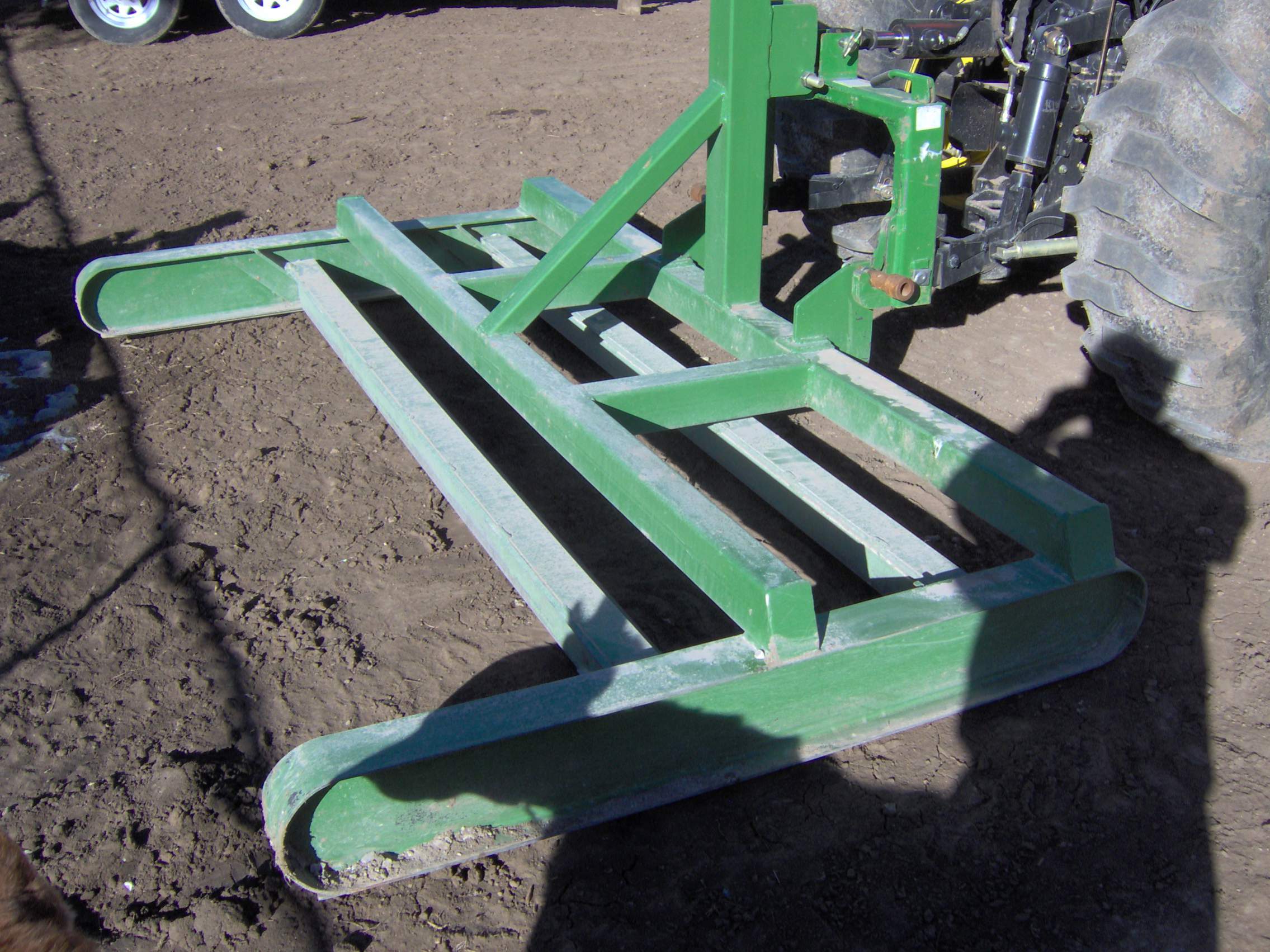

   / Is 3x3x3/8 angle ok for grader/plane build? #5
When I built my first landplane I had some 3x3x3/8 angle to work with and used it with flatbar to make my blade carriers. So I have a piece of 5/8" x8" flatbar on a 45 degree angle with a piece of the 3" angle on the top boxed in and a second piece on the bottom (rear) just above the bolt holes.
On my second build I planned a little better and used 4x4x1/2 for the blade carriers and box tubing with a heavy wear strip to make the skids. I can tell you this much the 4x4 is easier fit the blades to than a 3x3.
Here's the pics of the two I built.
