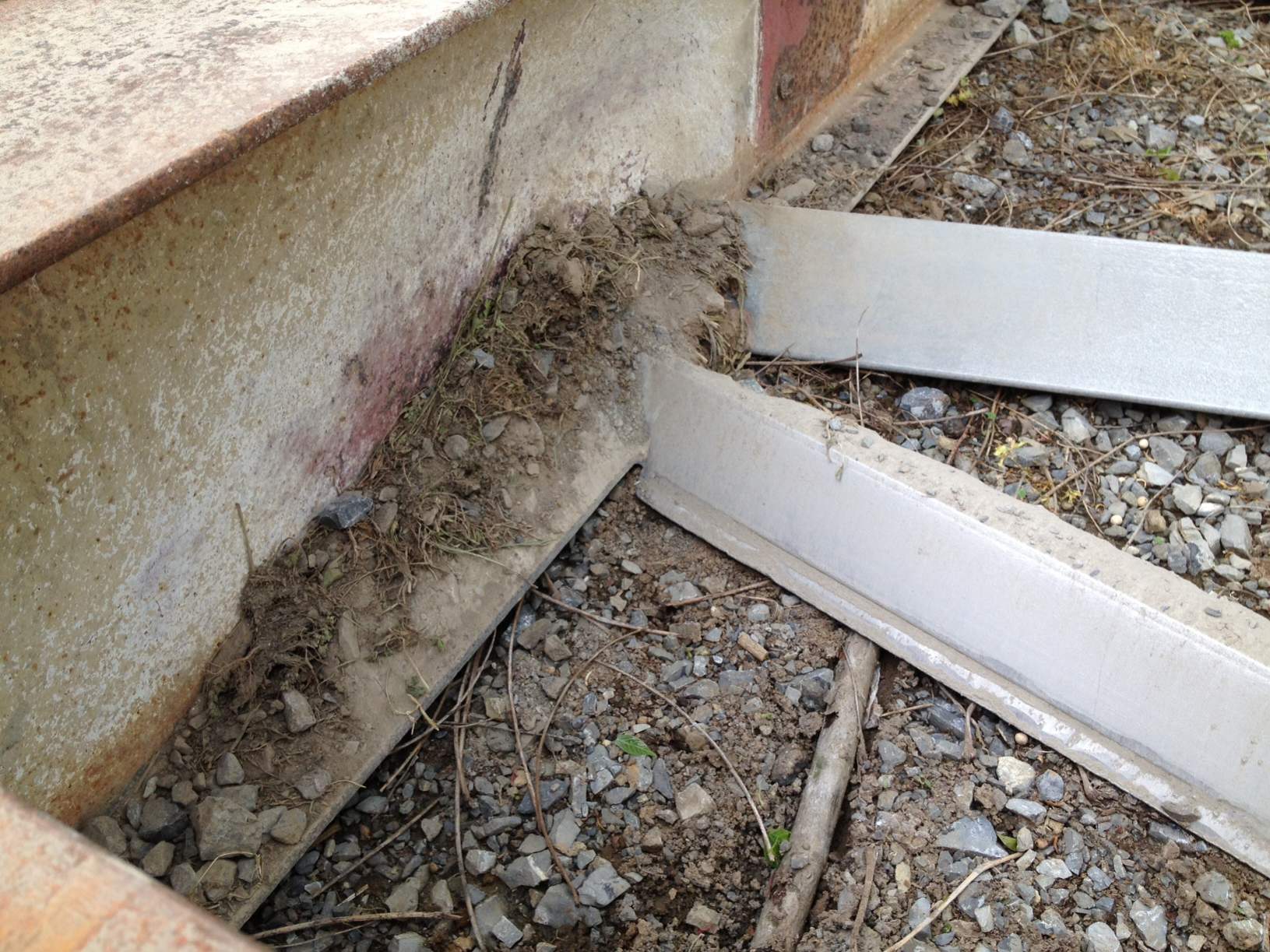

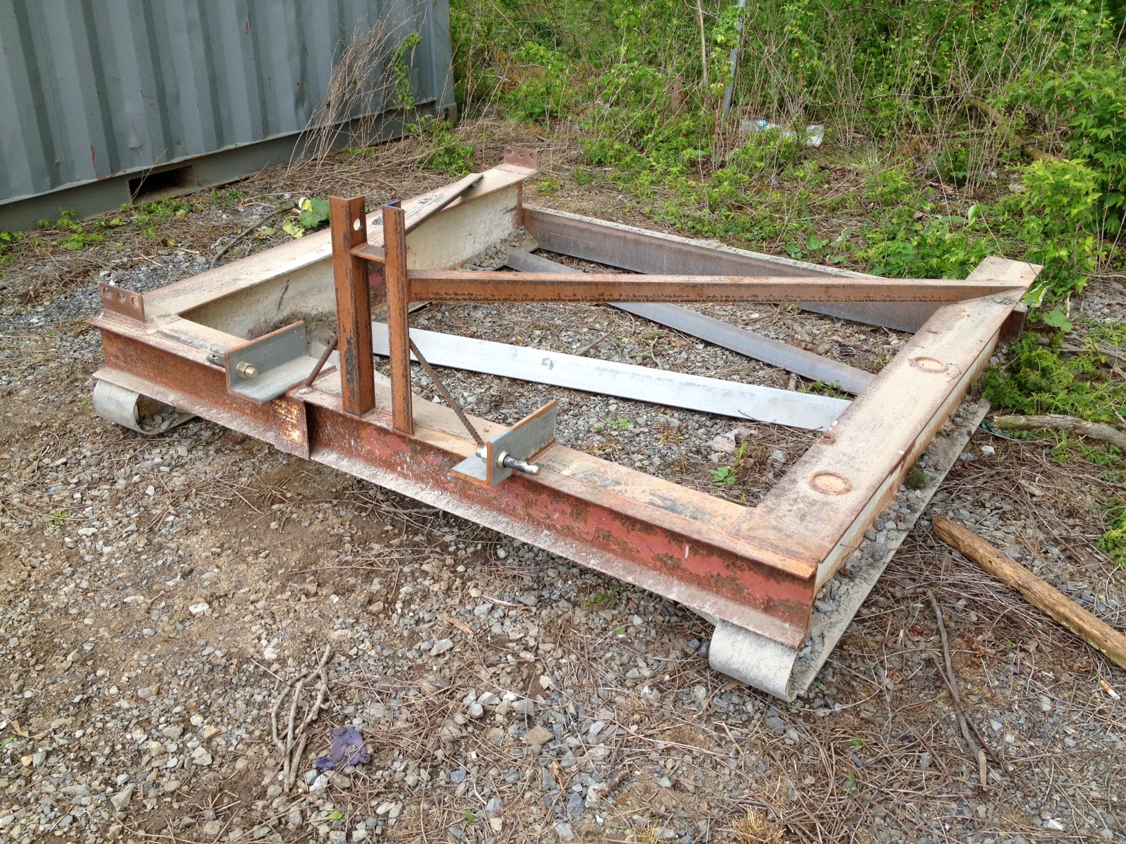

Here are a couple pics of one I had made up at work. We have quite a bit of gravel for parking and storage areas. The gravel gets beat up with yard lifts so we needed something to smooth things out. The homebrew landplane is made of two hefty pieces of I-Beam and 3x3x3/8 angle for blades and a couple pieces of scrap channel to reinforce the front and rear. The front piece of angle has a flat piece of 1/2" stainless flatbar stitched onto the bottom. The leading edge of the stainless was trimmed at about 45 degrees to make sure it would cut. The front angle/flatbar was welded into place so it was angled forward with the leading edge about 3/4" below the bottom plane of the beams. To make shoes for the front, we split a piece of schedule 40 pipe in half and welded one piece to the front of each beam. It works so well I can stick anyone on the tractor and they get the place looking great in short order.

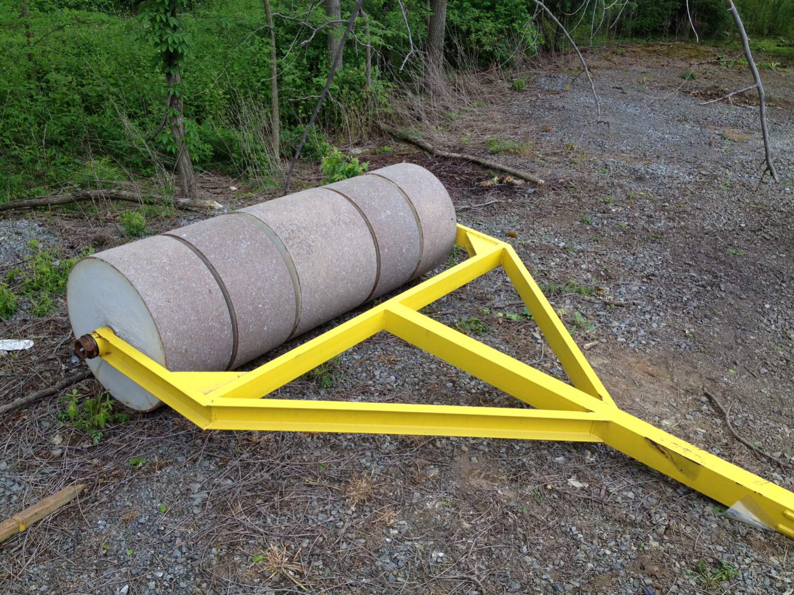

When the material looks nice and flat, we then run over it with our homebrew roller. I used 24" schedule 40 pipe sliced into four 12" and one 18" pieces. Each piece was cast full of concrete with a 2-1/2" pipe in the center for the axle. The 2-1/2" pipe has a few "spokes" to tie everything together. I did this in lieu of making it one solid cylinder to avoid most of the skidding I anticipated at sharper turns. Each piece of the roller can spin at its own speed since they have a piece of 2" pipe running through them. The width came out to roughly 5-1/2 feet.
