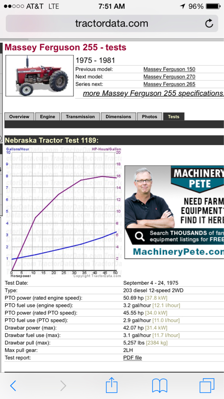

Example: My 5075E is sold as a 75hp tractor (engine, under who knows what ideal test conditions) , but put that engine in the tractor and it can only deliver about 64 hp to the pto (and I assume the tires too) according to Nebraska tests.
Not necessarily on the drawbar hp. Your specific tractor wasn't tested for drawbar but I have one that I know was. Here's a screen shot.
Massey Ferguson 255 50 pto hp and 42 drawbar hp. Engine wasn't tested. But I believe you will find there is almost as much power loss from drawbar to PTO as there is PTO to engine.

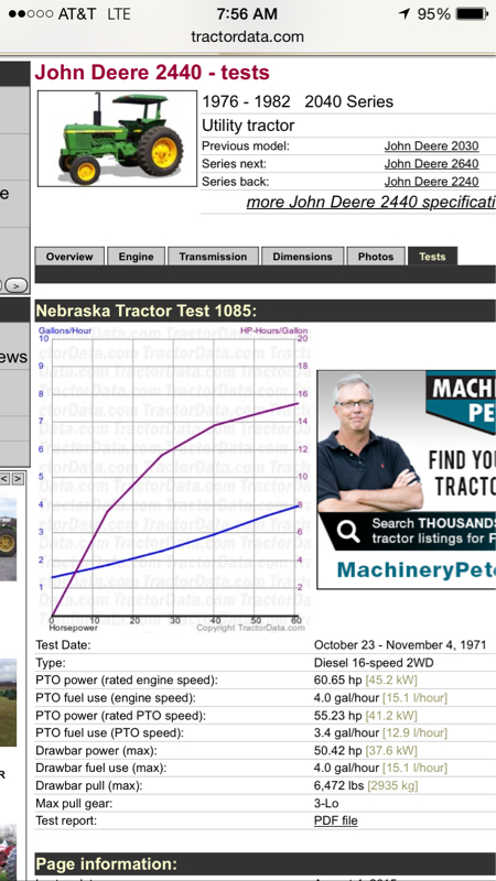

   / Is 50 HP really 50 HP? #24
Another example of drawbar being less than PTO.
Sorry only one picture per post.
Drawbar HP is always much less than PTO or Engine HP. It is the final result of pulling power put to the ground from the engine which takes into account tractor weight and all the power losses from engine to tires on the ground.
Comparing CUT Drawbar HP to Utility farm tractor DB HP would be like comparing the HP of a rail dragster to a tractor. A 2000+ HP dragster couldn't leave the starting gate if attached to a 40 HP CUT, there just isn't enough traction in the light frame of a dragster to put all that HP to use as a pulling machine.
