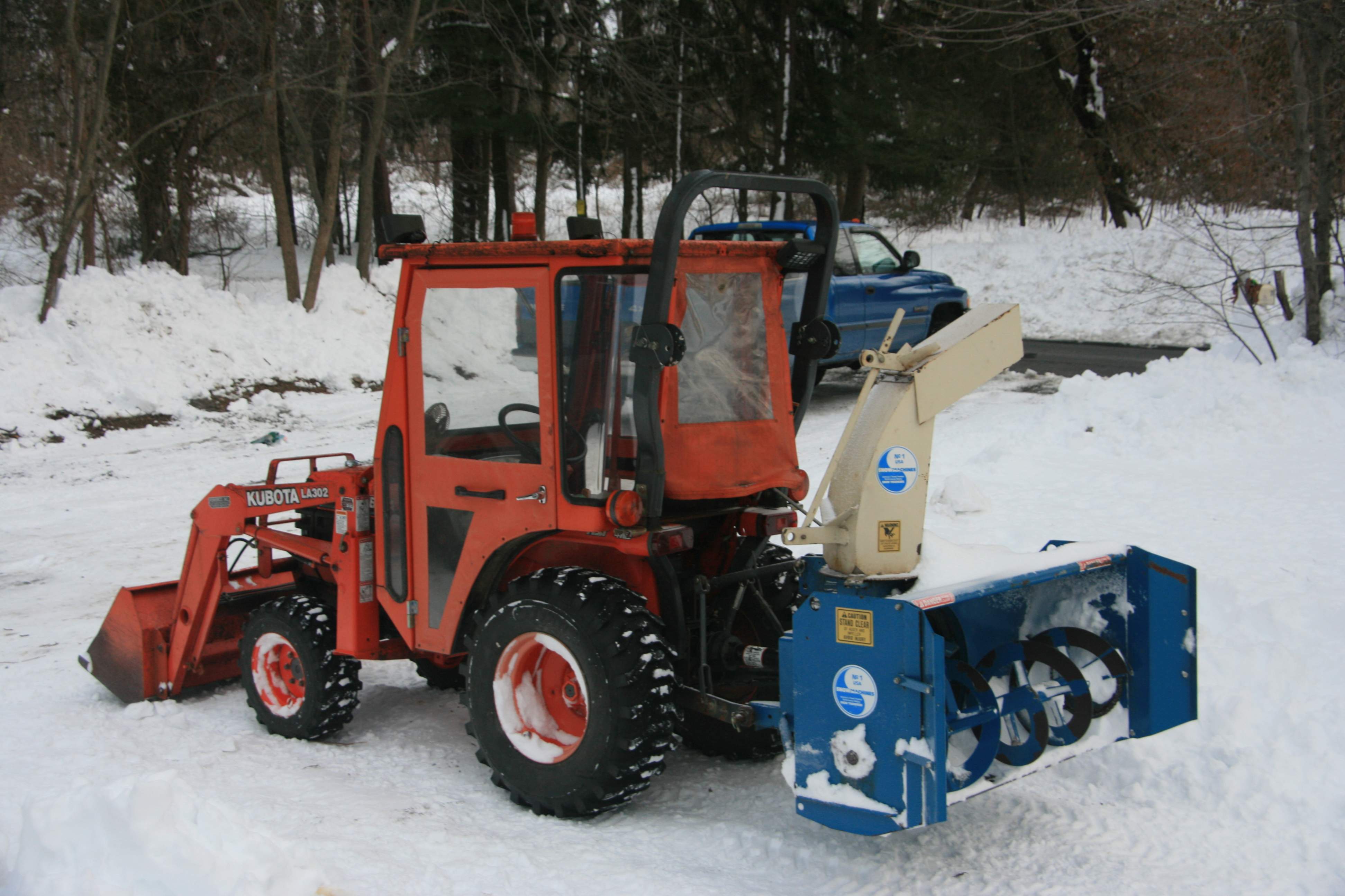

I run a Buhler / Farm King 60" behind my B2620 (26 engine HP and 19 pto / hst transmission)
Works really well.
Issue is weight of tractor and lift capacity of 3pt hitch. Blower weighs 500 pounds and spec. from Buhler says 20 - 40 HP tractor rewquired. Never had a HP issue with my 60". Farm King - Snowblower
I run about 1700 rpm most of the time in low with HST pushed to the floor boards. I could run in 2nd as well but since driveway is 1/2 mile of gravel slower lets me adjust before shat hits the fan...
I blow at my cabin so often do not get to keep up with regular blowing but rather 1 or 2 times per year. Snow here is fairly dry and maybe 12" average when I blow.

Ductape--I measured the outside of rear tire width at 54". There is no substitute for horsepower, unless you don't have enough, which I realize my B21 has only 21 at the crank. One dealer told me, " A 60"unit with only 14 PTO hp? NO WAY!" My B21 turns a 54" rotovator fine, just slower ground speed.The HST is a great equalizer and we all should agree any tractor can be humbled by too large an implement. IMHO, my B21 would handle a 60" 3pt 2 stage SB. I will email Kubota and get their opinion. Thanx for your thoughts.Regards--Tinman236

Based on my experience with a local Kubota rep they will tell you the 60" blower is too much. They told me the 72" on an L3130 would be too much even though the earlier attachment list had it as an option. Later documents recommended units that were narrower than the tire width. (That will never work favorably). Having a wider blower is beneficial when making turns and getting under mail boxes.
In real life I couldn't be happier with a wider than recommend blower. I simply slow down a bit, but most of the time I'm in Medium and regulate from there.
What's the worse case if you buy a 60"? If the snow is too deep/wet for the blower you can always use the front end loader. Go for the 60" and don't look back!!!
As others recommended, make certain the weight doesn't exceed the 3-pt lift capacity.
Good luck

I have a B7500 HST that I run a Snowmachine's model 300E 60" blower. It easily handled the recent Nor'Easter here in NH with a 26-30" snow cover. Get the 60" blower, move slowly if necessary, and enjoy. A cab is a must, unless you want to look like Frosty the Snowman! :)

my yardsite is flat and realy for me the 60" works perfectly fine. Tires are not loaded and I sometimes wish the tractor was heavier to help with the steering. In those cases when I feel I can not turn into a pile or direction as strongly as I wish I simply let out a little sigh, pull forward, correct the angle and go at it again. Straight line mid rpm in 12" of snow is a no issue. and engine has never showed any signs of bogging.
I also have the upgraded 4 blade fan that takes a litle more to turn than the 3 blade version, chute is manual, no cab on the tractor so like another member says I come out after a few hours of blowing looking like frosty the snowman. Snomo helmut and suit is all the protection I have and at -20 it is enough but not luxery thats for sure.
